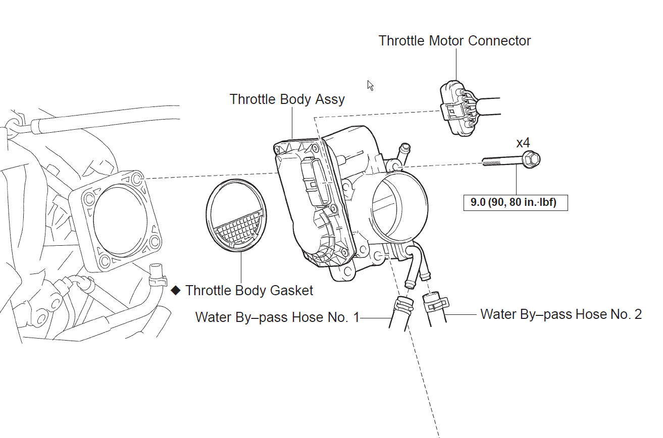

Can anyone shed some light on how to remove the throttle body on a 2.0 VVTi petrol engine?
I've removed the air intake etc and the four long bolts holding it on, but it still appears to be attached somehow.

Hi mate,
all should be revealed in a picture of the throttle body (attached) it shows just 4 bolts as you say. I tried to attach a full .pdf of the complete fuel system but as it was just over 2 meg the forum would not permit that file size, I could email it to you later if you PM me.
Regards Pete.

Hi mate,
Regards Pete.
That's great! Thanks for that. Guess I just need to 'persuade' it off then :thumbsup:
I'll PM you my e-mail address now.
