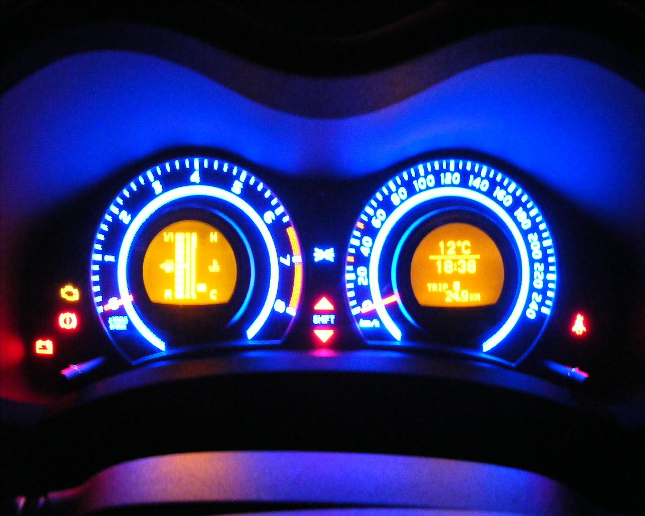

Finally, to replace the dash lighting the bulbs you need are 3020 surface mount LED's. Also known as PLCC-2 SMD's. Make sure you buy good quality, or else the bulb will be greatly underpowered and look rubbish, not giving off enough light! I've been looking at it, and getting ready to do this to mine, but am a bit reluctant as its had the dashboard replaced twice under warranty already and its only 3yrs old! :-S

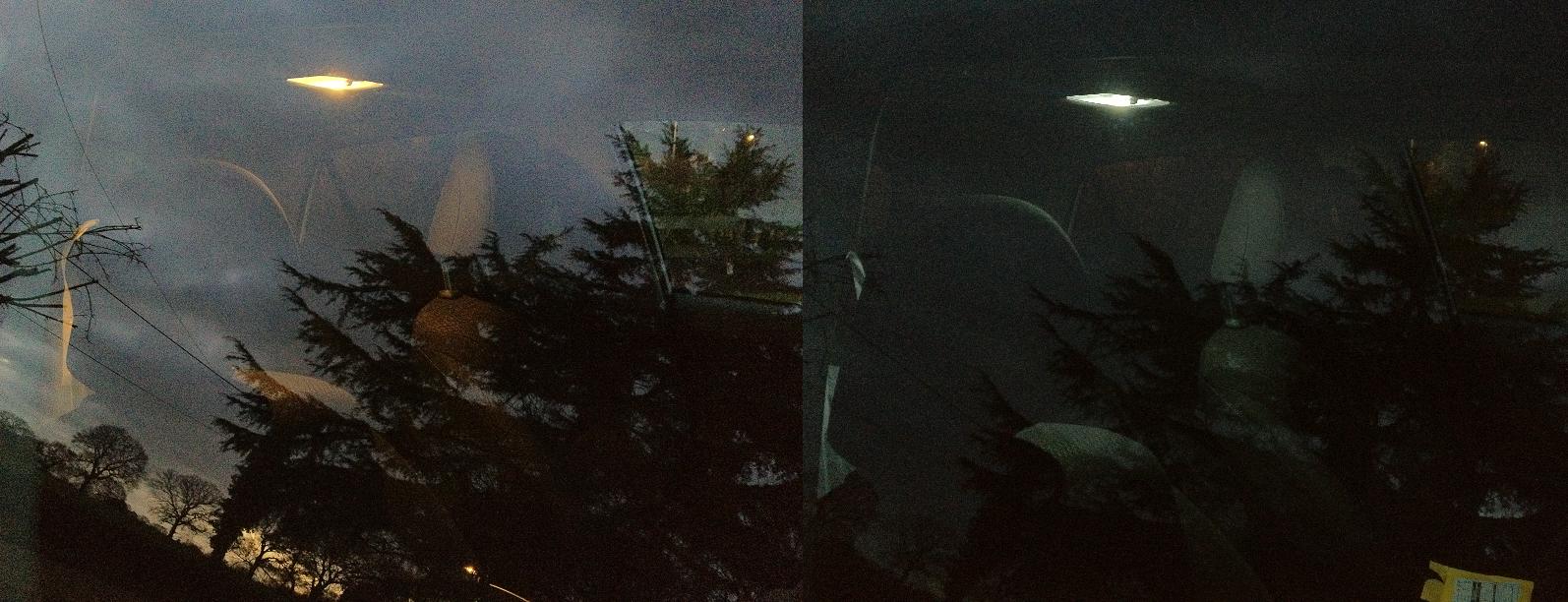

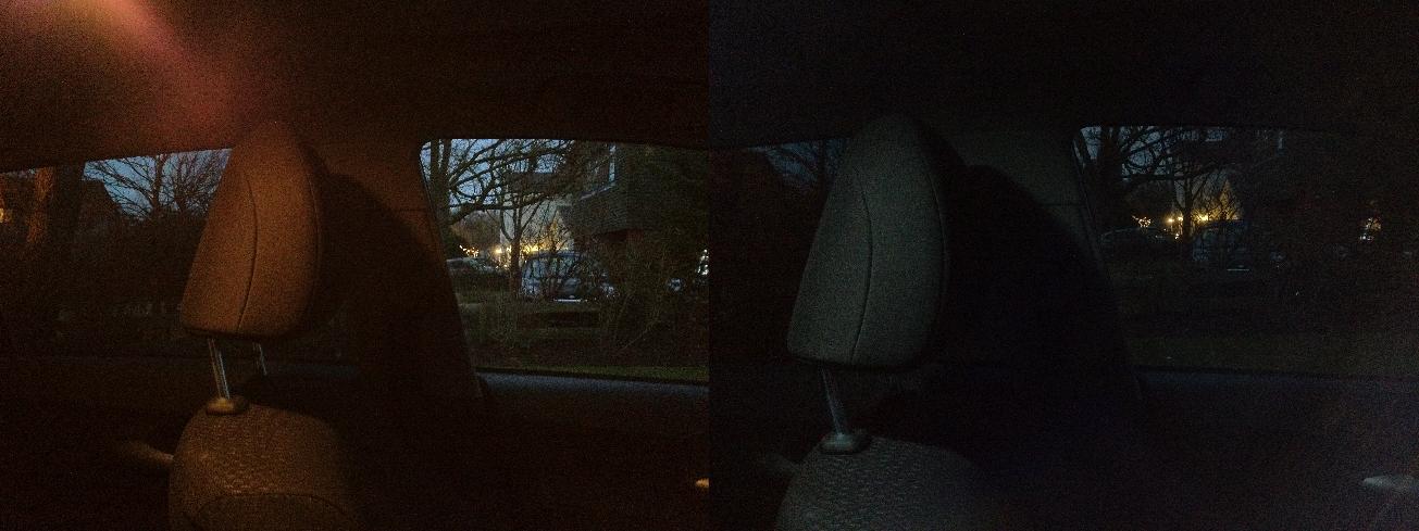

And so I did. Appologies for image quality, it's also a bit lighter in the old bulb side of the pics, I couldn't wait for the dark to fit them!
post-102577-0-61640700-1325159497_thumb.
post-102577-0-50347300-1325159507_thumb.
When it was completey dark, the light in the car was noticably different, it looks cooler anyway.

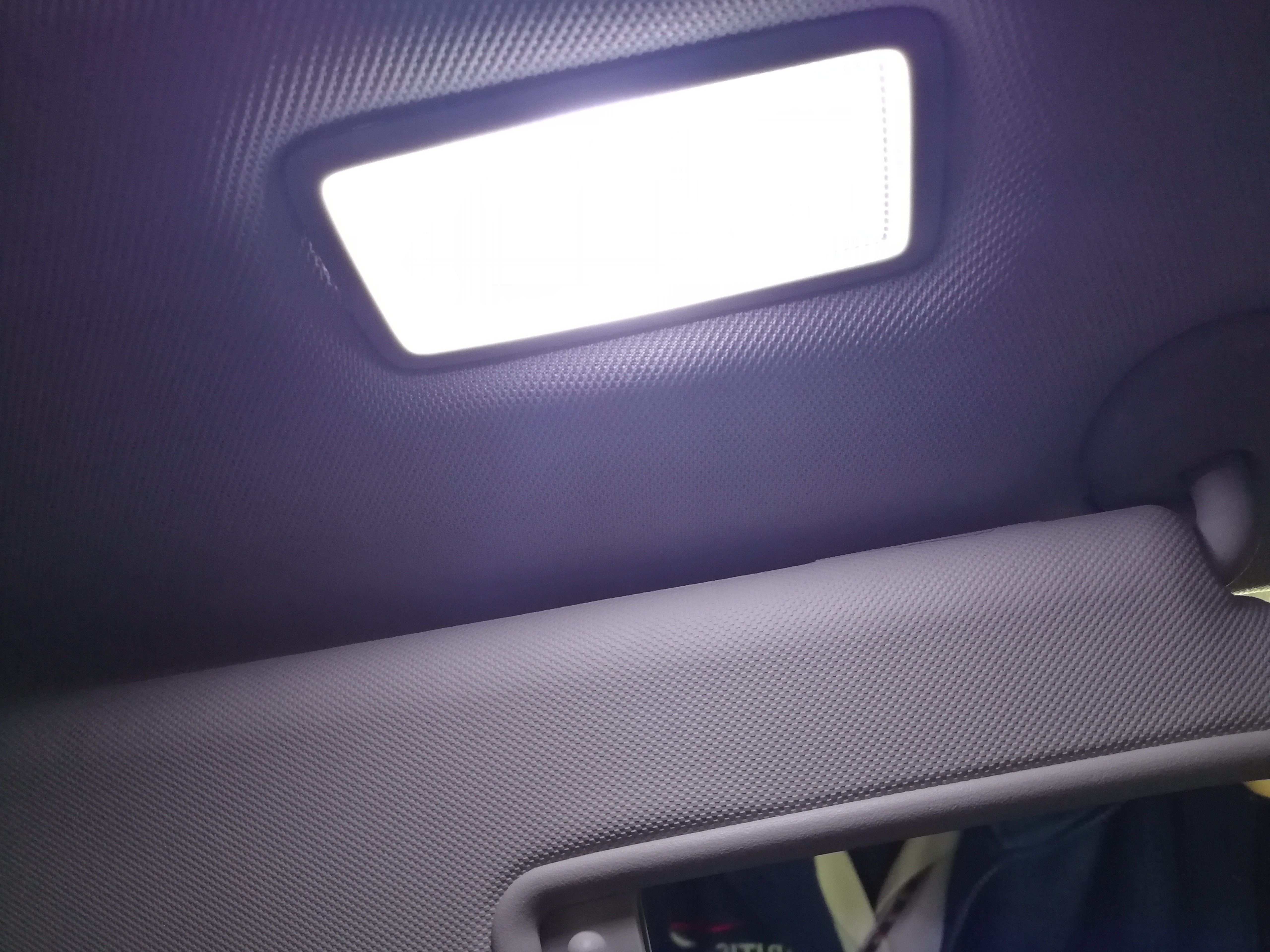

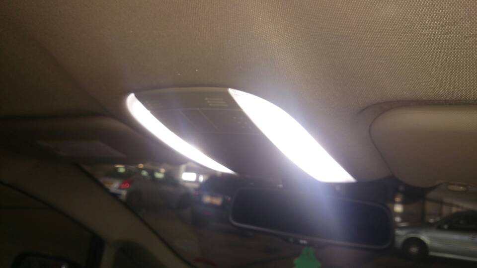

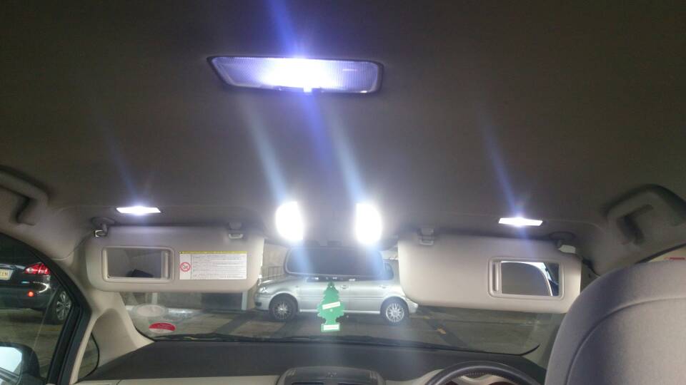

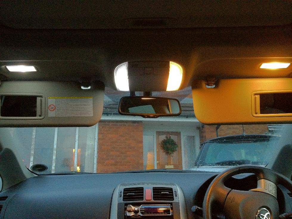

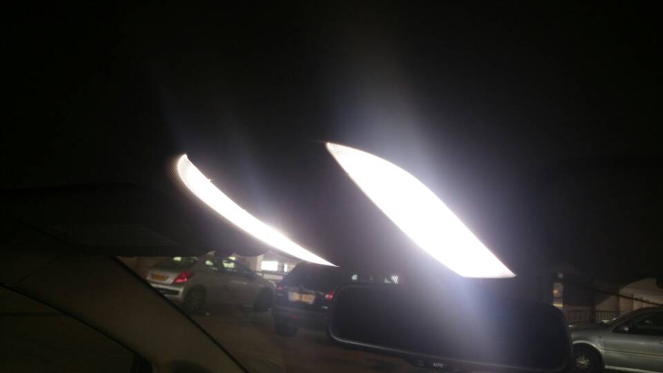

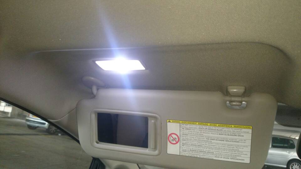

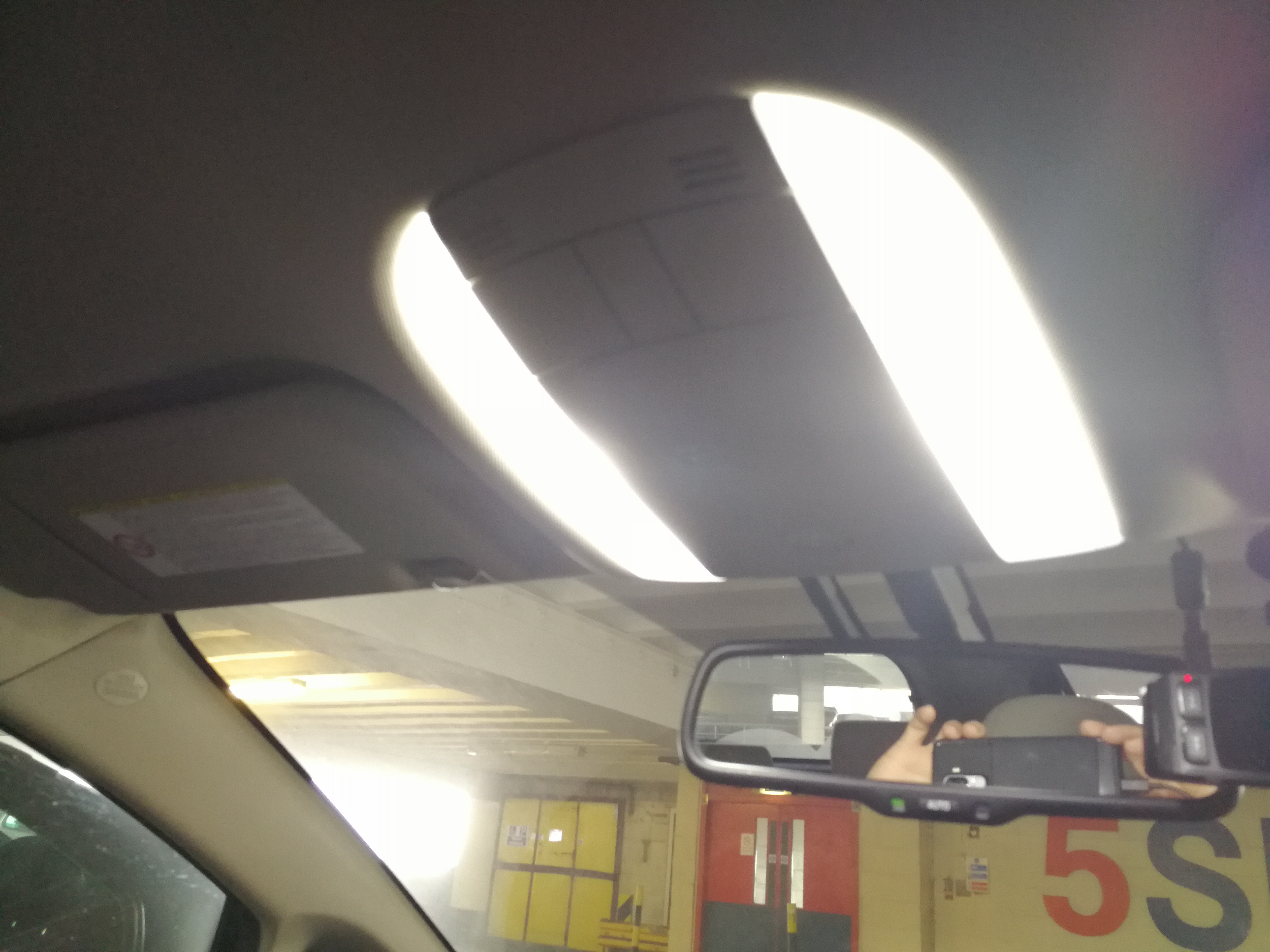

Here are some pics of the interior lights. Let me know if there's any the no specific you wanna see and I'll get them when I can.
As you can tell the centre light is Cool White(6000k). Only one I had laying around. I have ordered a new brighter white(5000k) to replace it.
I uploaded these using my phone and the app, hope they are viewable.....
How easy are the vanity lights and also what bulb did they take
Real easy. Just gotta make sure the led bulbs aren't too long.... Give me a few hours and I'll pop to car and get some install pics for ya.....
They take standard w5w wedge bulbs

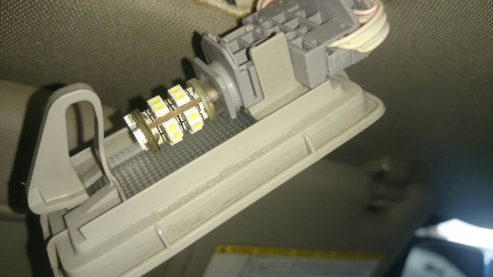

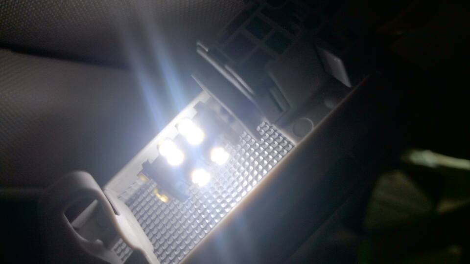

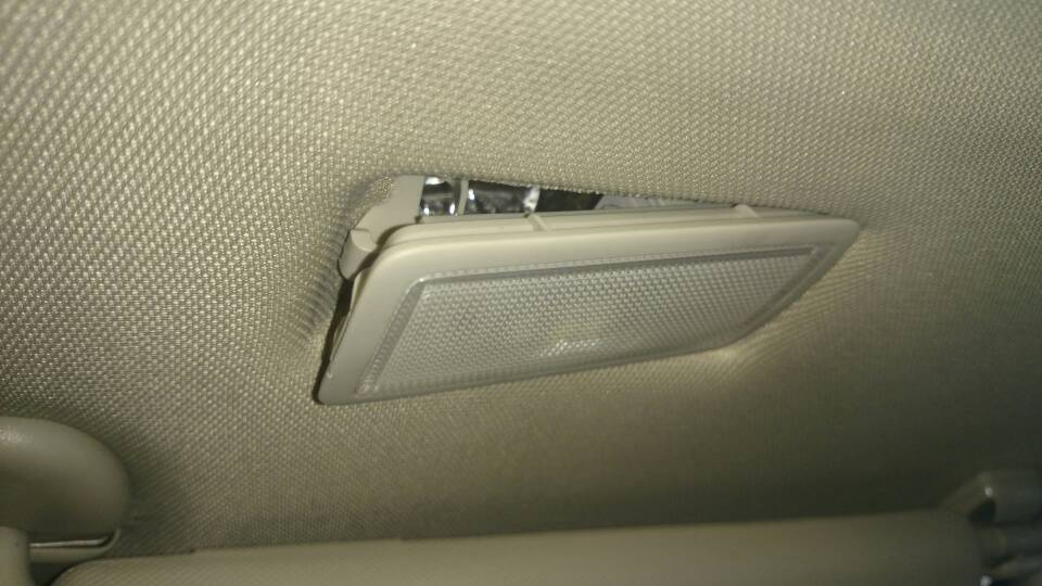

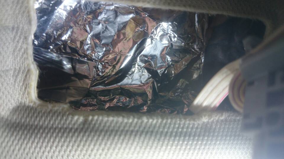

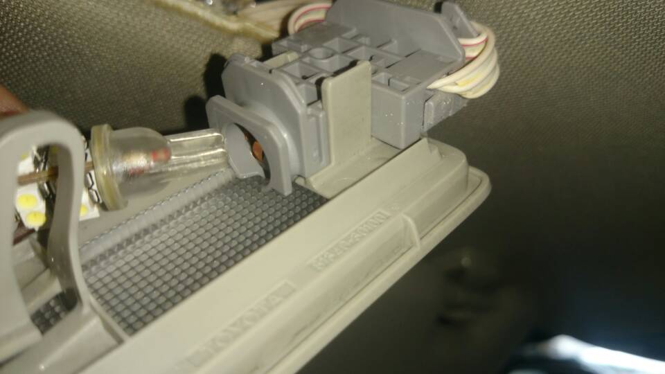

OK. Had time to do it now.
Just carefully pry from the left of the light and pull down. Then pull out the wedge bulb. Easy

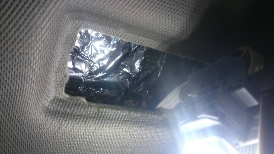

As a bonus measure for more light, I put foil behind all the light bulbs to reflect any lost light back into car. I have done this on all my interior lights. Every little helps.....
Ideal so takes seconds ... Love the foil idea will get all over that
