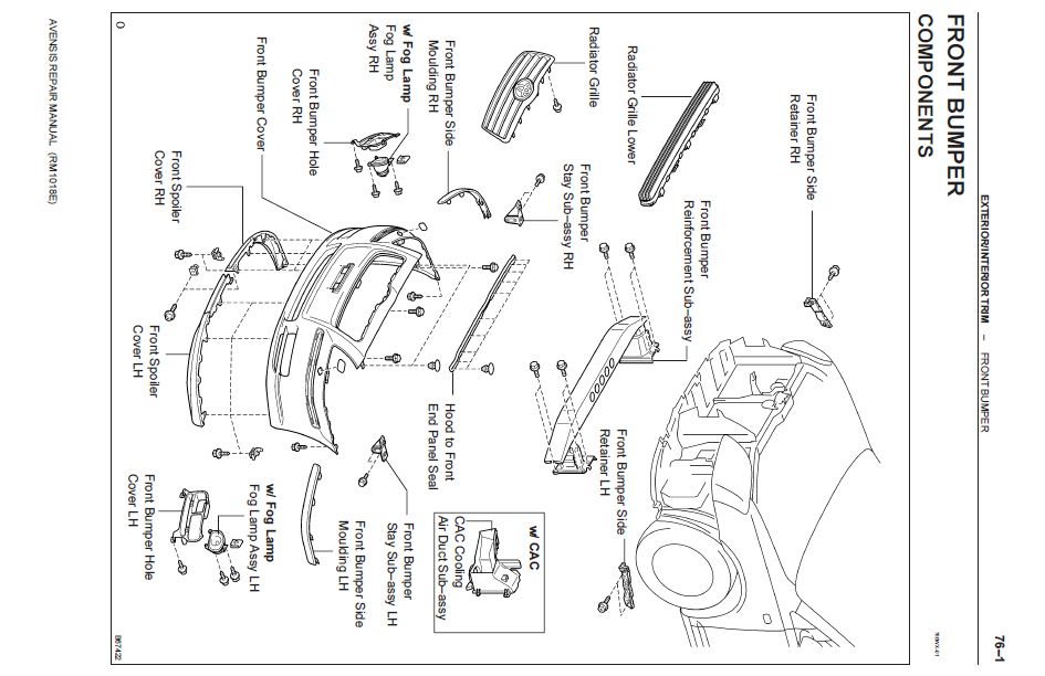

Hi Dave here's a diagram for you.
Pete.
Pete.
Cheers Pete, that will be of great help.
Thank you
Dave
