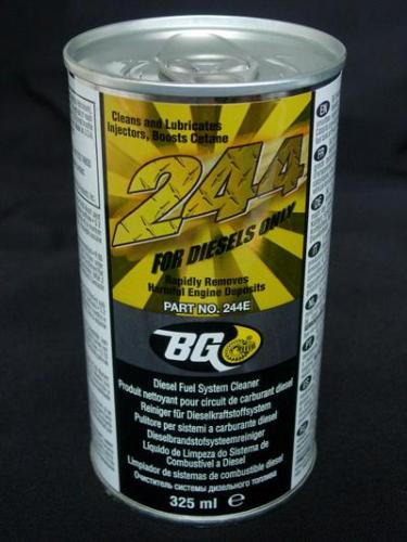

give it the bg244 treatment... you could have a dirty injector like i had in a d4d hiace engine light would come on and go into limp mode.. cost me big money to get them taken out and tested and cleaned 800euro if i knew of bg244 it would have saved me a lot of money.. d4d's do not like dirty diesel keep them clean every 10k with bg244.........
post-108511-0-36574000-1304864656_thumb.
