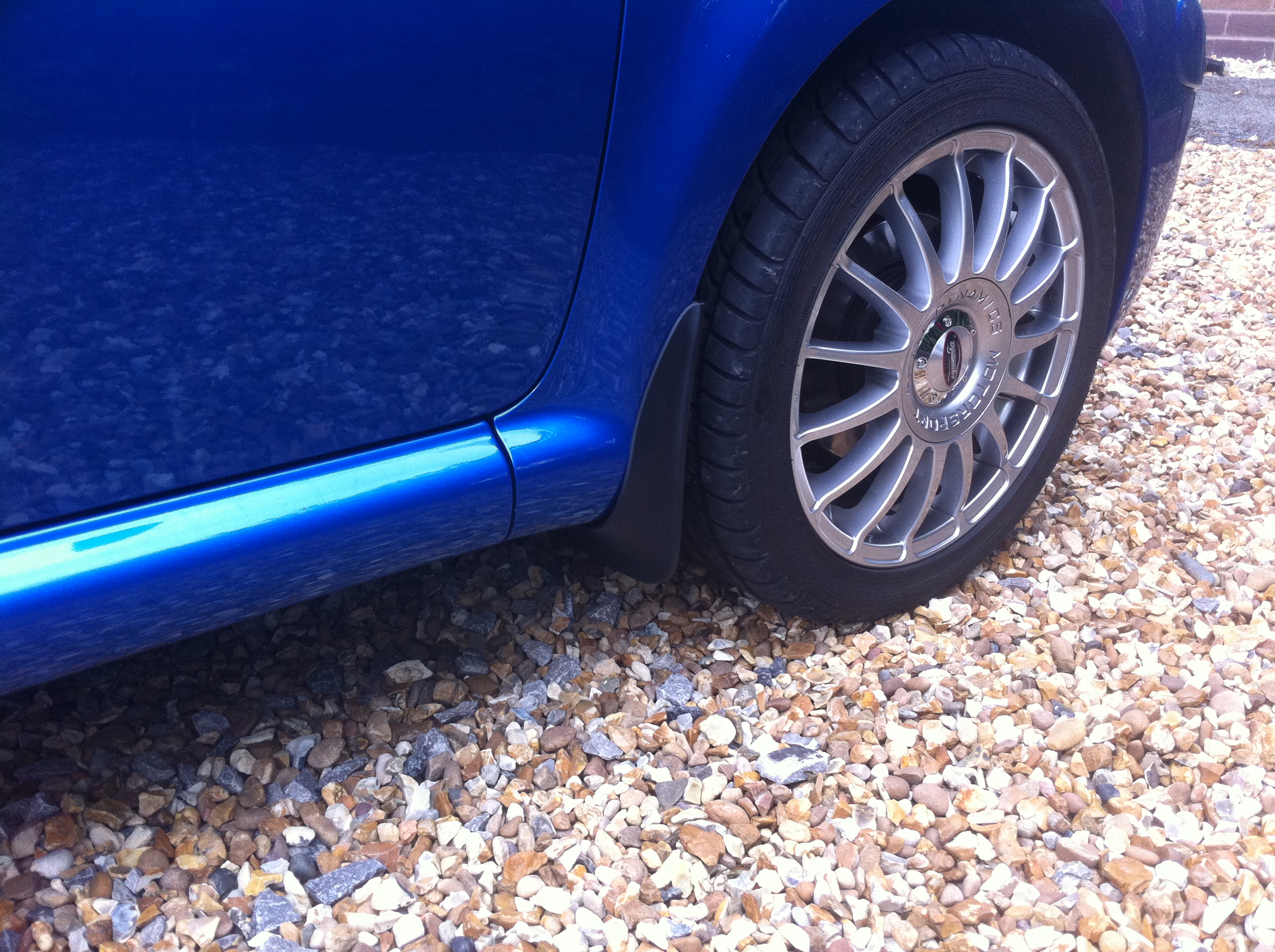

Are you sure those are stock bolts? They look like theyre from Frankensteins neck! lol. The rear mud flap where Philips cross head screws. I ve never seen bolts tick out as much as that on any front mud flap guard.
Yes they are stock bolts, I did buy a front set and as advised they are easy to fit into the plastic which is already in place on the car.

post-110908-0-93259700-1310745180_thumb.
