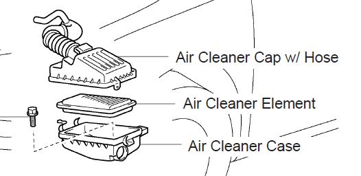

Hello mate, here is a picture of an air filter assembley it's for the diesel engine but they are very similar, the top cover is held on with clips, just release them carefully, lift the top cover with the flexible hose still attached and take out the old paper filter element (you will see if it's dirty) then fit the new one and make sure it's seated down properly. Refit the top cover and clips ...... job done! ;).
Regards Pete.
