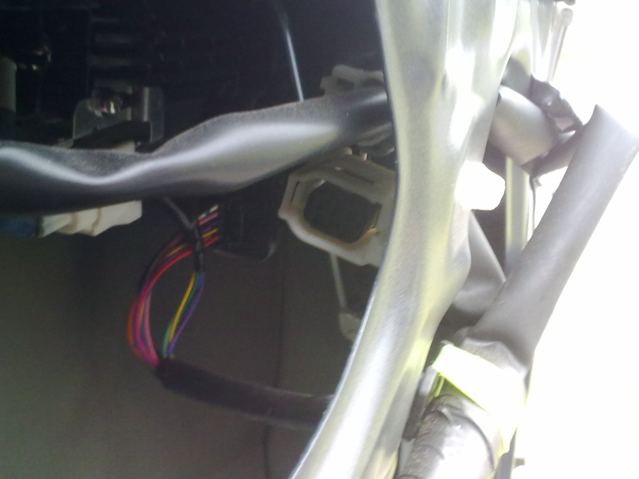

post-110805-0-39064800-1313180383_thumb.Seems you guys know more than the said master technician, I whipped the back door cover off today and what do you know, right where all the pictures I have seen on here sits a 6 pin connector that has 2 black wires 1 red and 1 white wire going to it.
Will order a camera soon an attach it one way or another.

Not wanting to sound sarcastic, but "Quelle Surprise!" as they don't say round here. :D.
I expect the dealer was just fobbing you off, as installing the camera would have been slightly "non standard" for this vintage of vehicle. I wouldn't be surprised if it boils down to something like they don't have a "job sheet" or standard time booking for doing it on a 2007 T180.
