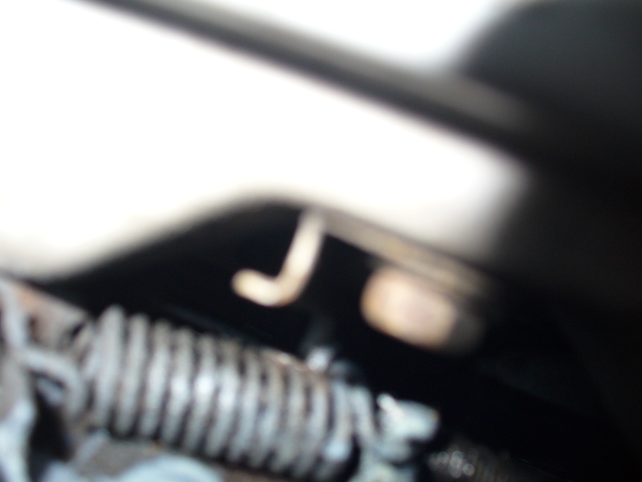

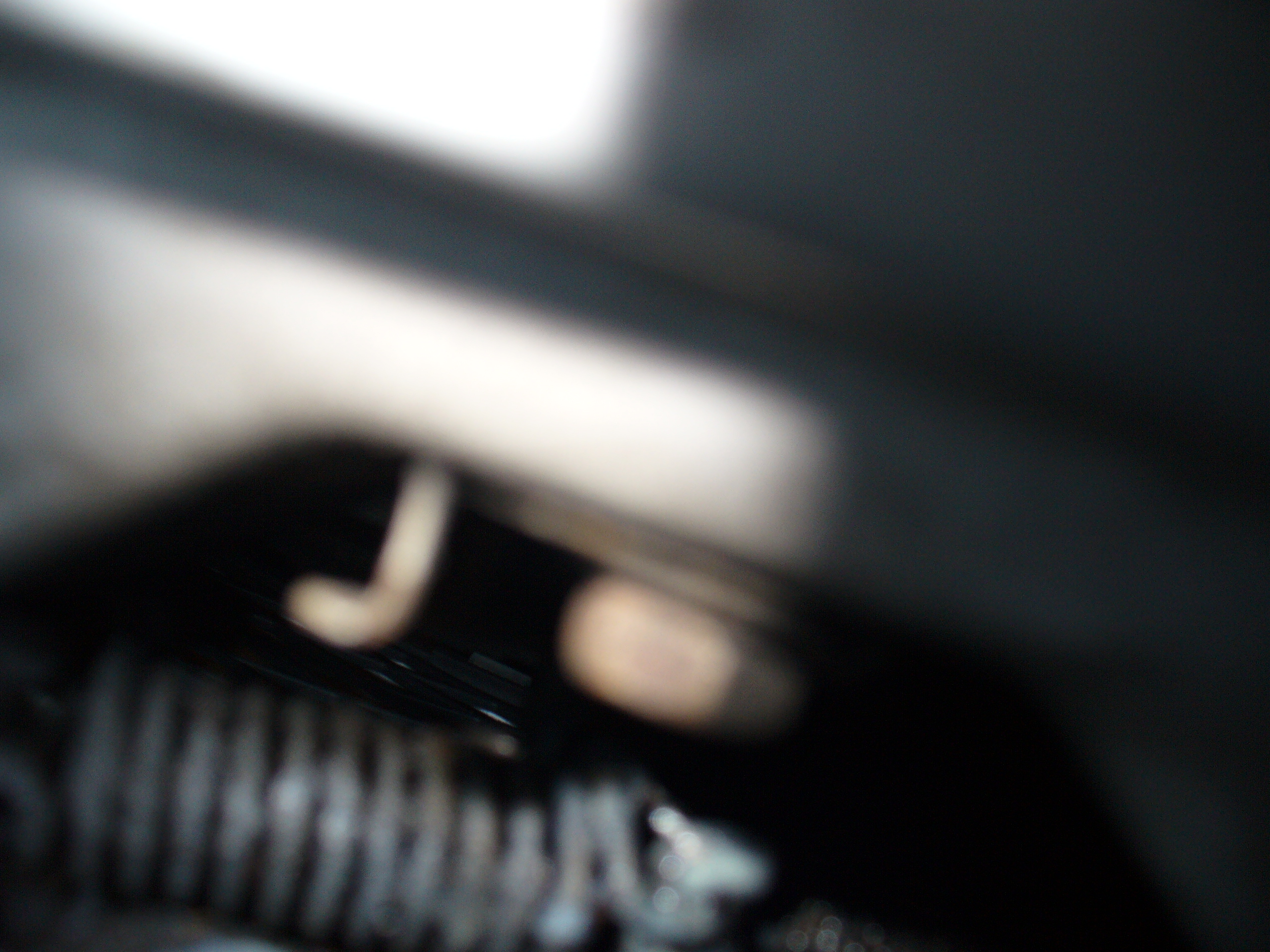

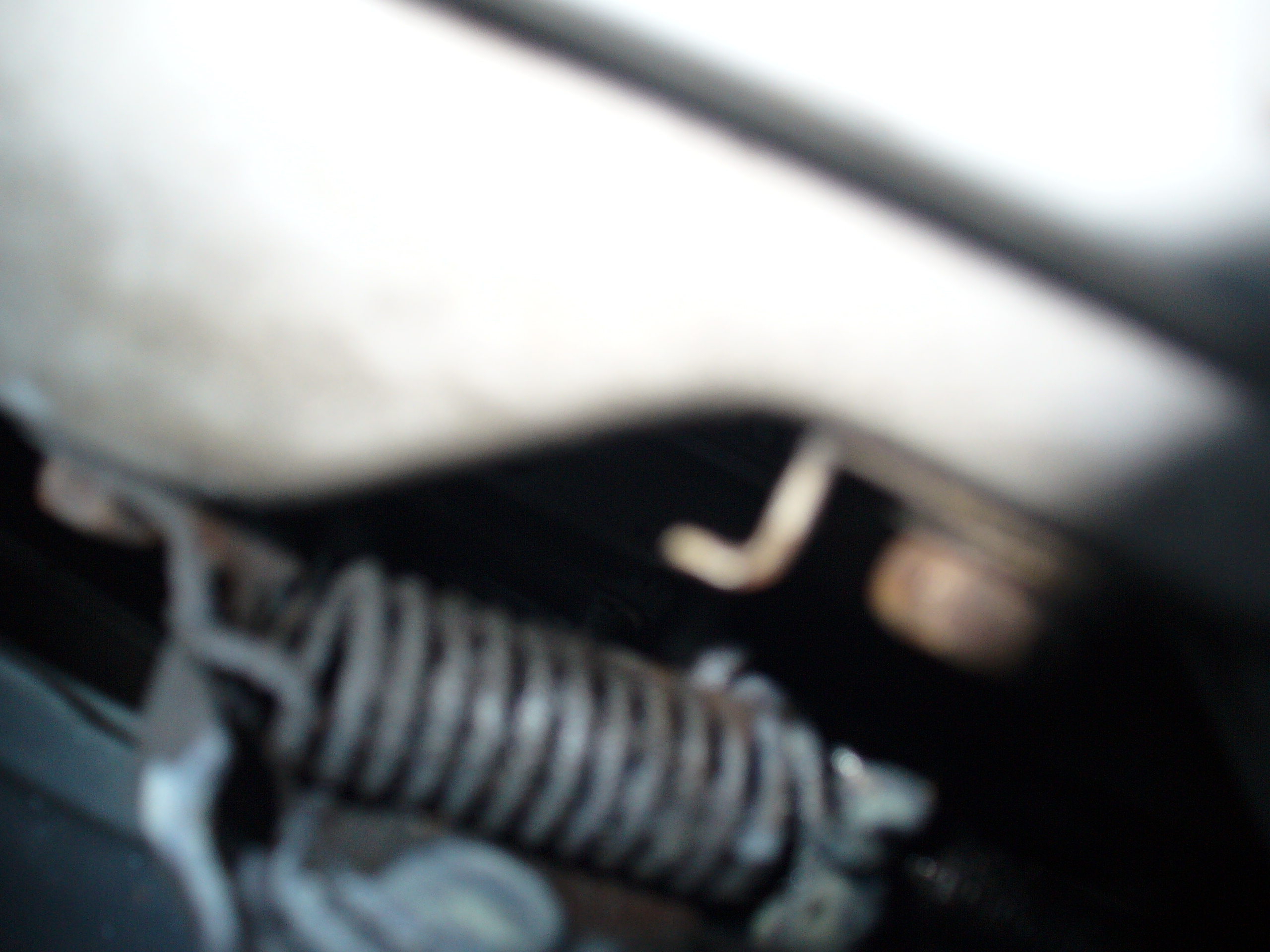

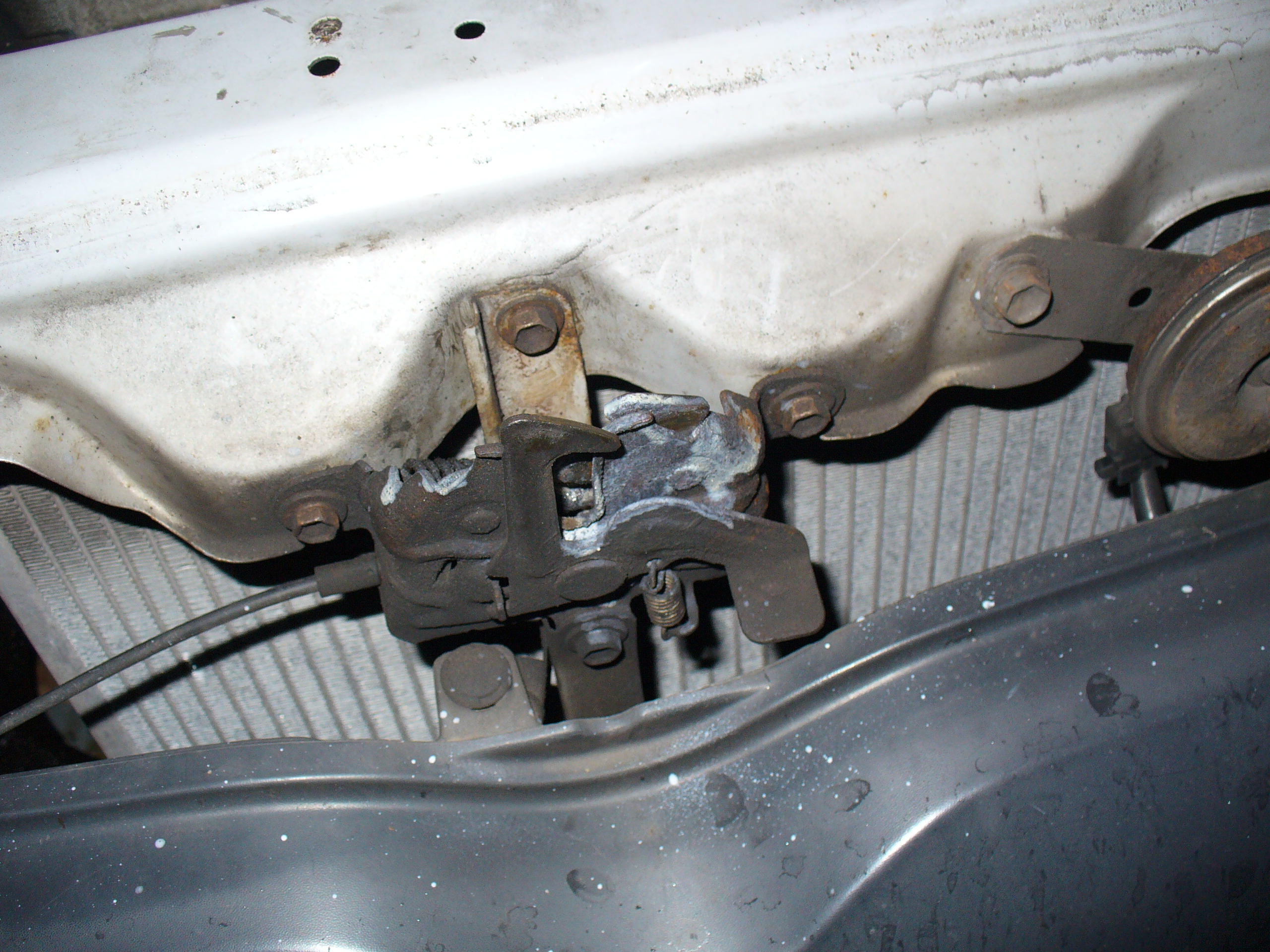

Pictures of son's 1.0 (2001) bonnet release mechanism.

The release cable runs from left of picture to right under the spring shown at the top.. It ends in a lever directly under the right hand end of the spring.
Hope this helps.
Hmm.. Still not really sure. Could you please mark on the first one what you think I need to push and in which direction? I think it will be the third 'layer' back, with the hook / lever being the first, but I'm not sure and either can't find it or it won't budge...
Current thinking is if I can't shift it and Toyota themselves either don't know or want £££ then I may just buy a replacement chrome grill and smash the one that is on there to get better access. Brutal I know but at the moment I look like a self-harmer with all the marks on my forearms from reaching up through the lower mesh...
