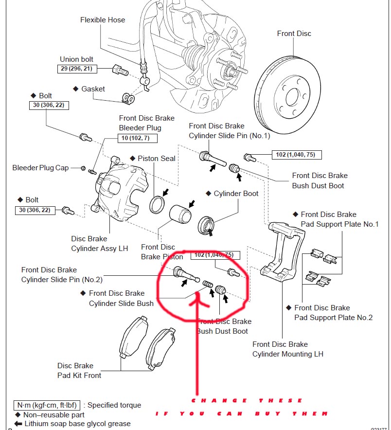

Hello Peter, I think you really need to change the bolts due to wear.
Regards ...
post-74463-0-70908300-1314431557_thumb.j
Cheers for the reply, yes i'd change them but was quoted £98 + vat for 4 bolts surely not?? might go into the dealer rather than phone them.

hello guys
as a temporary solution you can apply a thin bras/copper foil to have gaps minimized between bolt stem and caliper hole. It definitely safe your pocket for a while -- but seriously think about new bolts or you can follow the way to make bolts of stainless steel on the lathe machine to reach the same gap minimizing. May be this will help. Cheers/Igor
