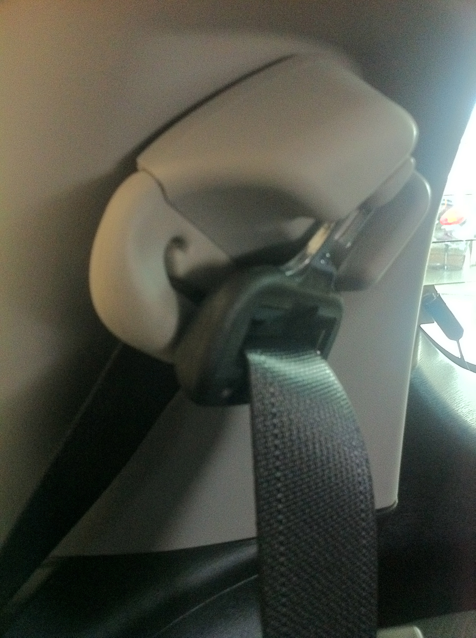

Hi J
went to MR T and ordered some of those studs, £0.70 each probably plus vat Also took the pic included of a new iQ and the clip you spoke of. I had a good look at it and it is integral with the seat belt. essentially it is the same swivel mount but instead of being dome like it had a cut out and a hook to hold the clip. It looks like a complete new seat belt each side would be needed. Interestingly, the original poke slots are still on the new one. I expect not worth a new moulding.

Sorry David I should have looked more closely at those new clips tp see if they were separate to the belts.
I fixed the rear belt problem on my old IQ by using those buttons/studs again...I put one in each belt in a position so the buckle dangled well away from any panels when not in use, so could not rattle against anything.

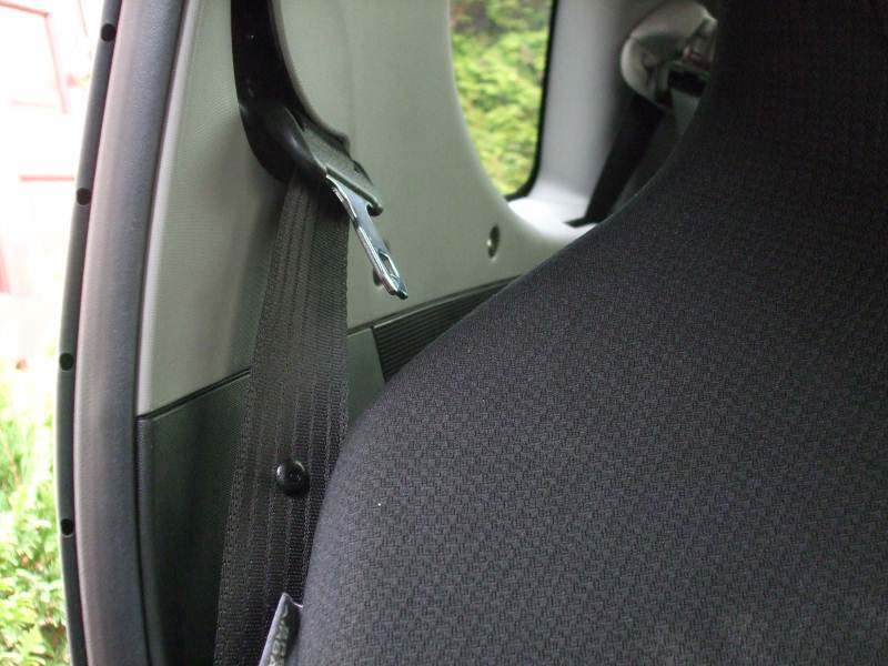

David,
I positioned the button/stud so that the buckle would be held up against the slot in the B pillar when not in use, and it is no problem accessing it from there.

The one I photographed is about 3 weeks old, hence the "new" clips on the rear belts.I had buttons ready to fit to the belts thinking they would be the same as my old IQ, but not so!
John

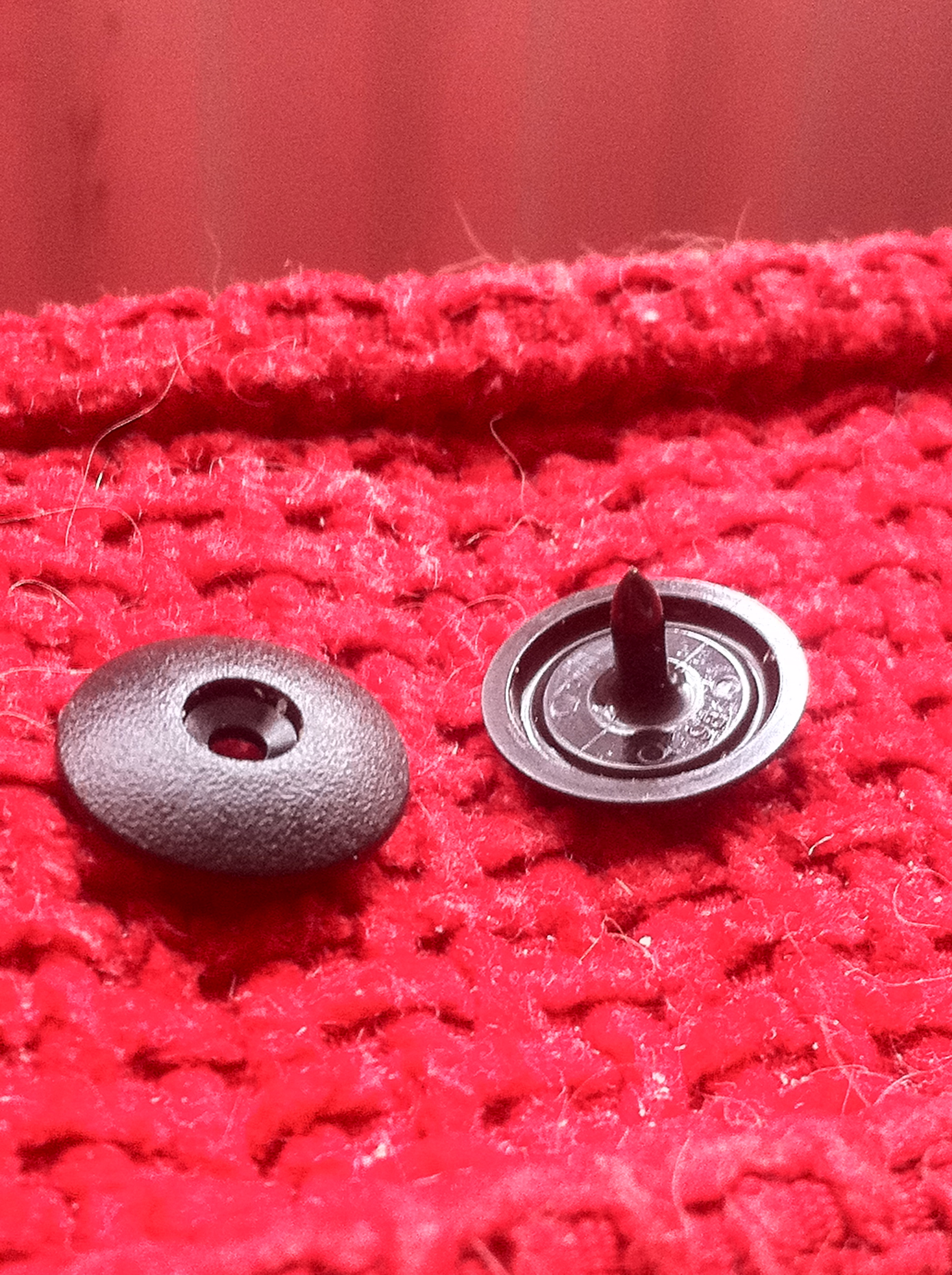

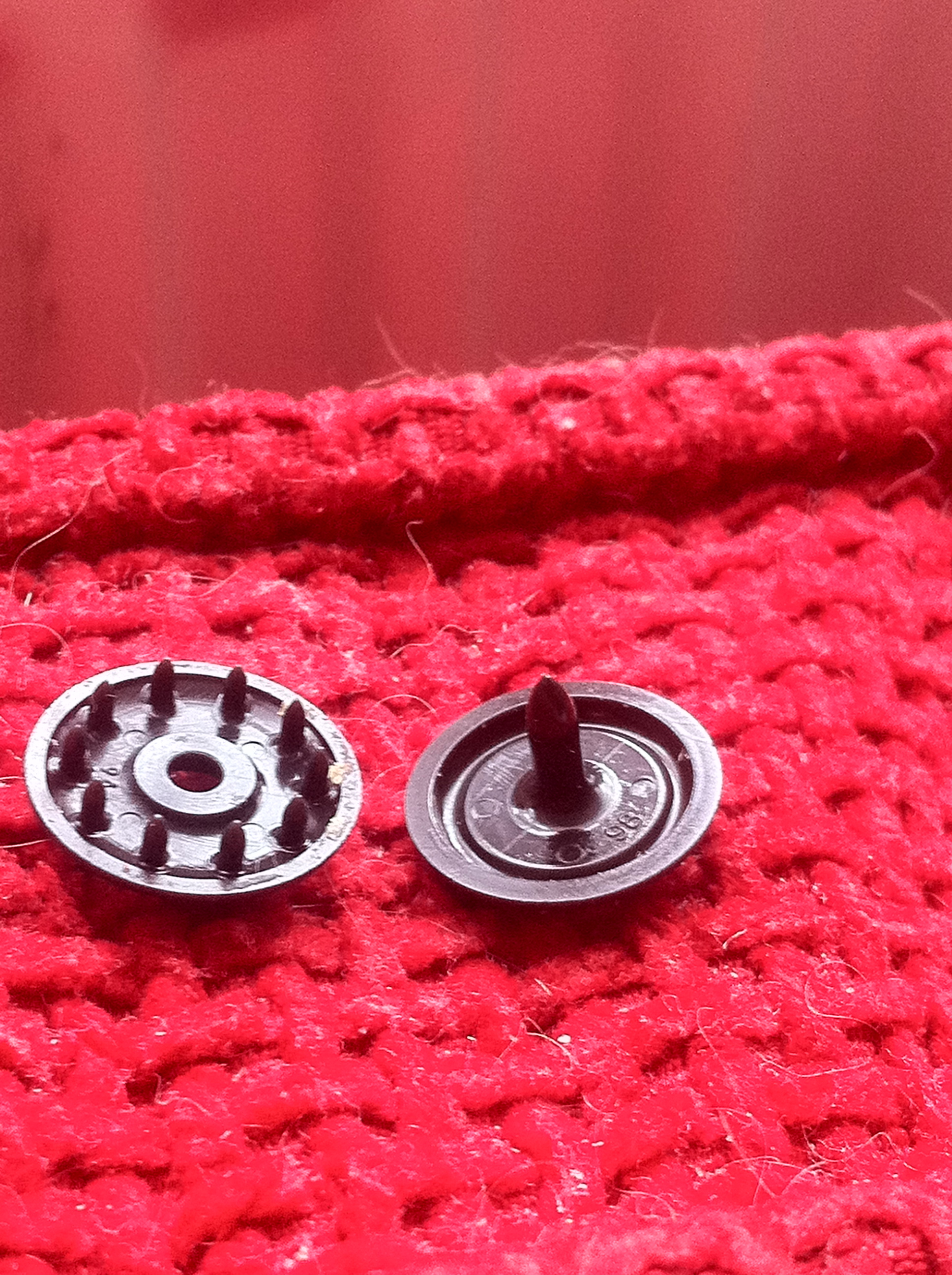

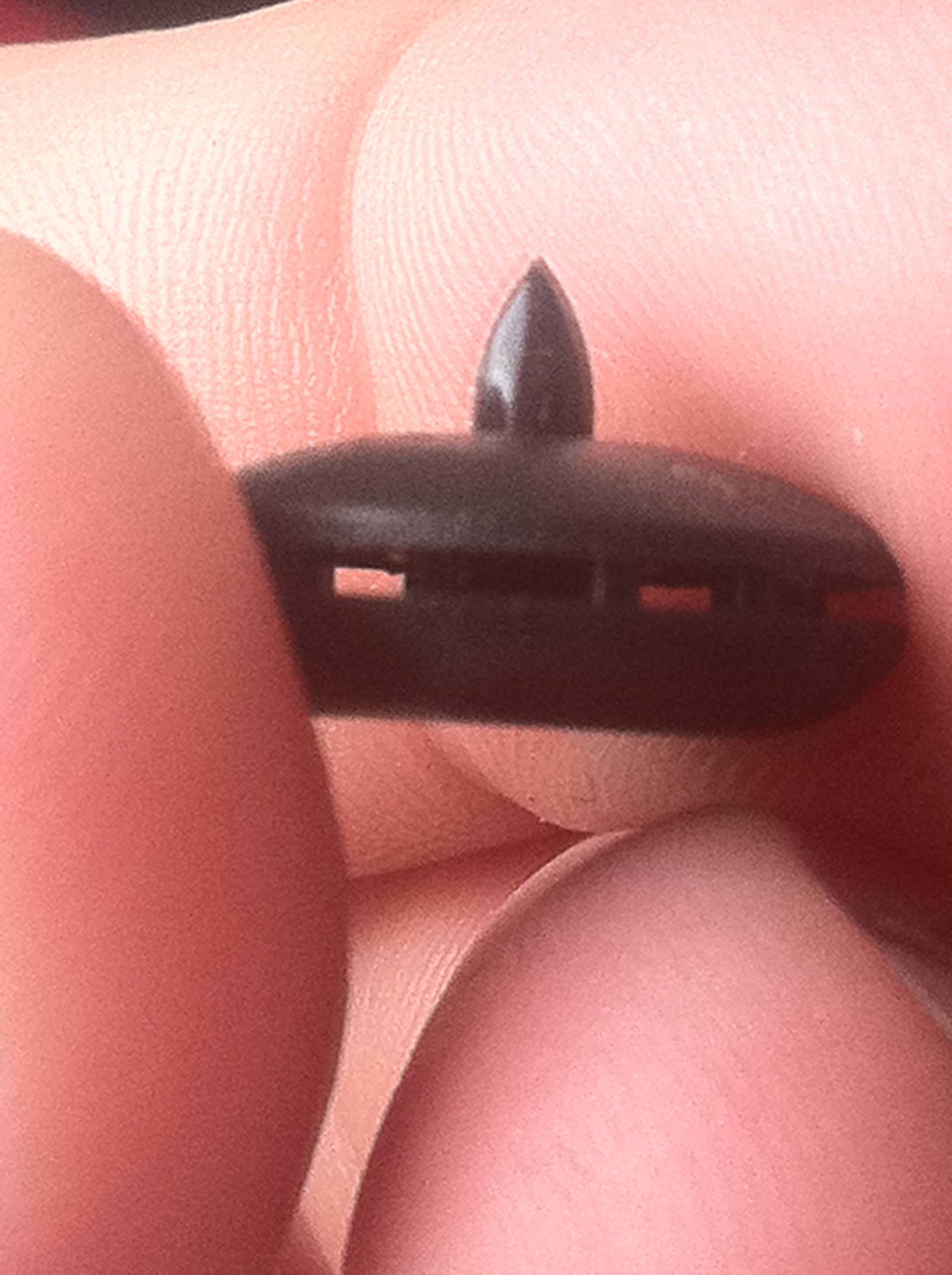

Hi Johnan,
I got the seat buttons but were not as expected.Have a look at the picture. They obviously consists of 2 parts, one half being with a spike to push through the fabric and the other half which has circular spikes to grip the other side of the fabric.The spike goes through to the other side and just does nothing. I can only suppose that you have to use pliers to compress the two halves together to get the spikes to dig into the fabric and mane melt the spike with a soldering iron into a blob to keep the two sides together.I was expecting a one shot clip together which is what the original ones look like.They are described on the packet as "STOPPER TONGUE" 73219-33010.Can you tell me if thats what you got or maybe I have the wrong item.Cheers
David
