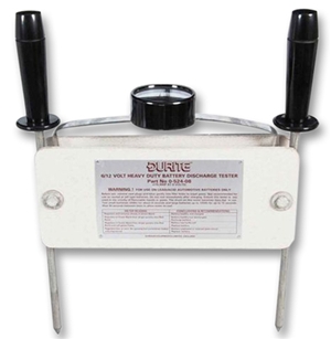

I have lost count the number of times I have seen people buy new batteries needlessly. Yes Sir your Battery is furbarred here's a new Kerching!!
A few simple cheap tests can avoid such an expensive mistake.
1. Get the Battery load tested using professional test equipment (see attached picture) - a piddly we hand held unit or a voltmeter is useless. Ideally the Battery should be tested three times in succession - if there is a weak cell it'll show.
2. Have the alternator output checked - ideally just after the engine has started from cold.
3. Check what residual ampage drain remains after the car has been locked and parked up for 15 minutes or so.
Many decent battery suppliers (not the fast fit outlets) will do these simple checks for free or cheaply in the hope of gaining a sale.
Alawys remember the voltage reading across it battery is no indication whatsoever of it working capacity. After all if youi taped eight "AA" batteries end to end they would give out 12 volts but anyone with half a brain would know they wouldn't start a car.
One other point to remember a poor battery will shorten the life of the starter motor and a poor starter motor will shorten the life of a battery.:)

I have lost count the number of times I have seen people buy new batteries needlessly. Yes Sir your battery is furbarred here's a new Kerching!!
1. Get the battery load tested using professional test equipment (see attached picture) - a piddly we hand held unit or a voltmeter is useless. Ideally the battery should be tested three times in succession - if there is a weak cell it'll show.
