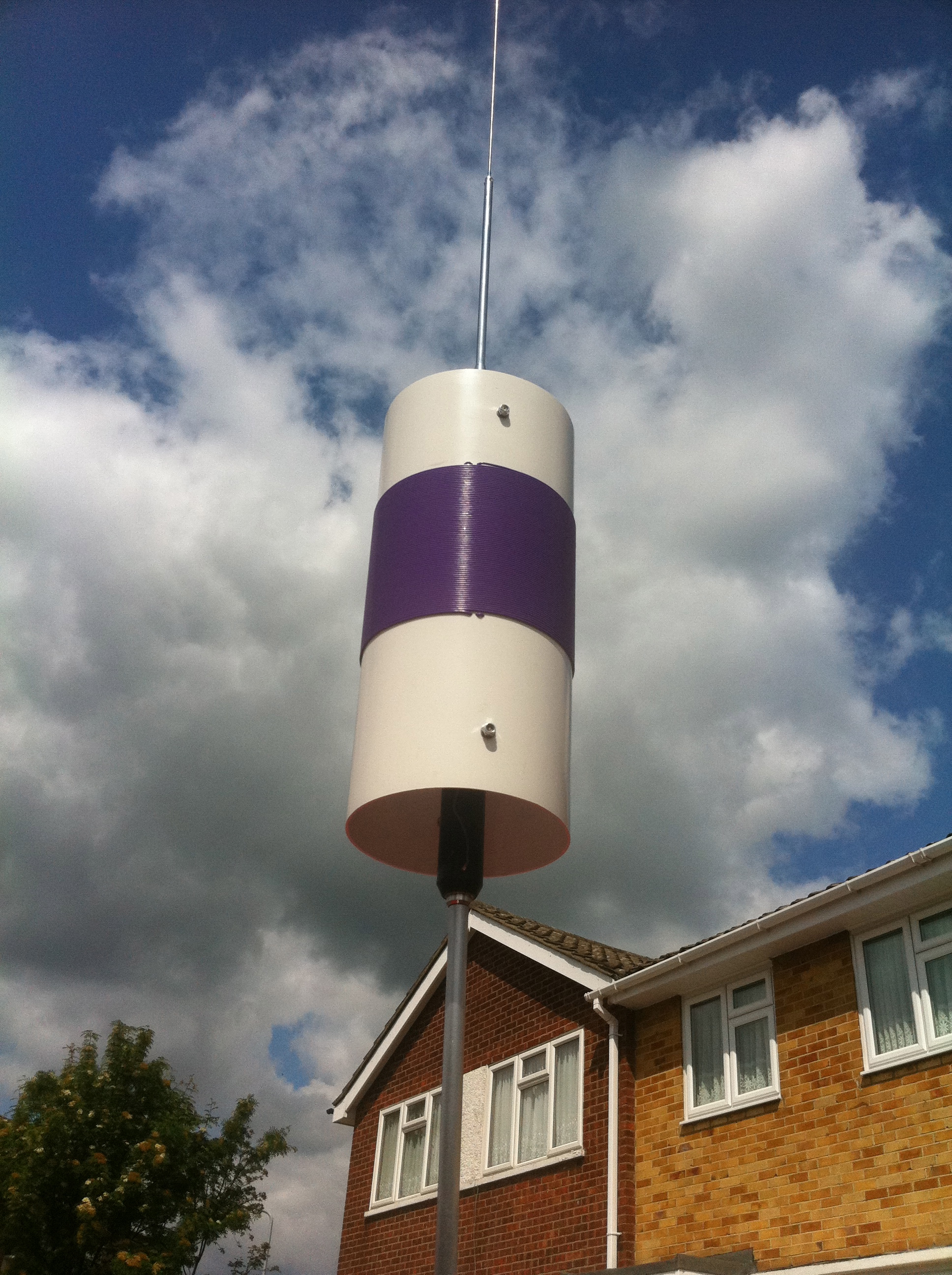

You don't say what band you want to use. I am assuming its either 2mtrs or 70cm. I don't suppose your talking 28mhz Have you considered through glass antenna"s like this link.http://www.k1cra.com/catalog/product.aspx?productID=1698 Its dual band. Probably available in the UK. I did recently get a loaded whip to resonate an the roof of my iQ on 1350khz testing for a restricted service license.

That's quite a loading coil! Did you have to anchor the car down in anything more than a light breeze? I rarely go below 40metres to be honest, and will get a drive on mast support for stuff like that, but for general park up and chat stuff (12 - 10mtrs) it would be nice to have a whip on the car.

its quite difficult to tune lots of inductance gives a bandwidth of 20khz so ok for medium wave. needs a capacitance hat really to get that inductance down. I ran 800w pep into it you should of seen the corona totally lethal but what fun.
