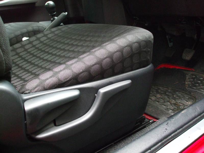

David,
Just for your information, this is what the height adjuster looks like.
It is the longer of the two levers.
The shorter one is for the angle of the backrest, as before.
John
