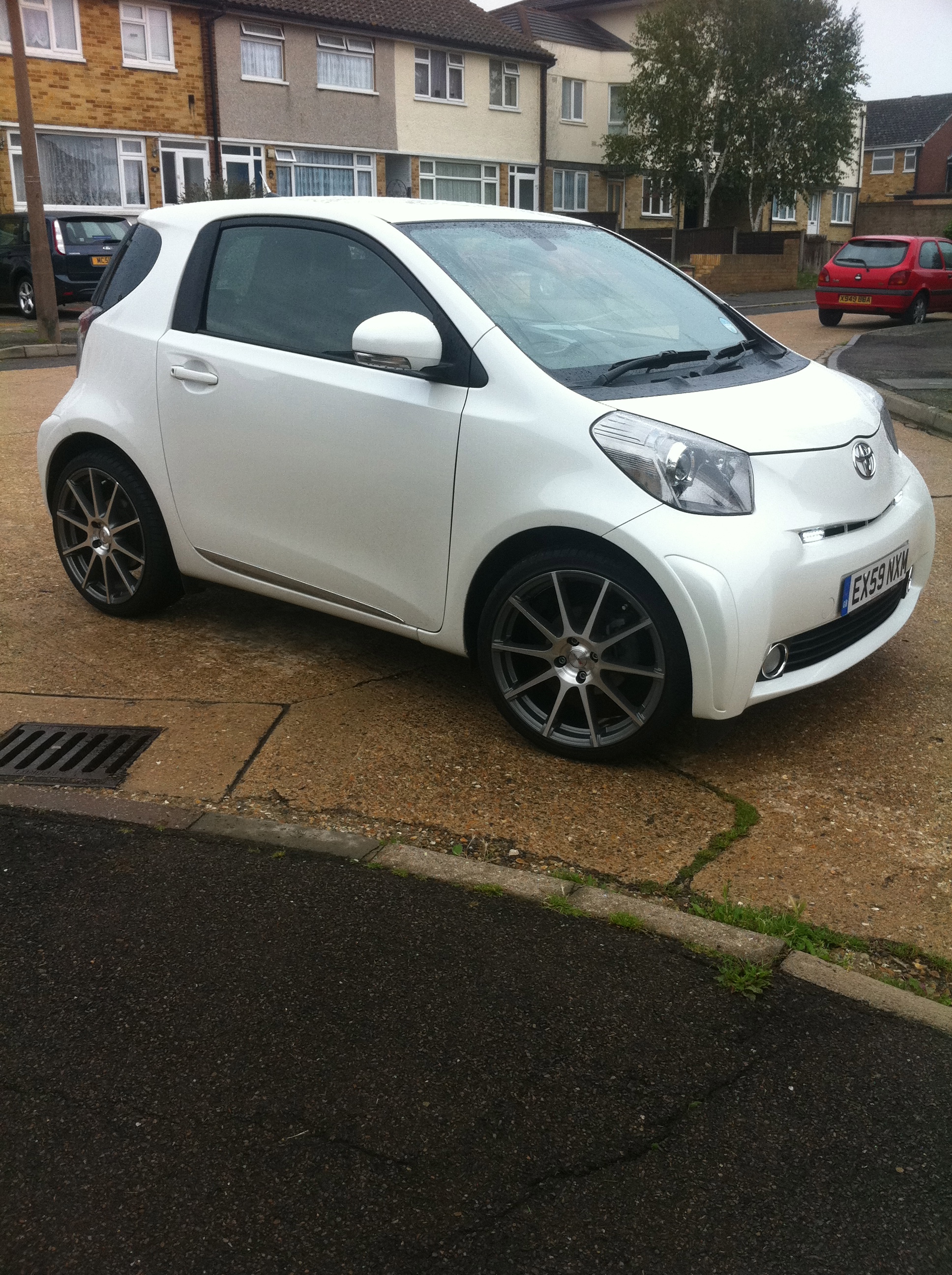

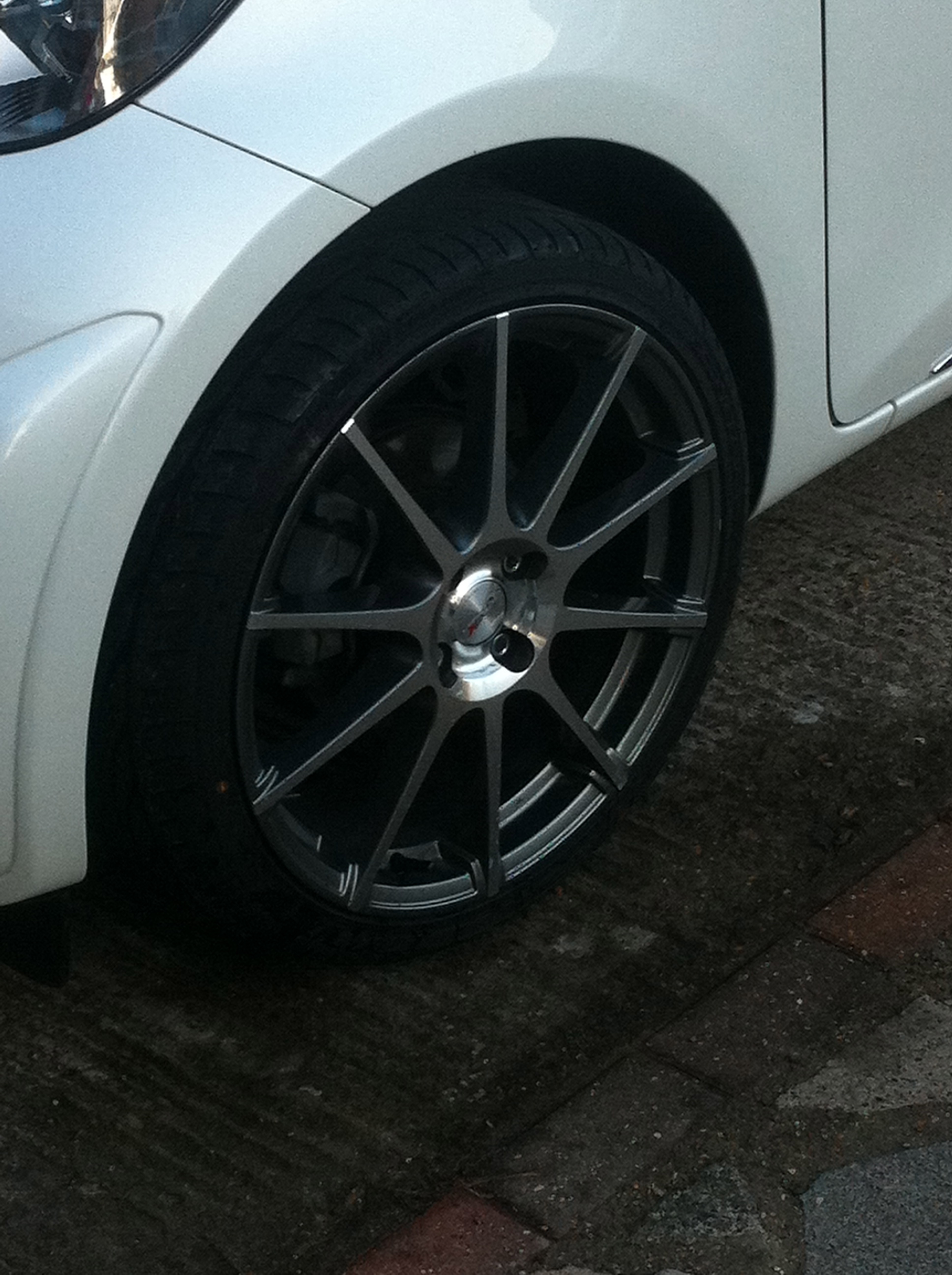

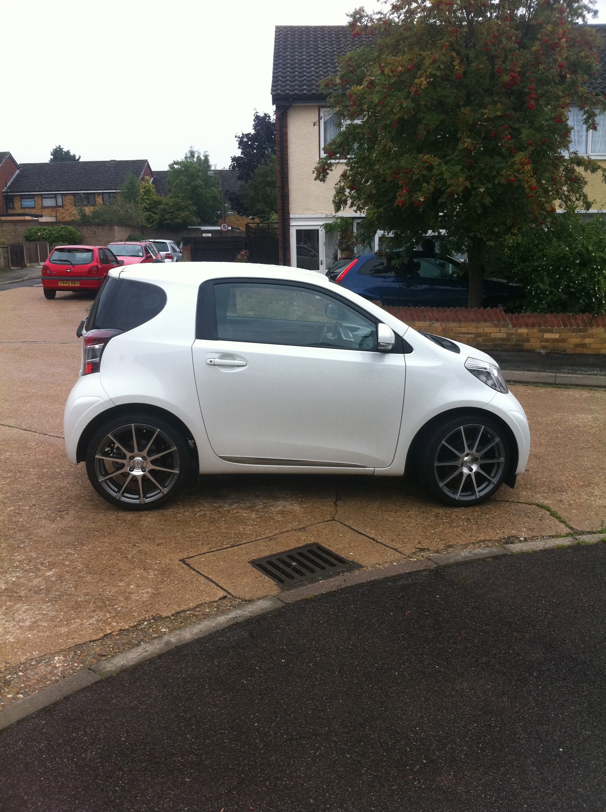

I have 18 inch 7.5inch wheels with 18 x 215 x 35 tyres
The car is lowered by toyota's lowering springs by 25mm
The front tyres are very slightly proud of the arches. I think some people are very happy with 7inch wide wheels. I would also say that in my opinion the car looks its best with wheels that have lots of spokes

post-109788-0-26423900-1318007365_thumb.
post-109788-0-08396900-1318008098_thumb.
post-109788-0-74181400-1318008138_thumb.
