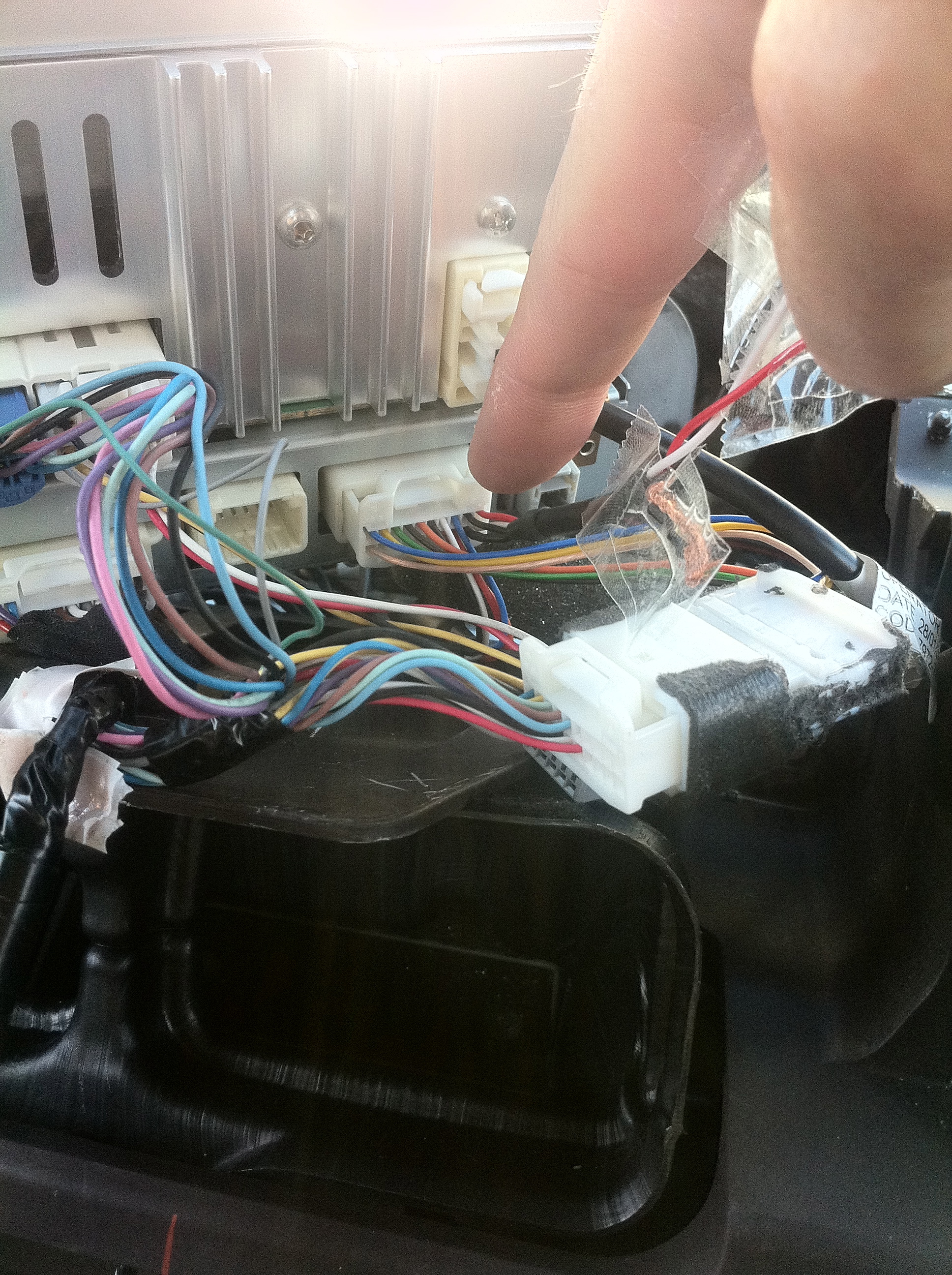

For the TNS510 to accept a camera input, a few things have to occur. Firstly, there are 4 connections at the rear of the unit pins 27,28,29 and 30. They are colour coded, RED, WHITE, BLACK and screen (braided wire)
Now you would think that they are obvious connections but they are not. When the unit is powered up from !st and /or 2nd stage ignition, the unit produces 6v on the BLACK wire and the negative side being the WHITE wire. Now unless you are going to feed MR T's camera which is an unusually 6volt camera, these 2 wires can be ignored,either taped up or left in their connector sockets. The one's your interested in are the screen and the RED wire.
The RED wire is Video In and the screen it what it is, the shield for the video signal.

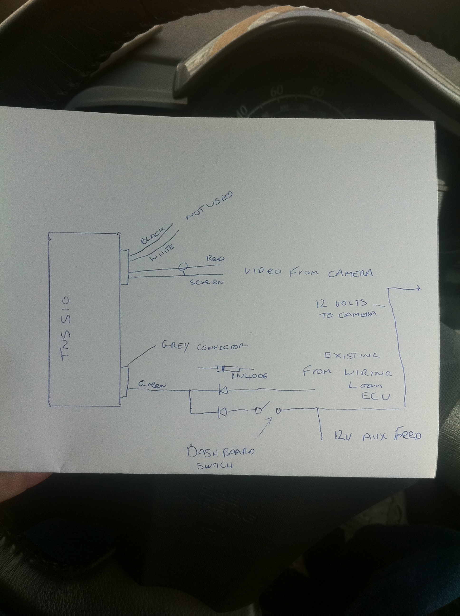

This is not the end of the story. For the unit to switch into camera mode, a 12volt supply is fed from the ECU via control function by actuating reverse gear. This is where I had problems and upset my ECU.Normally 12volts would have been switched when the switch in the reverse gear lever was actuated rather than a low level command the ECU.
By just using the RED and screen wires and powering the camera from a switched 12volt supply (i.e the auxiliary socket below the A/C consul via fuse) all works fine when you choose reverse.
The problem was I wanted to switch the camera on whilst not in reverse.

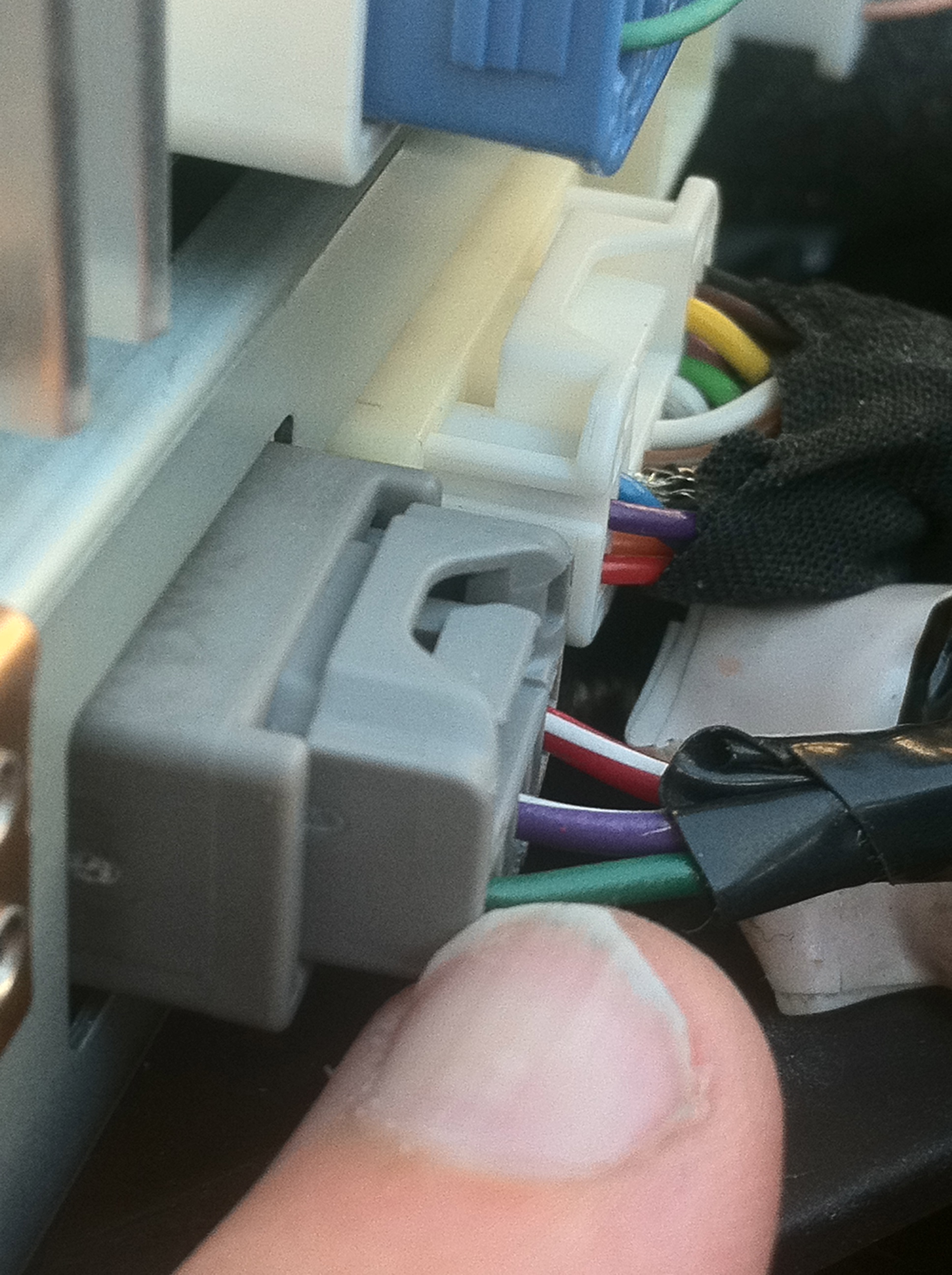

When the gear is put in reverse, the 12volt switching voltage is sent from the ECU on a green wire in a grey socket to the unit. One would think by emulating this 12volts you could switch the camera on.Well that is what happens except it brings up engine management light, air bag light and VSC alarms!!! whats worse is that by removing this 12volts the alarms still remain and switching the ignition on and off doesn't clear them.!!!.
Fortunately, by removing the Battery for 30mins resets the ECU and resets stored memory.
So what do we do?
You need to make sure you have cut back and revealed about 4inches of the green wire and cut it. Solder a 1n4006 diode between the 2 ends you have just cut. Anode towards the ECU feed and the Cathode (stripe) towards the unit as in my diagram. Also soldered to the unit end is the switched 12volt feed again via a 1N4006 diode as per my diagram.
Now with the first stage of the ignition on you can operate your bypass switch (which i mounted on a spare blanking plate on my dash board and illuminated it) and the camera will come on and no nasty alarms. Works perfectly.
The diodes are included to stop your switched bypass 12volt feed going back down to the ECU and upsetting it but only going to the TNS510 to switch it into video mode.

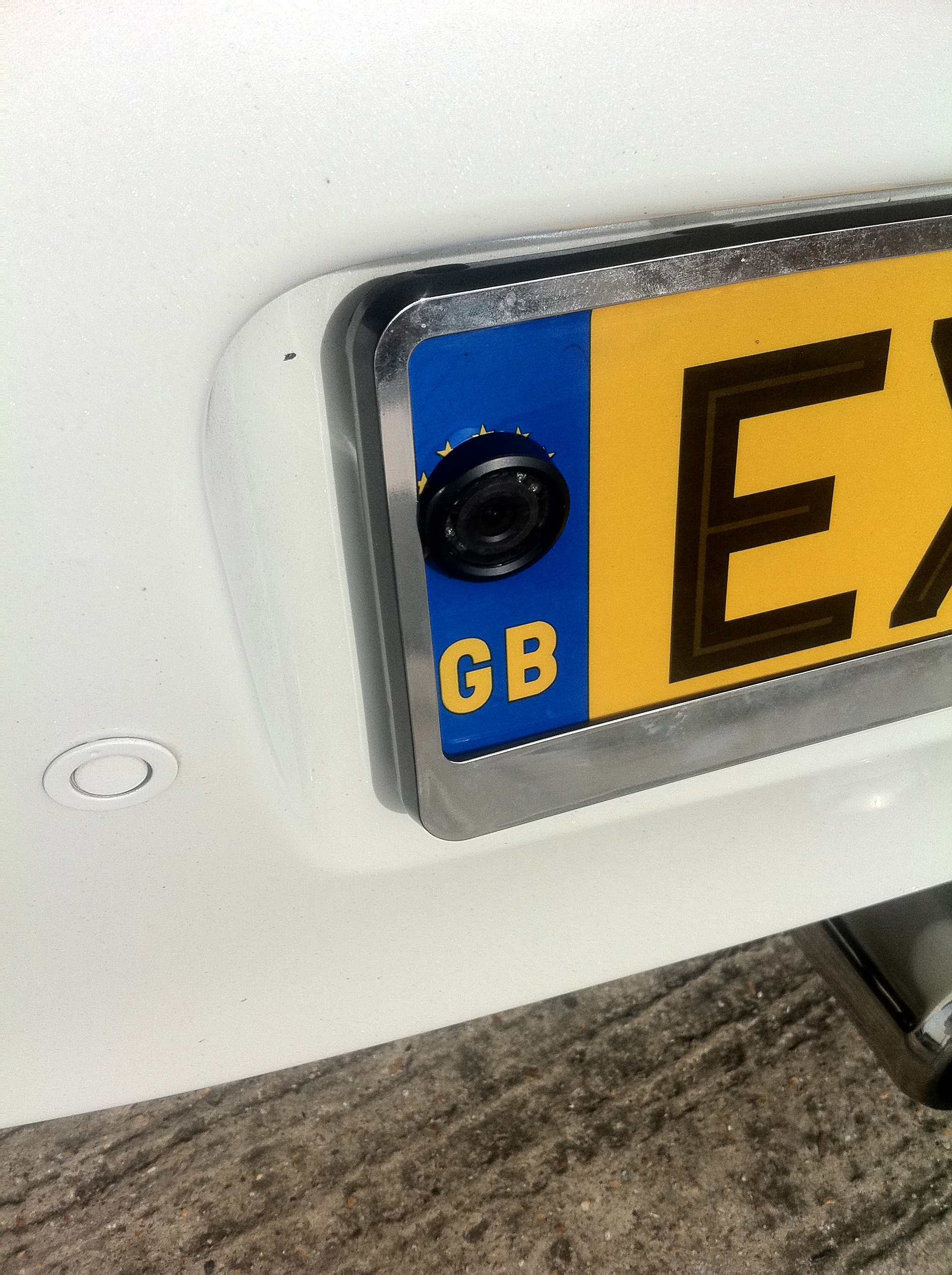

That sounded a fairly lot of homework in getting the camera to work. The position of the camera is very neat in the number plate.

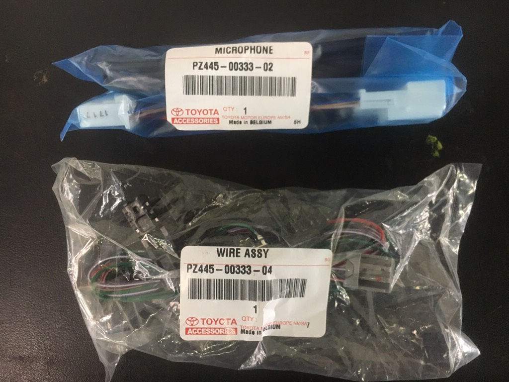

don't know which cable you mean but does page 6 of this help at all? https://www.toyota-tech.eu/aimuploads/{4DC3ED24-FB59-EDEF-D0DD-9CC5112DFB59}/IQ_TNS_510_RHD_PZ445_00333_00_AIM_001_388_2.pdf
Thanks, it is the cable "B" in the page 6 of the document.
The microphone cable has the part number: PZ4450033302
I also found a reference for "SPARE WIRE ASSY TNS", part number: PZ4450033304 (can't confirm it is what I need)
and another similar part no for "SPARE INSTALLATION K", part number PZ4450033303
Question answered (and cable ordered). The part number is indeed PZ4450033304.
In the attached picture you can see the part numbers for this one and for the microphone cable.
