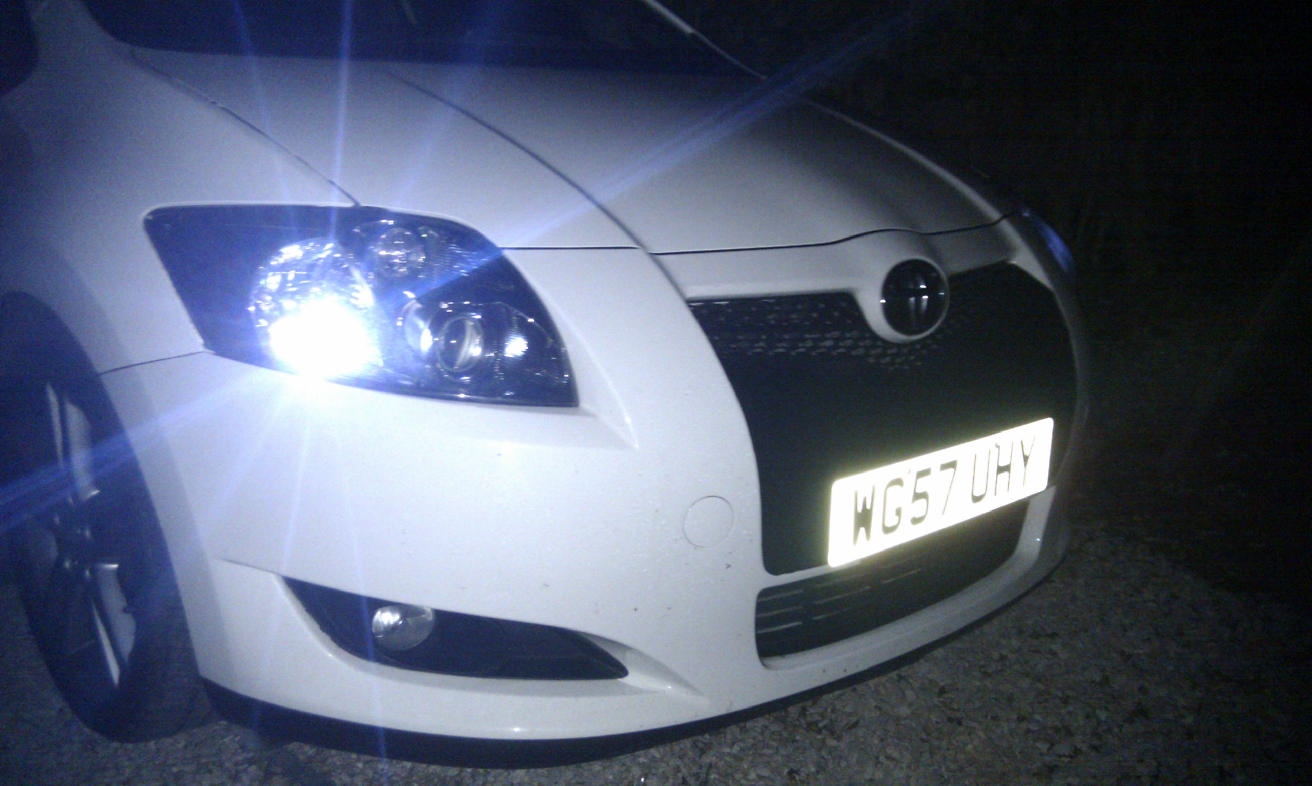

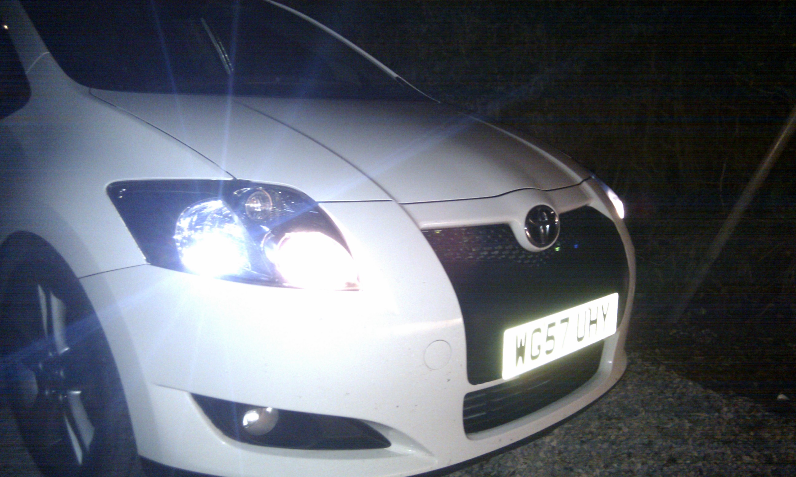

Have attached some pics to show how mine looks with upgraded sidelights and headlights. The dipped beams are Osram Nightbreaker+, white quad-LED side lights, also replaced main beam for Philips BlueVision bulbs and pout in Philips SilverVision for the indicators to get rid of the orange mess in the cluster! Well worth replacing though as much better look/light.
Also changed all the other lights (interior, vanity, map, boot and rear number plate bulbs) with the quad-LEDS and it looks so much smarter!
Currently in the process of changing dashboard and Climate control displays to blue and white (with the odd red thrown in for shift up/down), however its very tricky and fiddly, so not rushing it!
Hope this helps.

Very nice matey!looks gorgeous
