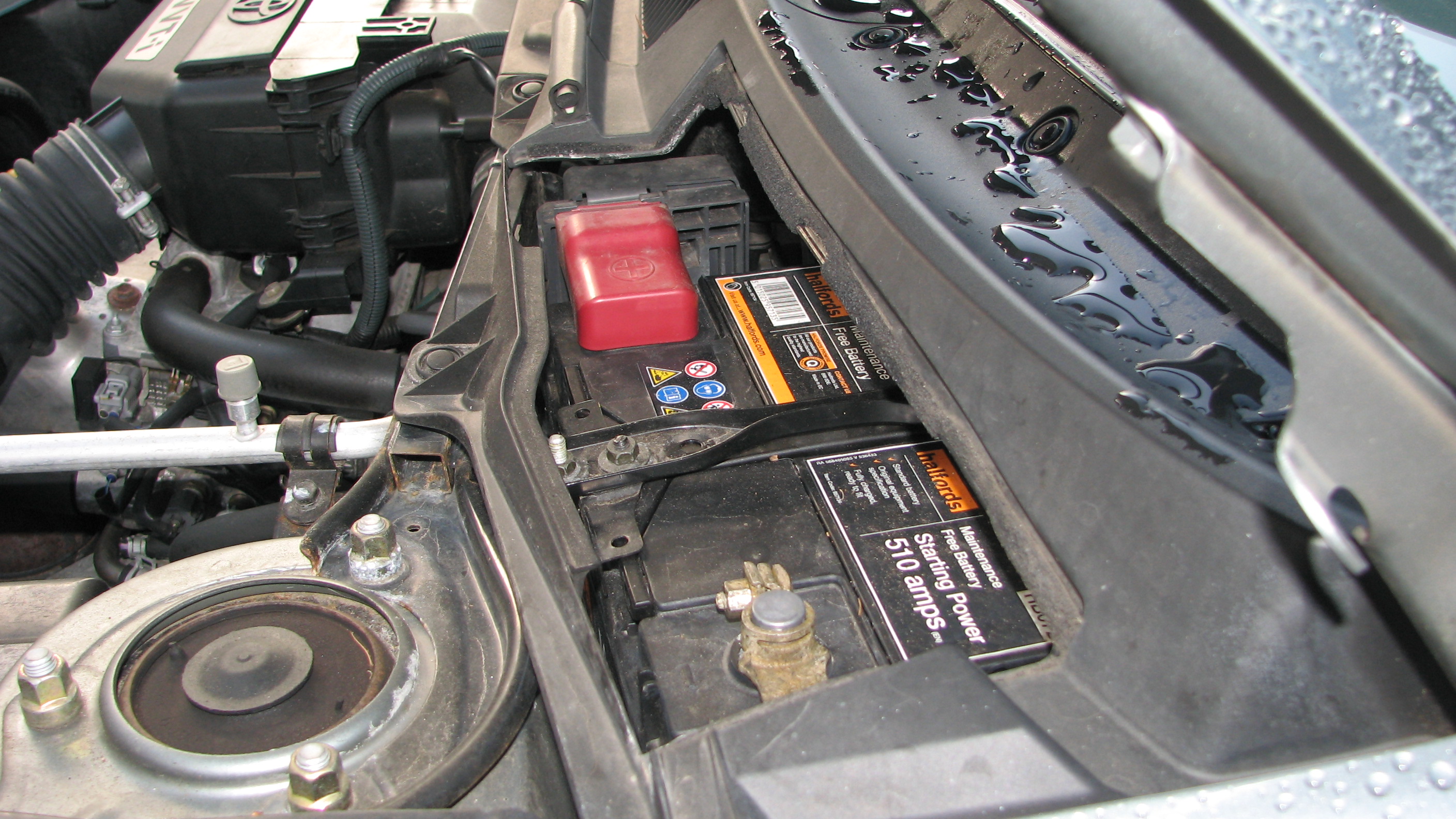

Here is my 70aH Delco Premium.
The brackets are set at their maximum by using the outer hook/eye mounts at the bottom and the outer mounts for the clamps at the top. Note the handles can't be down in this configuration.
Whilst the cable strain is not totally obvious to the point the cables are stretched at the connectors and at risk of damage should the Battery move whilst driving; the Power cable is tight enough that the red +ve cover can no longer be fitted, and the distribution block is fitted at an angle.
It fits, but can't be any bigger, and took about 30 minutes to install.
The Battery is shoved to the far right of the Battery tray to make the power cable and the rigid right-angled part of the distribution block reach, and some of the sleeving that is clamped near to the suspension bell housing needed to be loosened and moved to give more slack.
EDIT: In fact, seeing those pictures again I'm going to redo that because it was done at the roadside on Saturday and I'm not happy with it.
Whilst the cable strain is not totally obvious to the point the cables are stretched at the connectors and at risk of damage should the battery move whilst driving; the Power cable is tight enough that the red +ve cover can no longer be fitted, and the distribution block is fitted at an angle.
The battery is shoved to the far right of the battery tray to make the power cable and the rigid right-angled part of the distribution block reach, and some of the sleeving that is clamped near to the suspension bell housing needed to be loosened and moved to give more slack.

I fitted a diesel Battery for BK and I don't remember struggling to fit it. Kev was there but he was still recovering after being stiffed by Halfords (named and shamed for taking advantage). Its been a long process but Kev has been left with a nasty case of tourrettes especially when driving past a retail park.
Within the red box is a large fuse that protects against short circuits - you should never get a Battery fire on a RAV.
....and as for Davrav insinuating that I charge golf BALLS for helping my fellow forumnicators....this is totally untrue....my standing charge for a SENSIBLE AND ULTIMATELY HELPFUL reply to any member's problem is ONE (1) golf ball.
I have therefore so far accrued the sum total of 0.85 golf balls, thus reflecting my helpful nature and knowledge on Ravs.
We should all reward each other in this fashion, so it would be BALLS TO EVERYBODY IN TOYOTA CLUB....? :yahoo:
It has now stopped raining up here after 2 years, so if photographs of larger Battery in wife's 3 door Battery tray fitted by Anchorman very easily (as I was there too....) just shout. The wee motorcycle Battery removed still holding charge strangely enough...

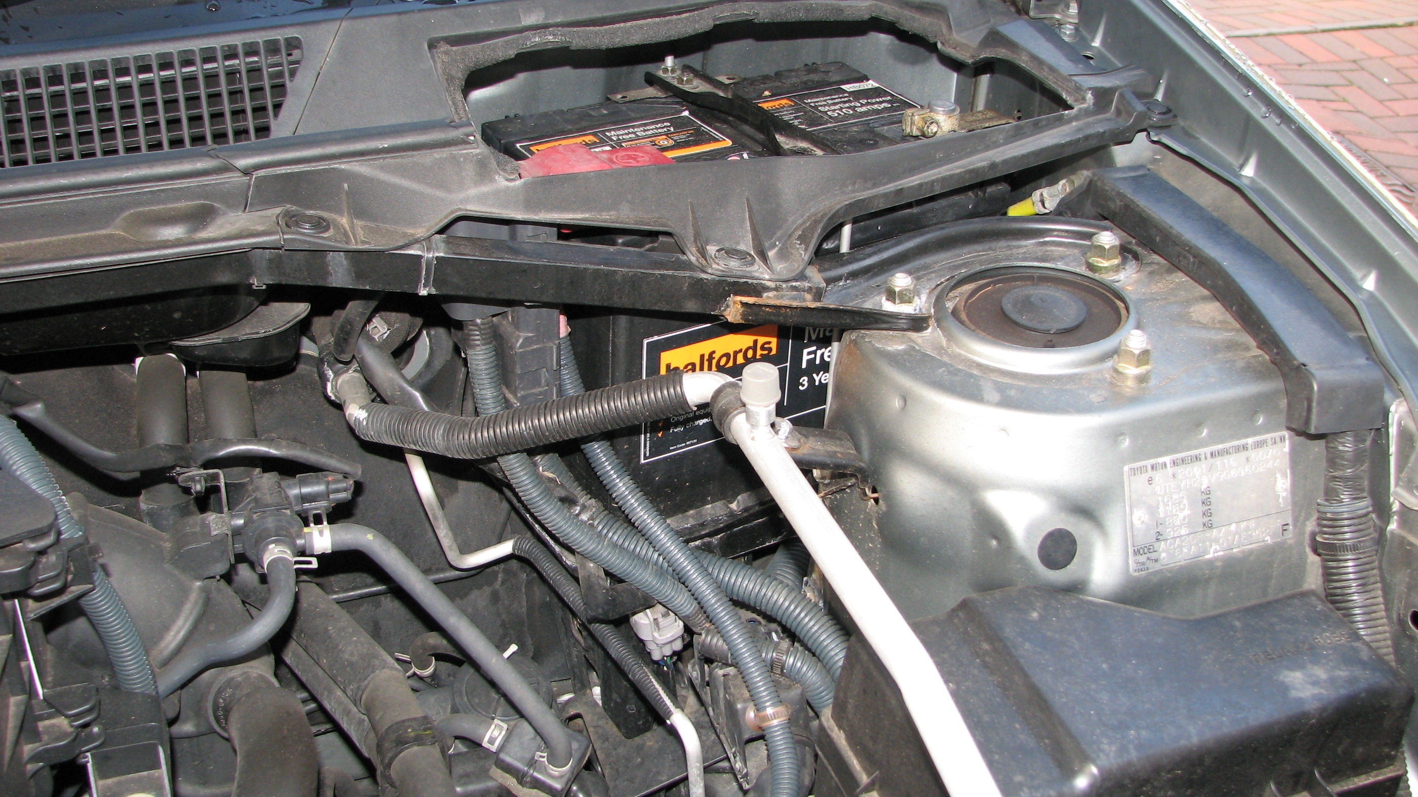

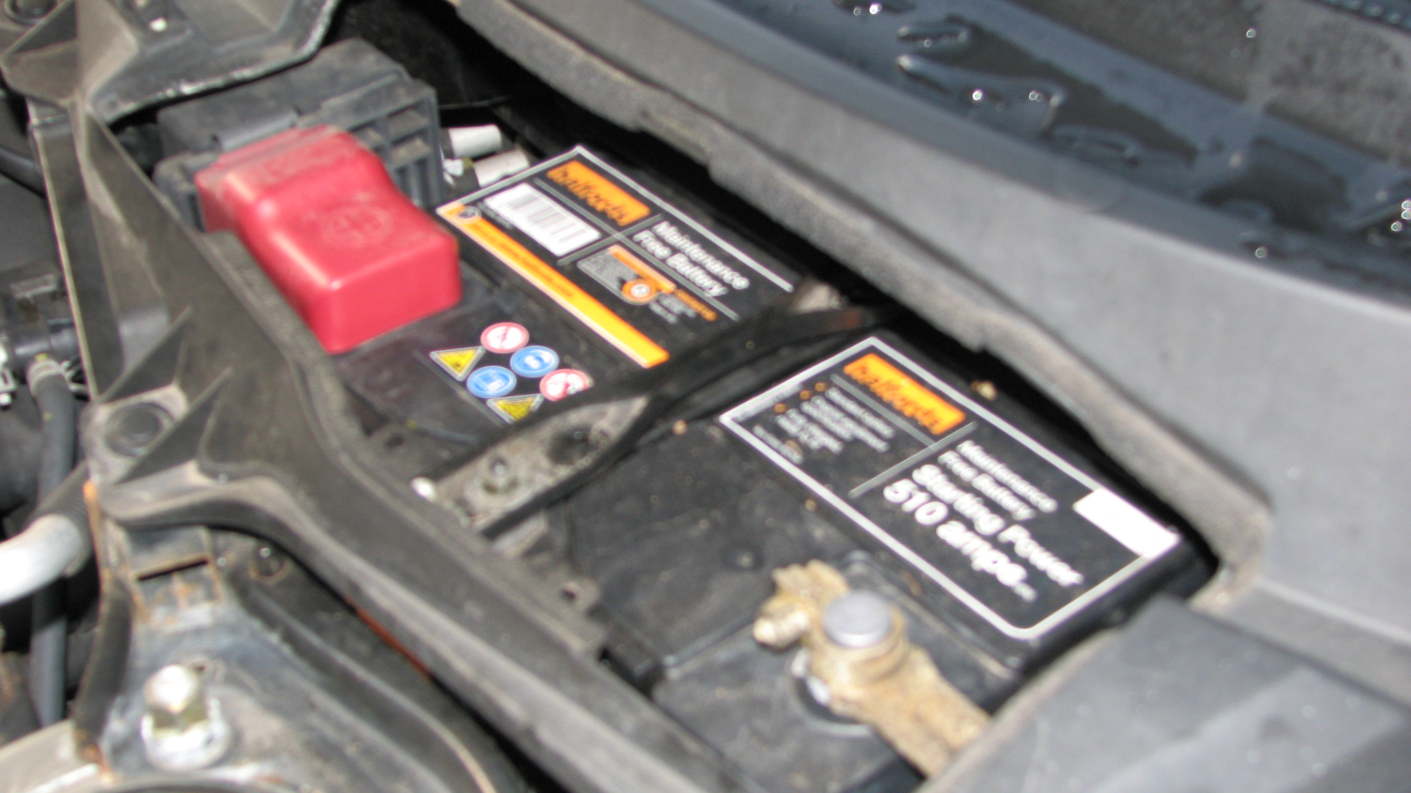

so if photographs of larger battery in wife's 3 door battery tray fitted by Anchorman very easily (as I was there too....) just shout.
Yes please, particularly interested in the three cables that go up to the distribution block and how they fix to the car at the suspension turret.
Phoateez herewith, Bob....if required from any other angle or mangnification, just shout.No comprendez what you refer to as "going to suspension turret", but this on 2004 model....has it changed...?
