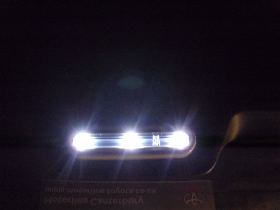

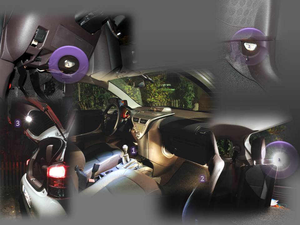

I have added three lights to the poor original LED-Interior light.
Number 3 is in the boot lid, so it gives light to the rear interior area and behind the car if the back door is open. The lines are fixed to the LED-Light. :clap:
I used old AUDI-10Watt /5Watt units.

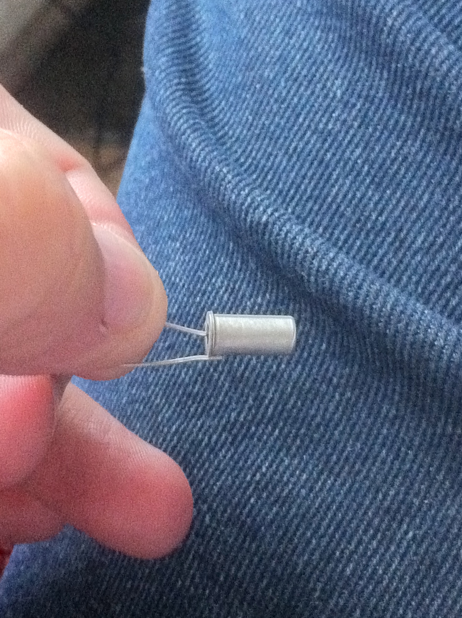

Thought might investigate the very small mercury tilt switches like Maplin's
Order Code: FE11M £2.79 which can easily be lost behind the rear wiper panel which can power some very discreet LED's in the rear seat belt pillar's/

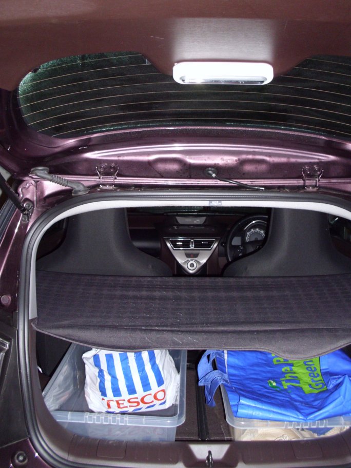

I think the solutions on here are not discreet enough for me. I am going to use a puddle LED at the top centre of the boot aperture and controlled by a told switch in the rear door panel. Cable to feed the switch will follow the route taken by the MR T rear camera through the rubber sleeve carrying the wiper motor cables.
A few plus points
1,This way no side doors need to be opened to trigger it
2, It will not time out
3, Be very discreet and operate as any other hatch light.
Can if required, be double fed from the interior light for rear passengers
Will check tonight if the puddle light is up to the job. As tilt switches vary in the amount of current they can switch LED'S are preferable. A 21W bulb draws 1.75Amps this would be too much for a tilt switch even though its in a vacuumed environment to prevent sparking and false triggering 1.75 Amps is asking a bit too much from it

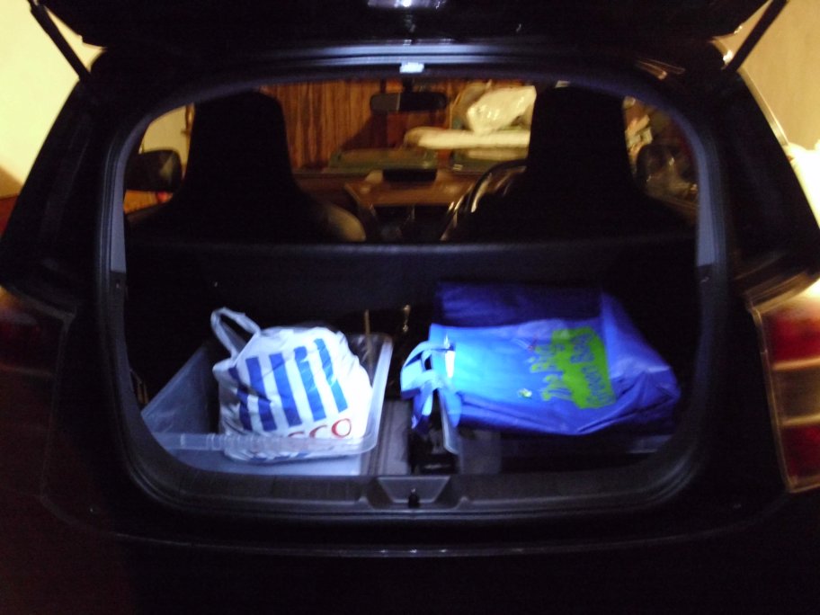

Hello All

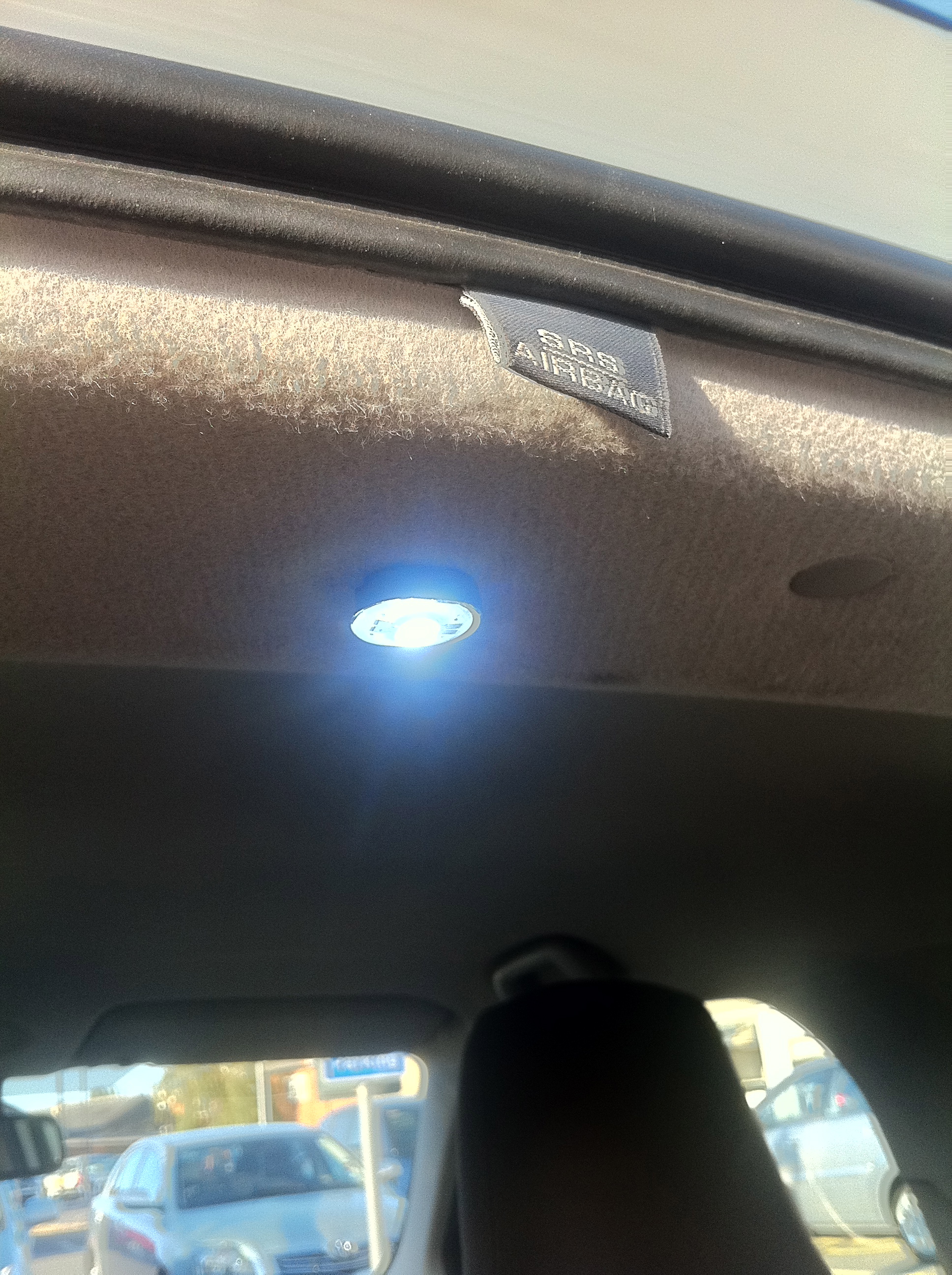

Slight change to the first idea.

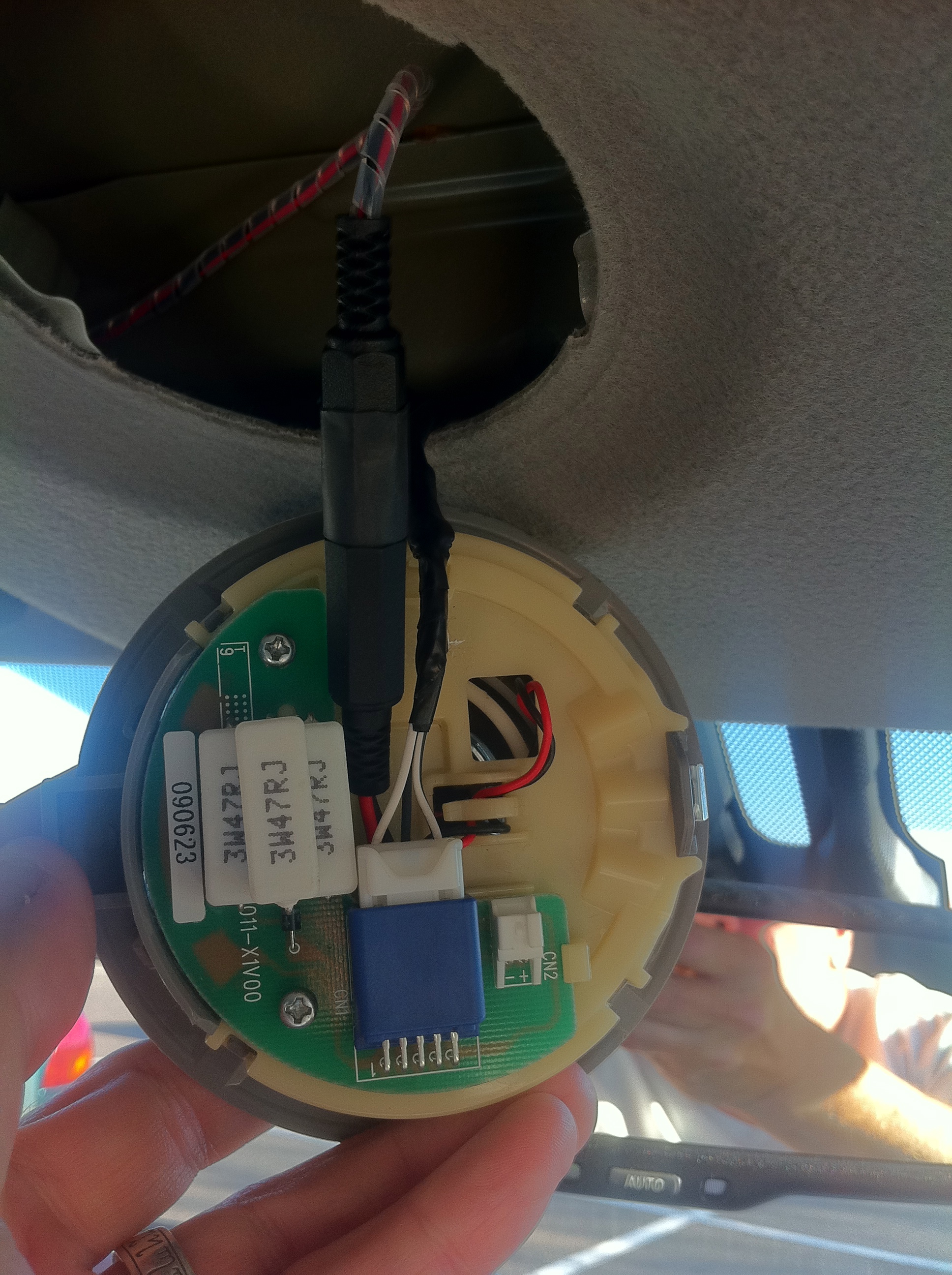

Inside the interior light there is a white plug with 3 wires BLACK (+12v permanent live). WHITE ( - 12v permanent ) and WHITE and BLACK ( -12v under certain conditions)

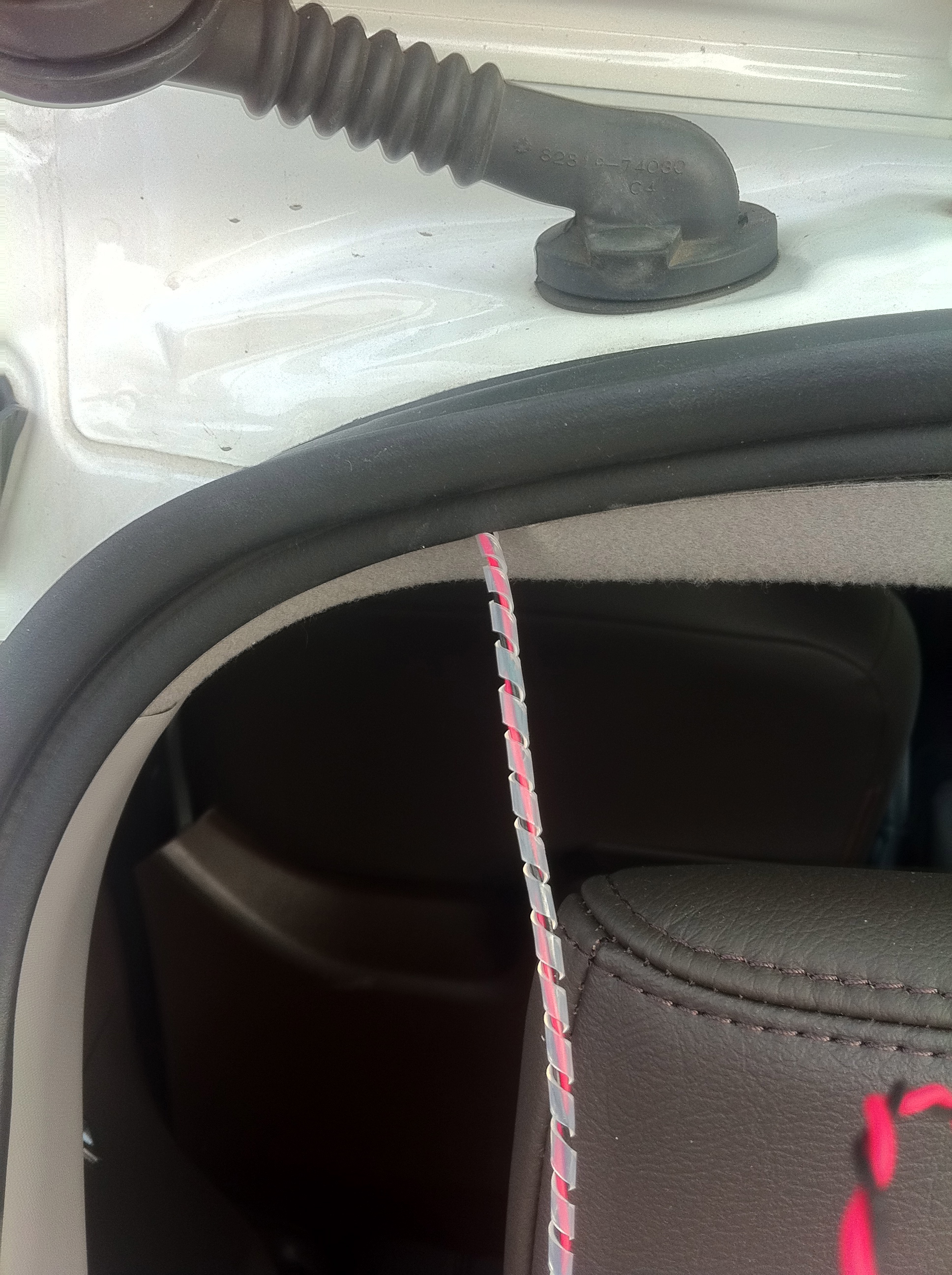

I found there wasn't any permenant + 12v live feeds in the rear door hatch so decided to run a wiring loom from the interior light to the top centre of the roof lining where it meets the hatch door,and where the tab of the curtain air bag sticks out.
I tried to run it direct using thick copper wire as a "mouse" but there seems to be some cross bracing members going across the roof.
So I peeled back the rubber surrounding the top of the passenger door and using the "mouse" got the cable to come out between the lining and the body Shell.Then using the mouse again, I fed the cable along the edge of the roof lining and body Shell to the rear. (picture shows where it came out).

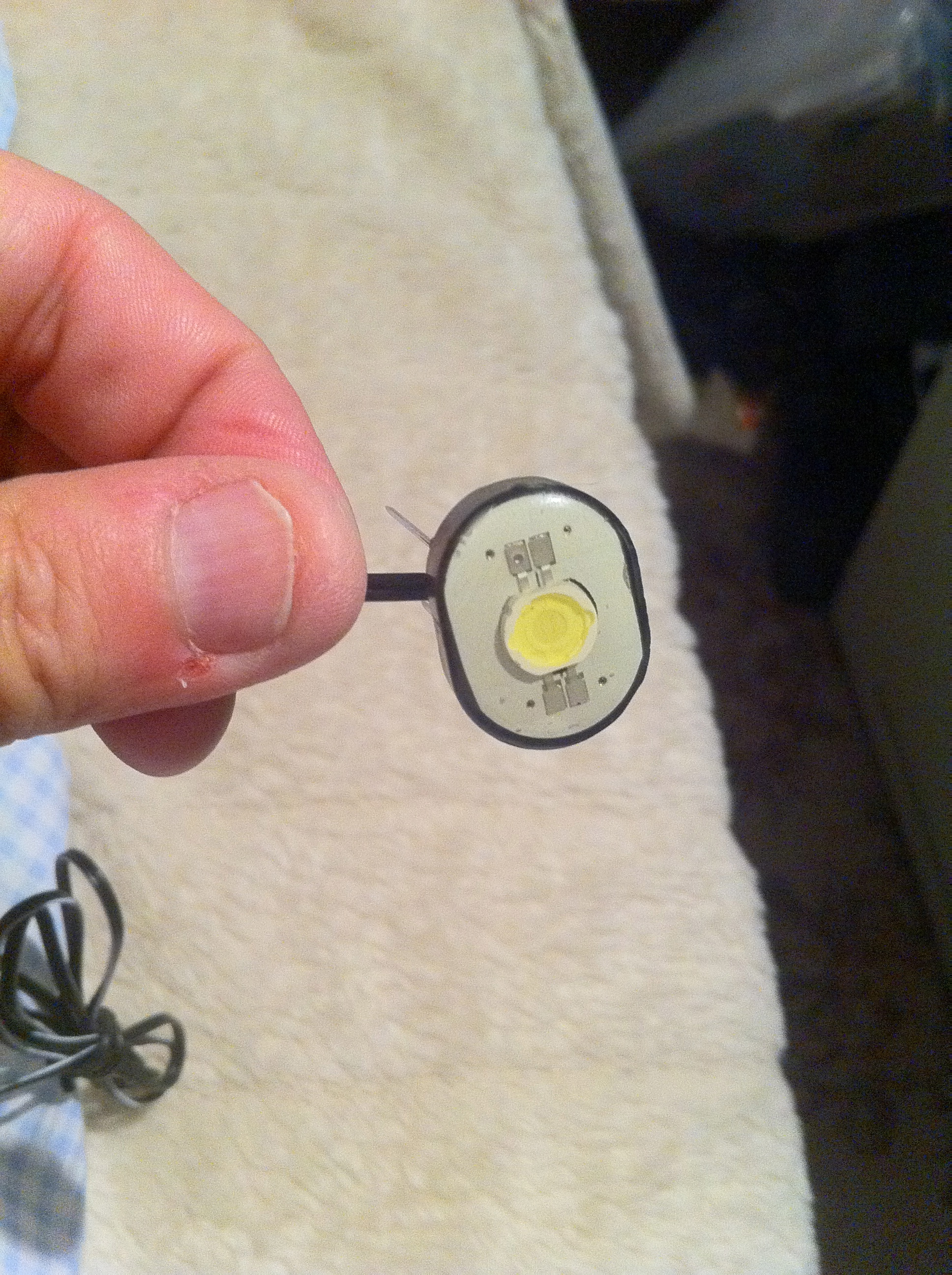

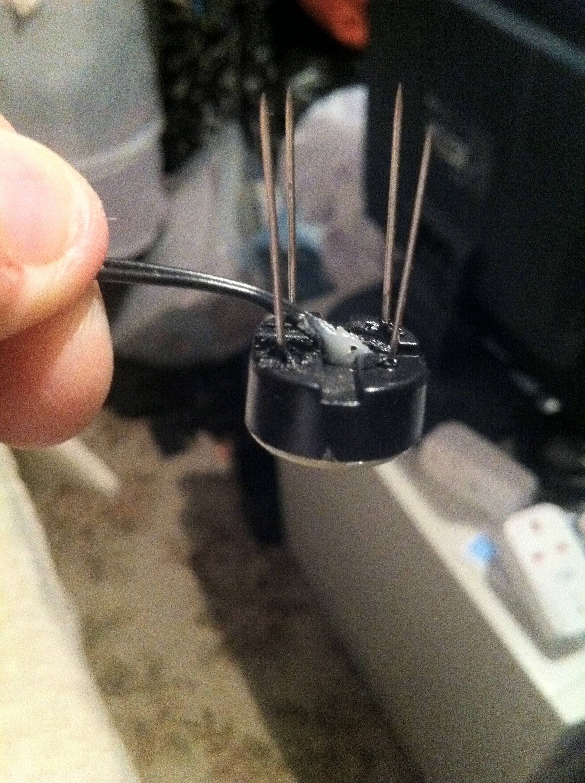

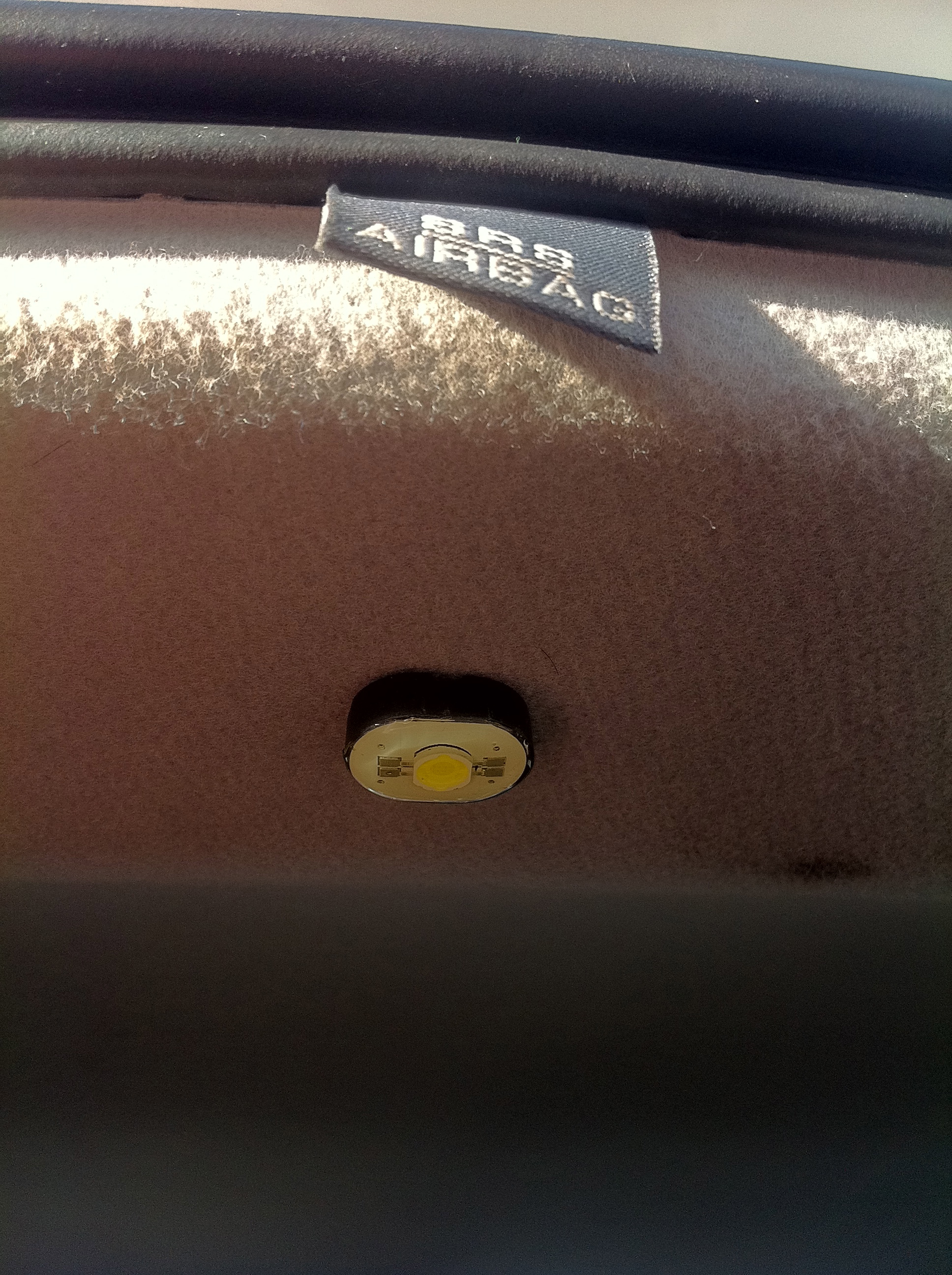

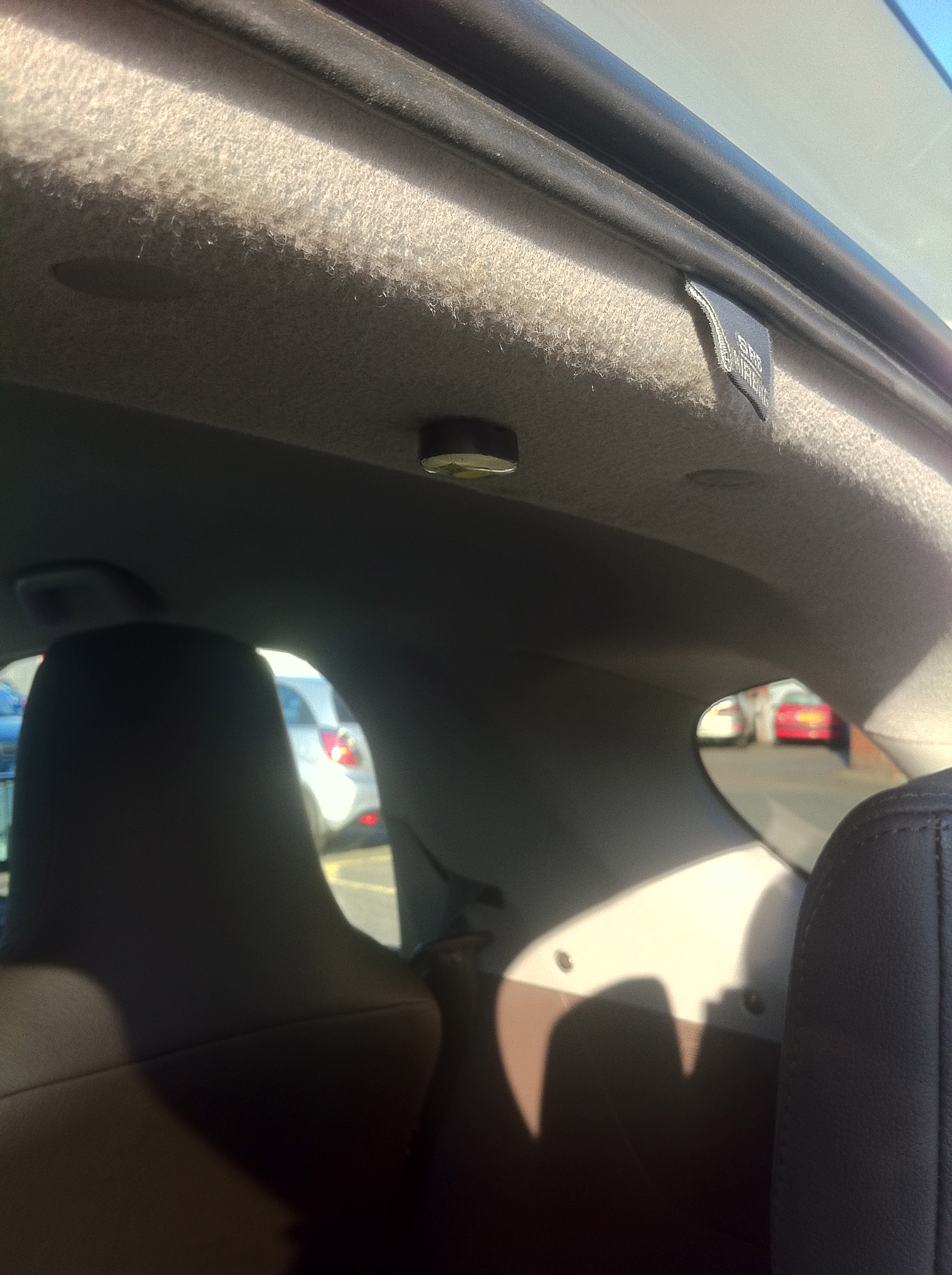

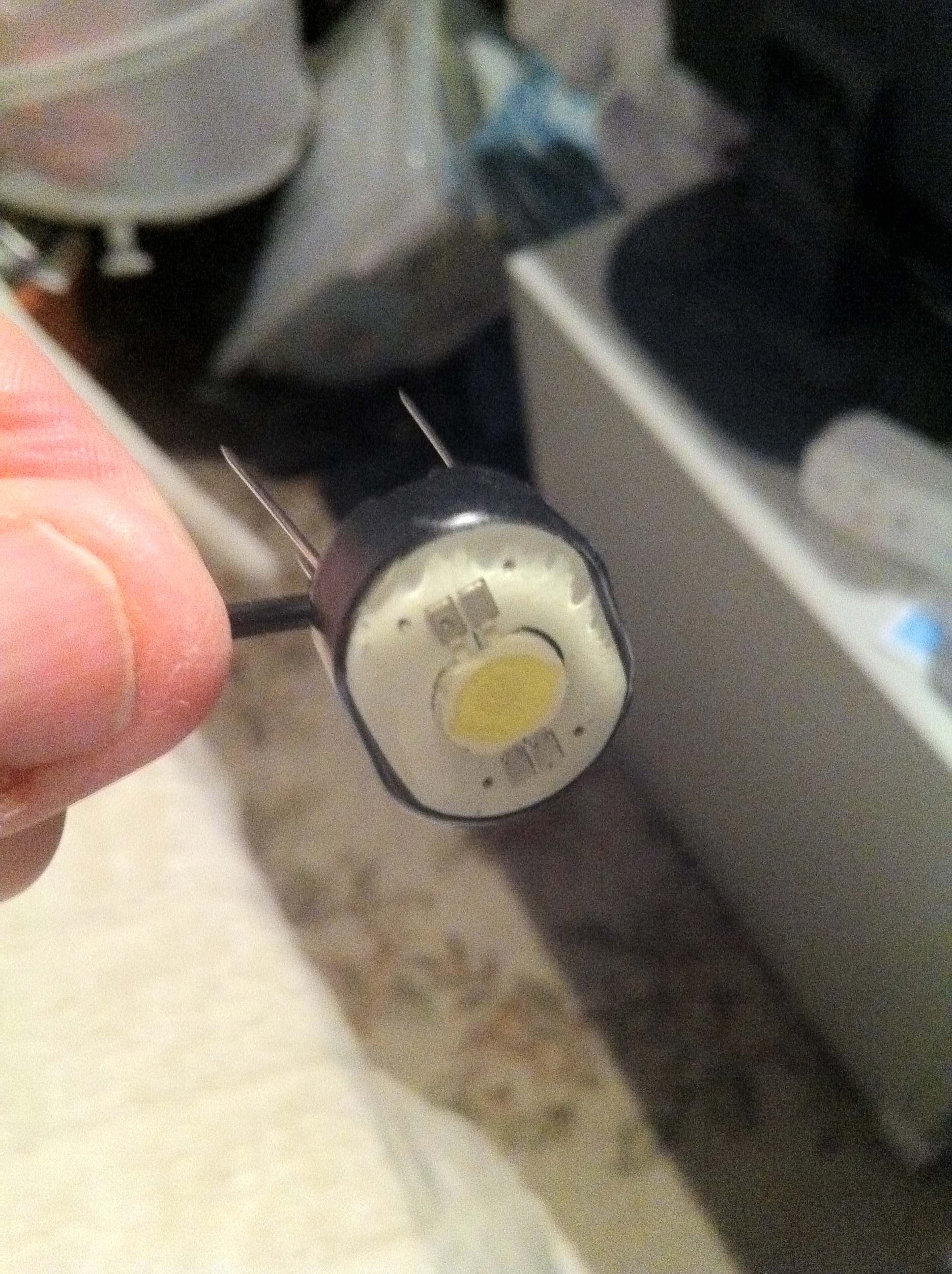

Using a Puddle light from Halfords, (the same as the ones I used as puddle lights under the doors) I melted 4 dress making pins (sharp bits outwards, into the bottom of the light so that it had 4 spikes sticking out from it, (as in the pic)
Finding the centre of the rear lining, I made a small hole in the lining and poked the cable of the puddle lamp through. Making sure that the pins didn't puncture the curtain air bag I pushed the lamp to the lining so the pins came through and I bent them flat, at the same time pulling the remains of the cable through.I Cut off the spikey ends of the pins then using thick Duct tape I covered the pins.
I soldered the Puddle light cable to the new loom cable and put heat shrink over them.
Fitted all the lining back.

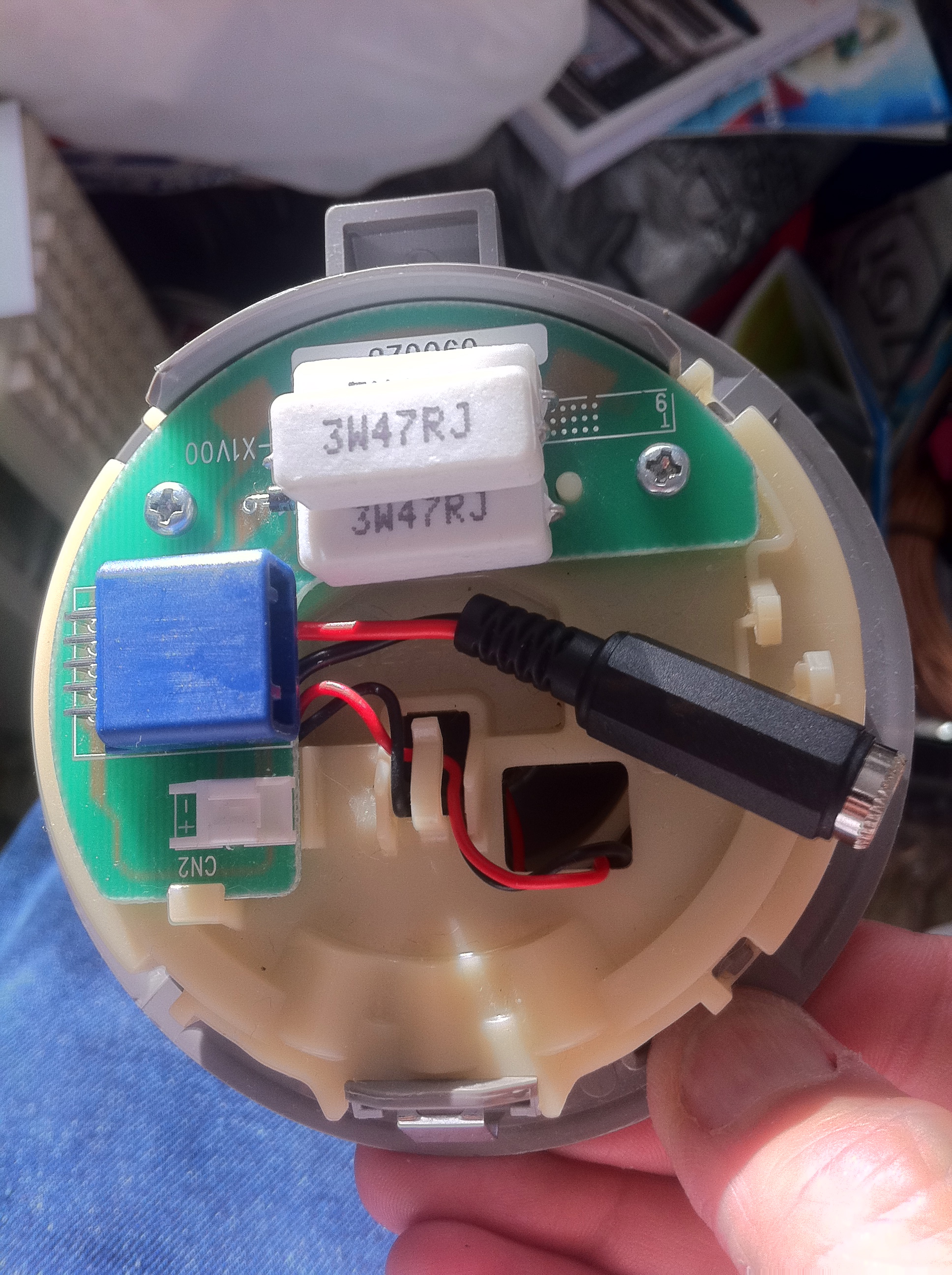

On the new loom cable that came out of the interior light fitting I soldered a 2.1mm DC plug (like you see on mains adaptors)
On the interior light fitting, I removed the 2 screws holding the printed circuit board on and turned it over. I soldered a short pair of wires onto the board. Red wire to the centre pin of the existing socket which meets the Black wire when the existing lead is plugged in, and a Black wire to the negative side of the existing interior light diode.
On the other end of the short lead I soldered a 2.1mm DC socket.
I then plugged the 2 together and re-fitted the interior light back into the lining.

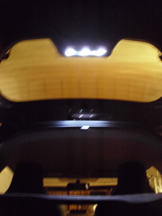

Now, whilst sitting i the car you can control both lights with the interior light switch, either switched on constant, or in door operating courtesy mode..I,e, when any door is open both lights come on for a short while ,and time out or go off when the doors are locked.
If you are going to be in the boot some time, simply switch the interior light to permanently on.
Works very well with plenty of light
Its the light that MR T forgot

Another little note.
I dont normally have the internal light switch switched to door mode. Using this position and with the extra boot courtesy light fitted, At night when you walk up to the car, both lights come on. The extra powerful front and added rear light, lights the whole car even before unlocking it or opening it. Its very impressive when with friends. It adds that safety at night feel about it especially in a lonely carpark.

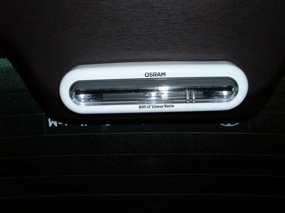

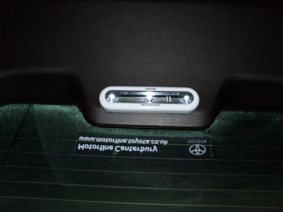

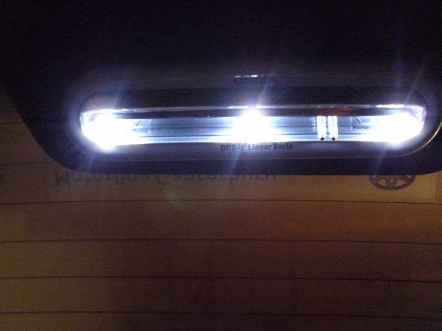

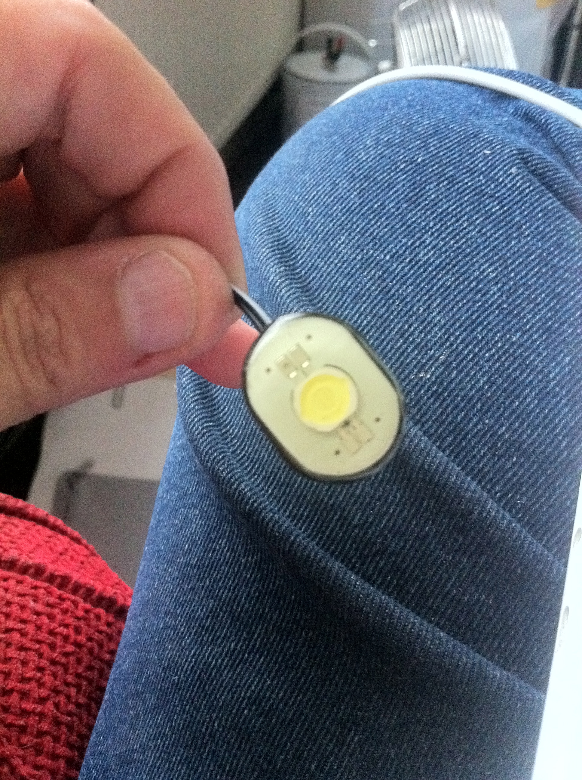

Using the ideas on this thread I found a new use for a 3 bulb LED light -called DOT-It Linear Vario by OSRAM- that has an adjustable/swivel, light, thingy. It came with magnetic, Velcro and Stick on mounts. I had already used the stick on mount so have in this case used the velcro type. I 'stuck' it to the plastic covering the area around the high level brake light (on the inside of the tailgate obviously). To switch it on requires you to brush the two 'prongs' with a finger/thumb tip for On and Off. One issue with this is to remember to switch it off when closing the tailgate. Photo's attached for visual reference. The light seen through the car windows is from the car port light.
post-113536-0-98171600-1322003510_thumb.post-113536-0-89926600-1322003524_thumb.post-113536-0-04249200-1322003537_thumb.post-113536-0-14781000-1322003553_thumb.post-113536-0-82564900-1322003564_thumb.post-113536-0-66168200-1322003579_thumb.post-113536-0-96359200-1322003589_thumb.
Hi bob
That looks like a nice unit i guess a few people on here would like one of those. Maybe you could post a link where people could get one. It fits really well in that location well done good find
David
