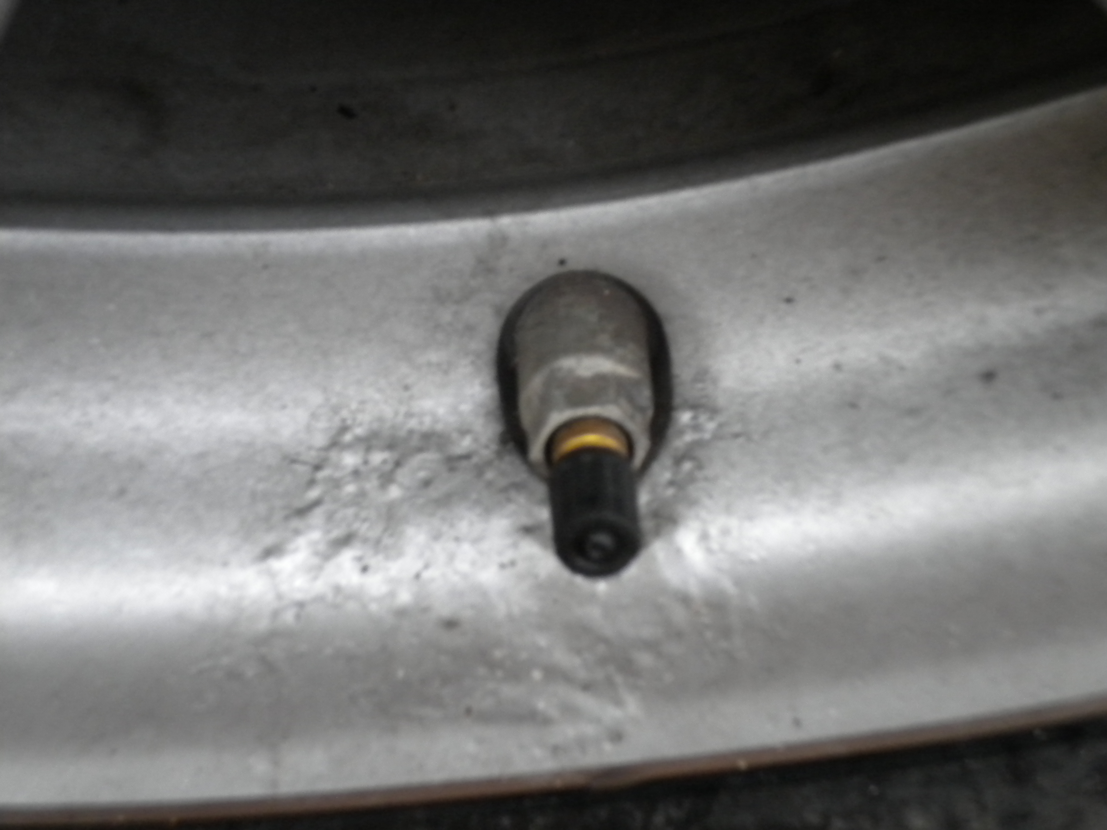

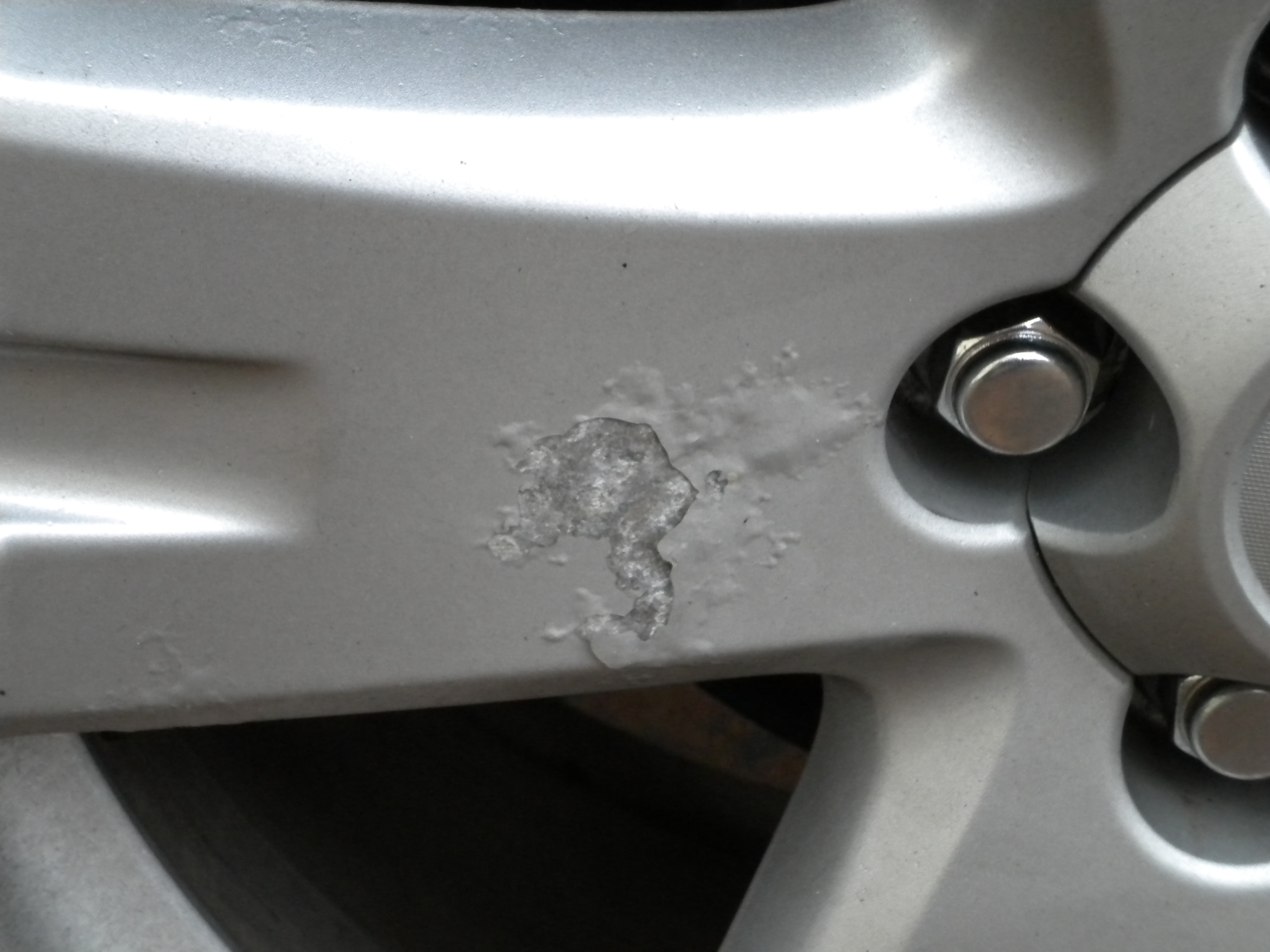

Yeah iam also glad of Briggs service. Thats who managed to get me 4 x (prestige refurbed) toyota alloys & when fitting also found corroded aluminium tyre valves replaced them via toyota customer relations too I only paid for 1hr labour & two alloys. Total £307 for the four alloys & two valves plus fitting. So they must of had ear of Mr toyota.
