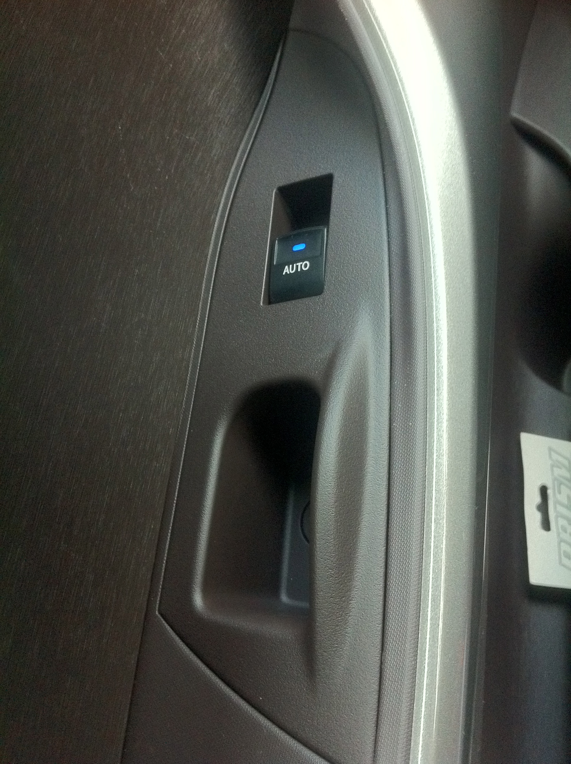

Hello All,
Do you own a pre 2010 iQ? Do you have trouble closing your doors from the inside by pulling the chrome lip housing the tweeter speaker? Well on the new 2010 model onwards MR T changed the inlay panel which holds the window switches and incorporated a hand pull cup which by its location is further along the door giving you more percentage of the door to pull and aids closure
You can order replacements for both sides for about £26. The 2010 onwards model has a screw with a cap to tighten it in place in the centre of the cup. This is not needed and if you replace the panel in a 2009 model you will find there isn't anywhere for the screw to screw into anyway. So all you need to order is the panel and screw cap. The existing panel is easily removed with either a trim tool (Recommended £11.99 from Halfords) or a thin knife. It just pops out. The switches are removed by pushing back 2 little clips (obvious when viewed) The two pictures show before and after although it shows one from one side and the other from the other side as I am still waiting on the drivers side.
If this is something you would like to do and need more info or detailed pics of the stages , just ask. Total time per side to do less than 1min

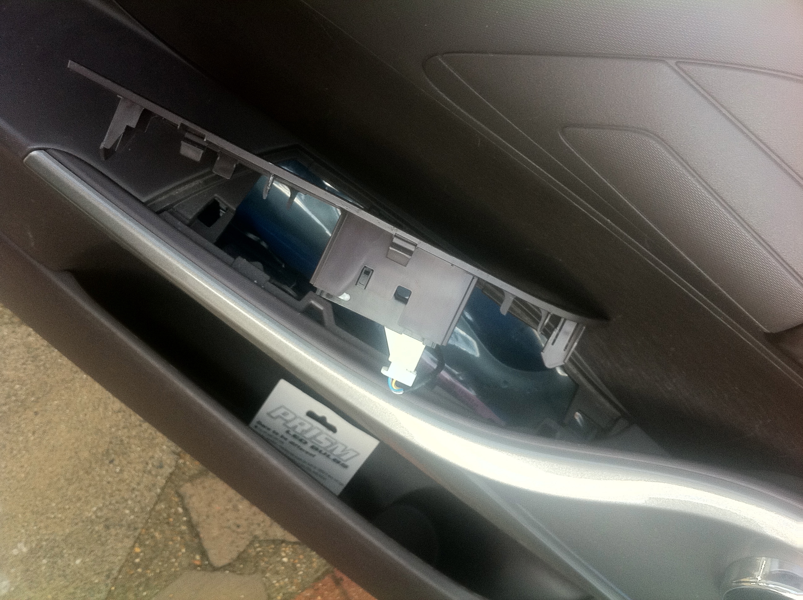

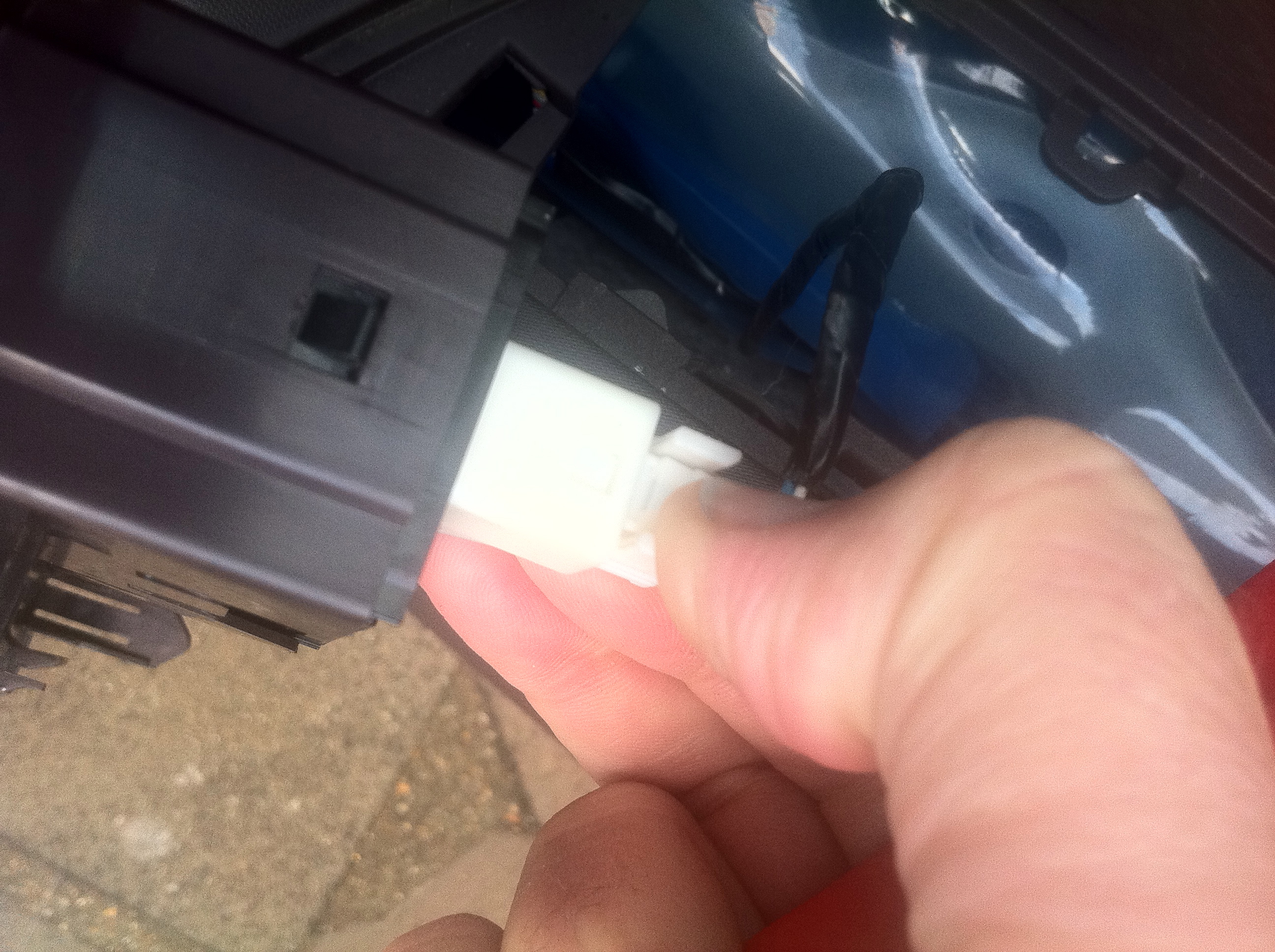

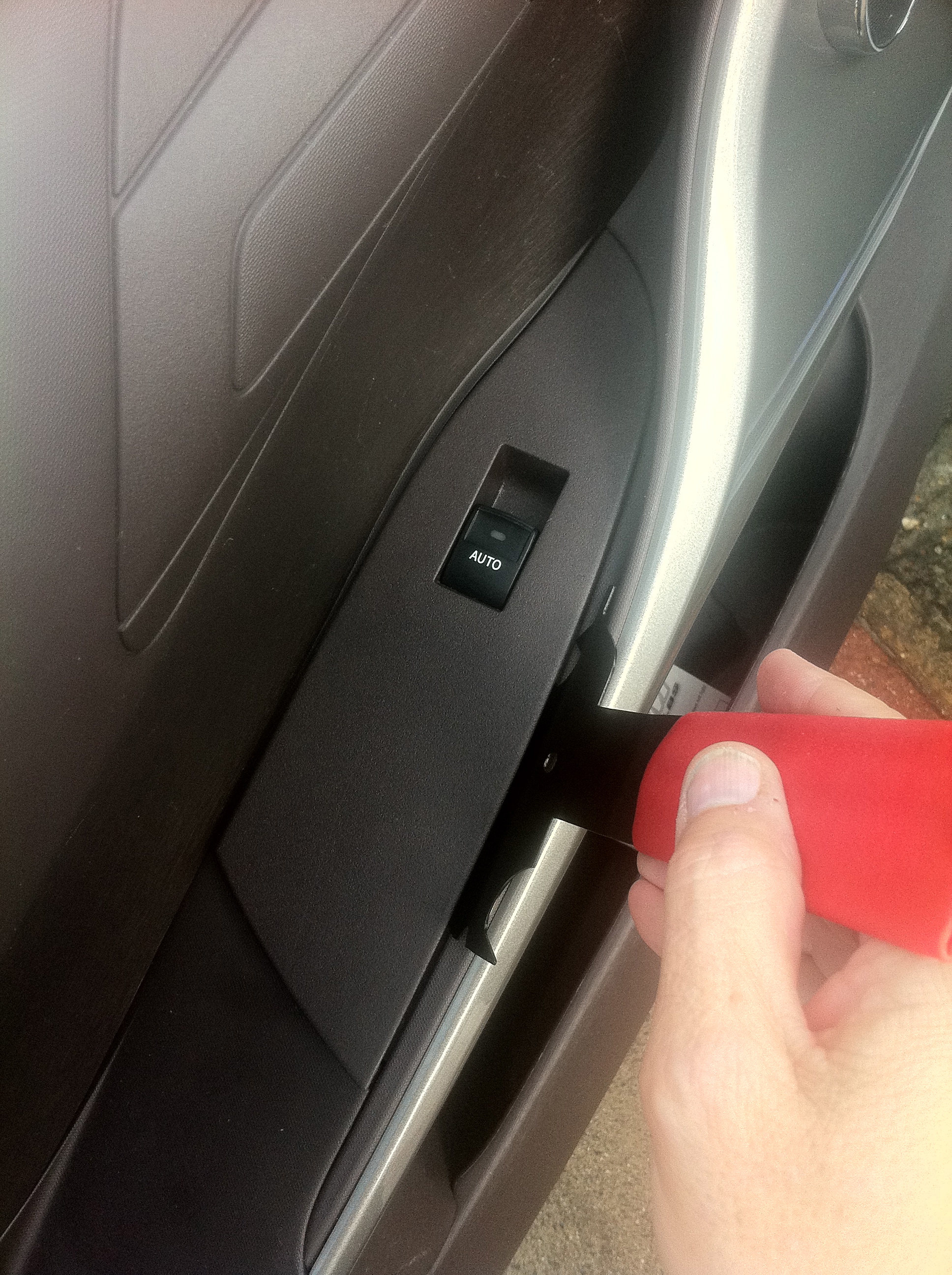

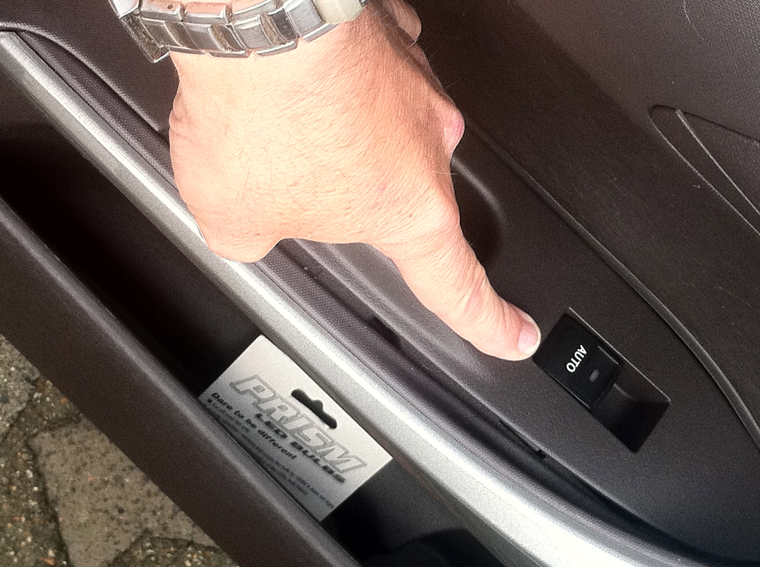

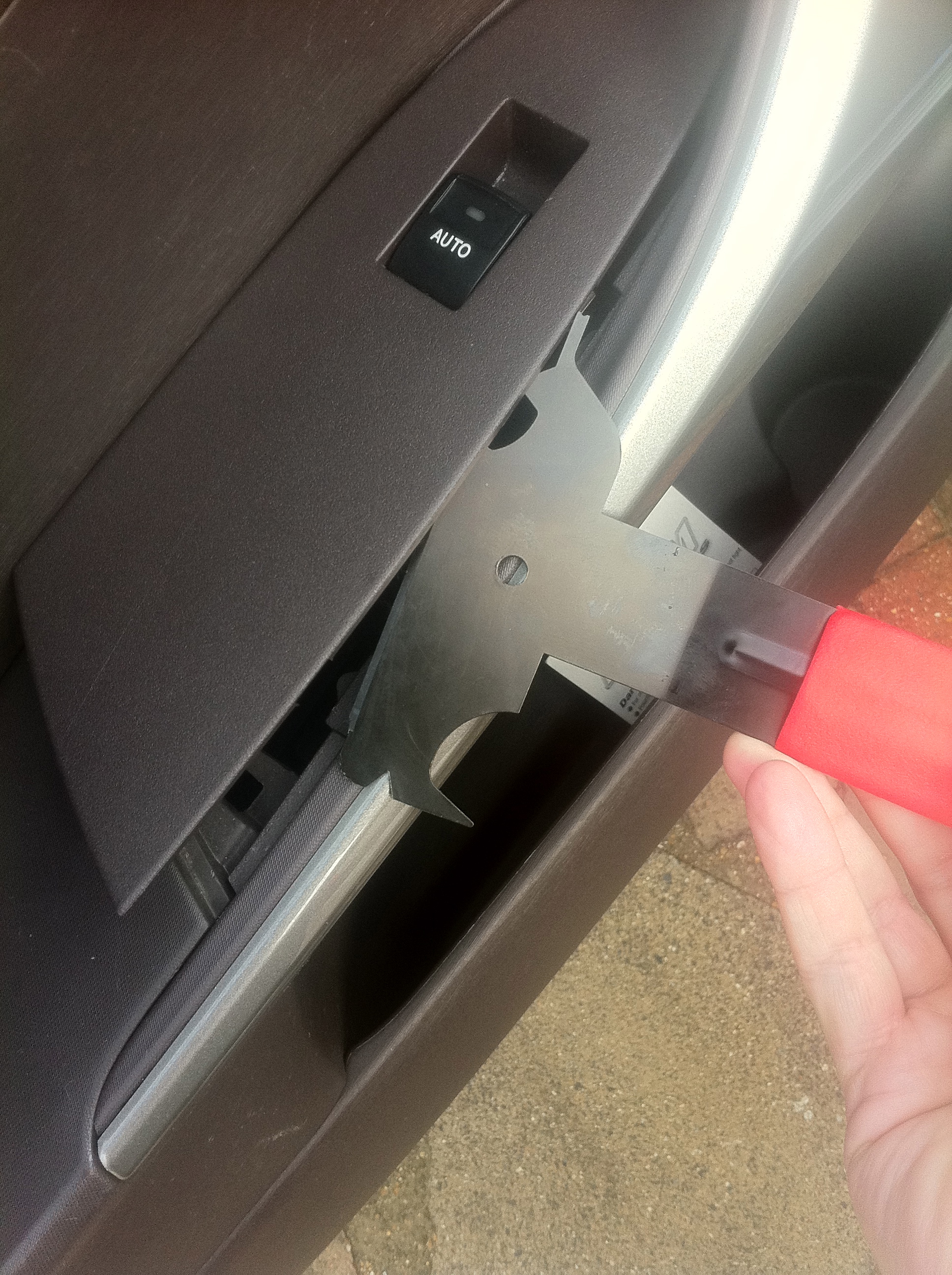

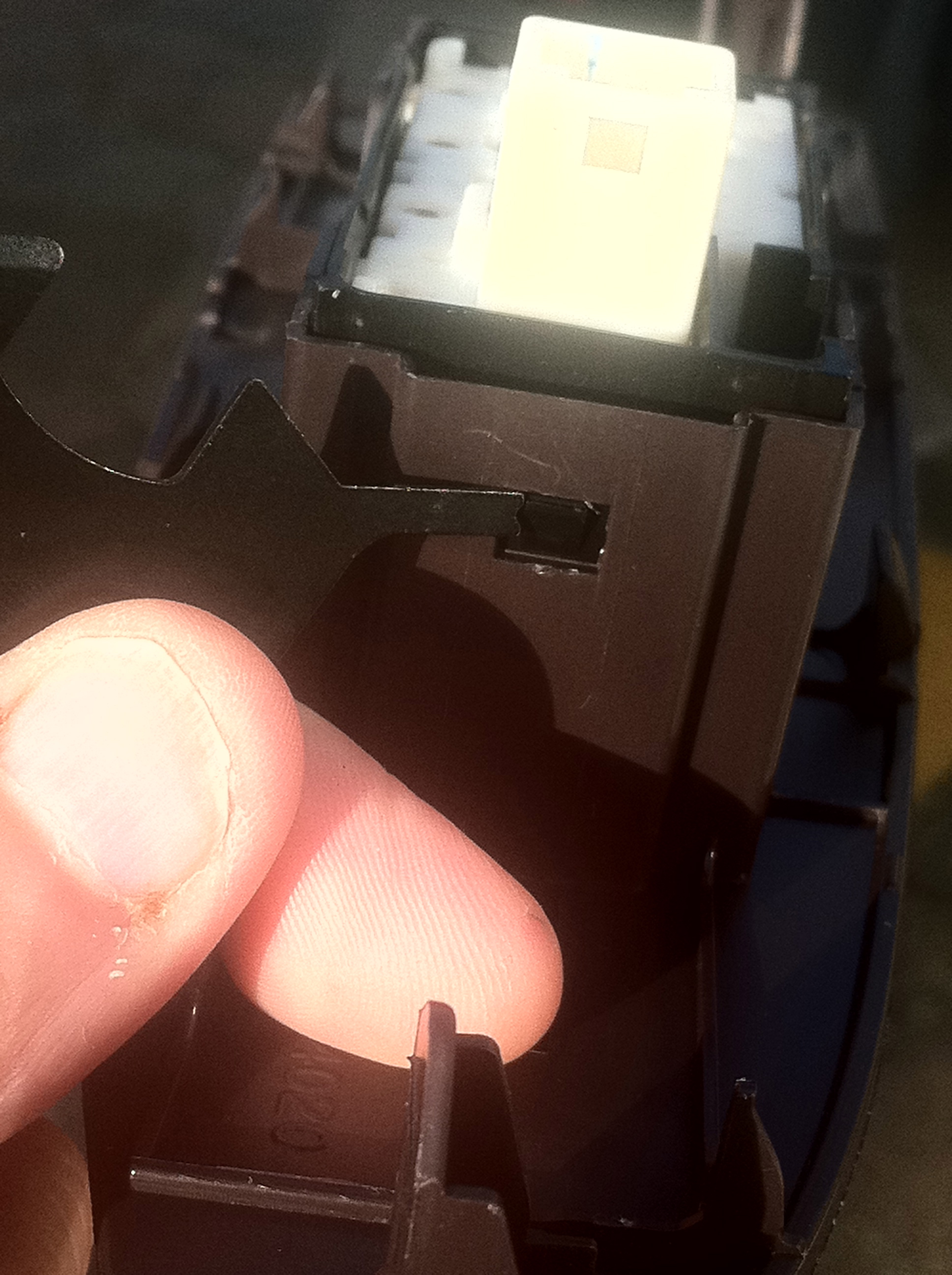

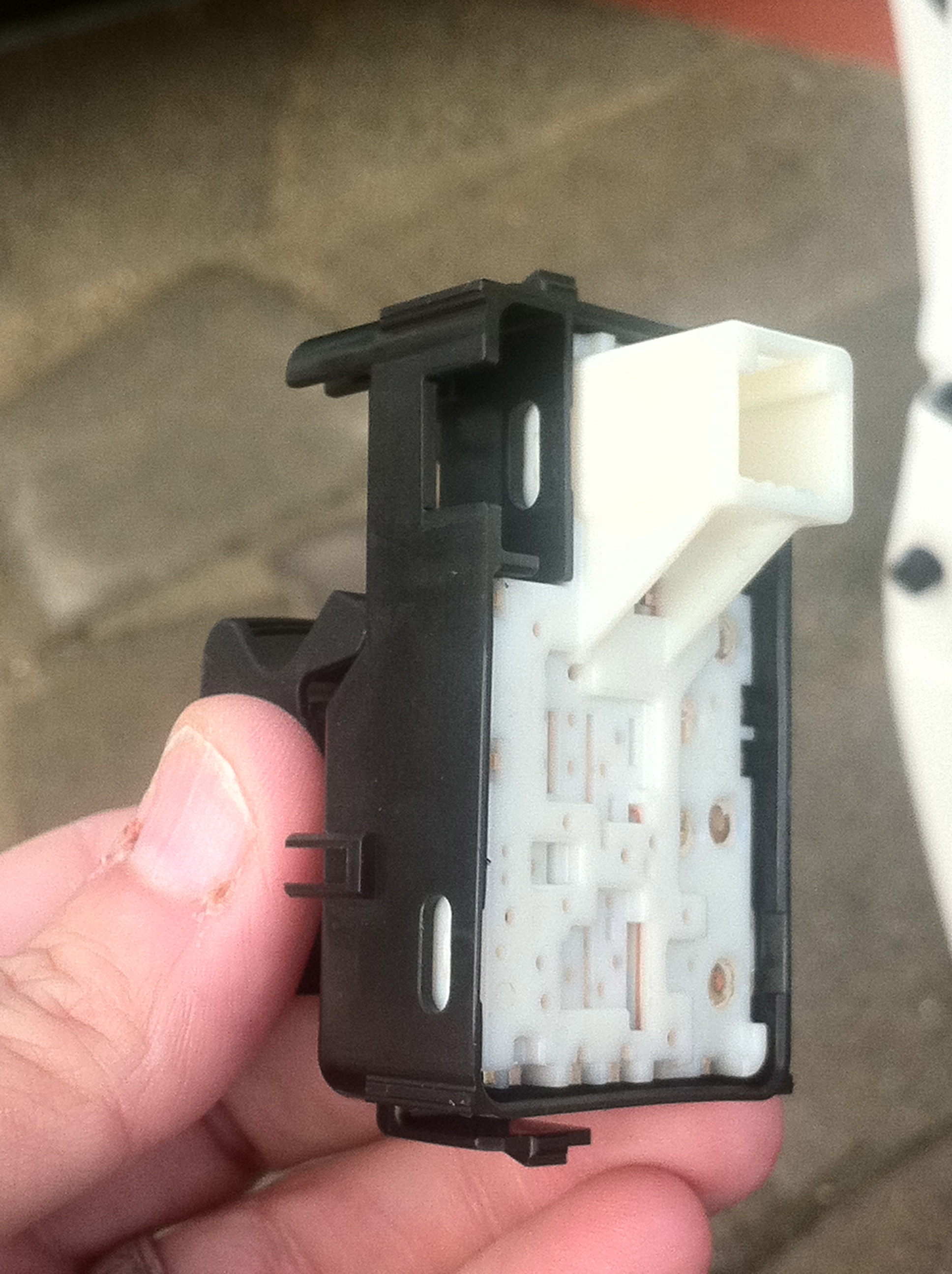

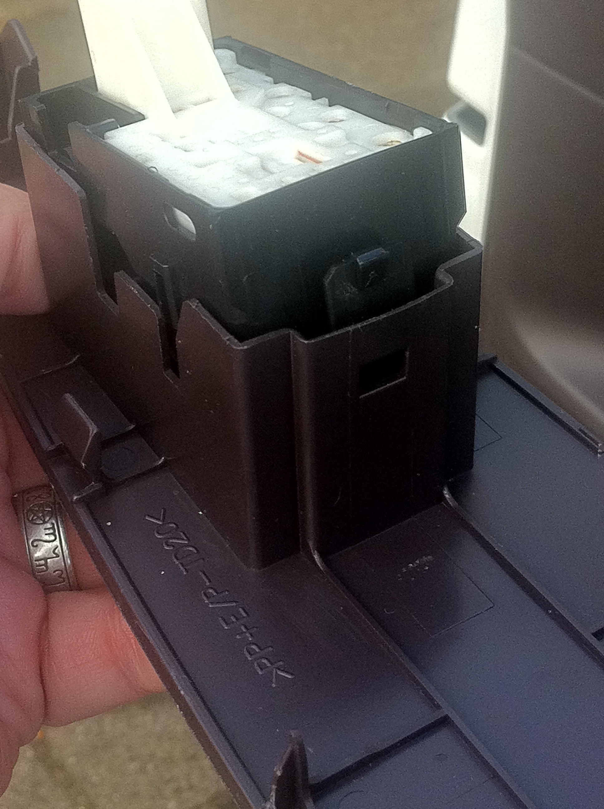

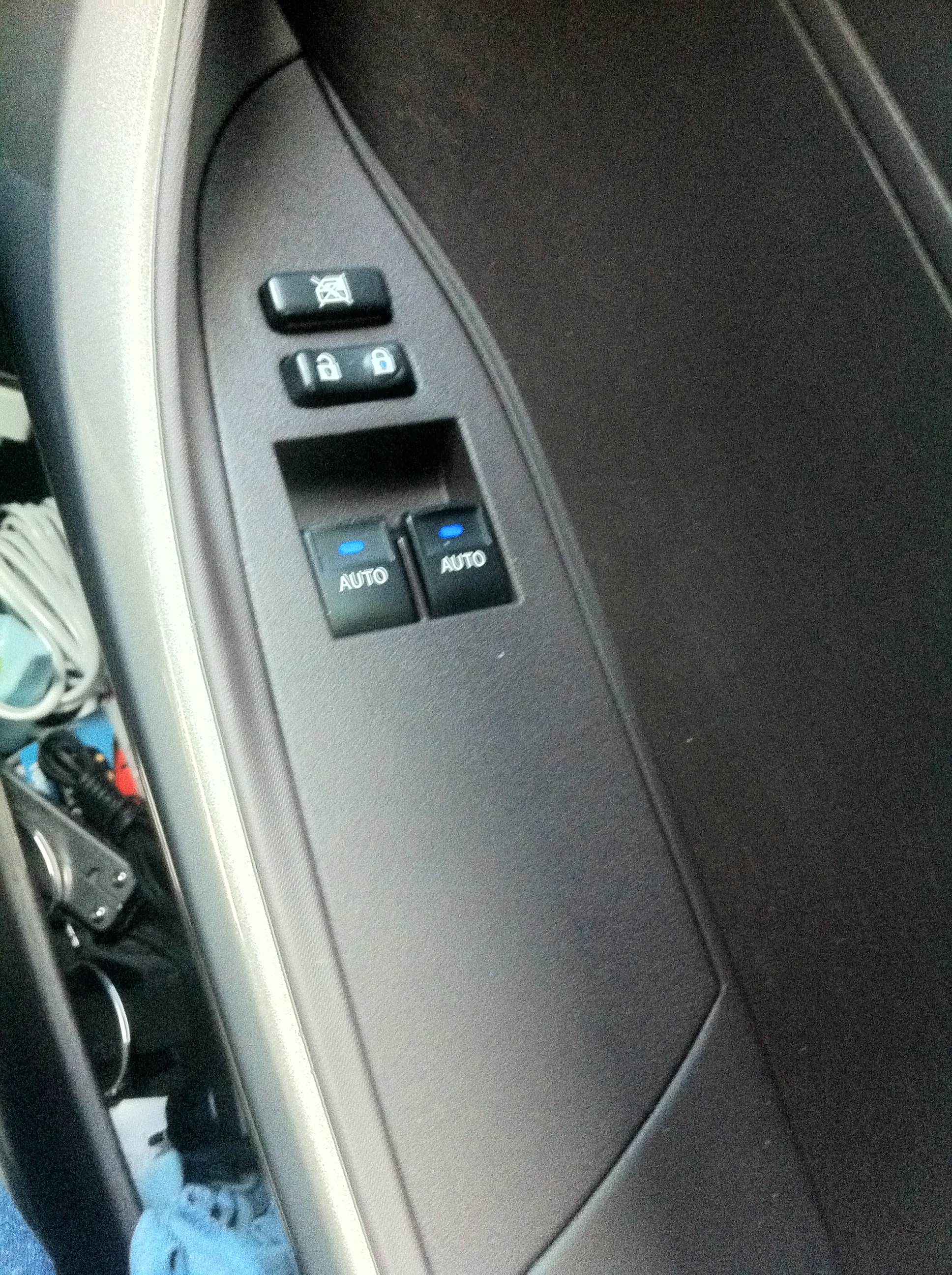

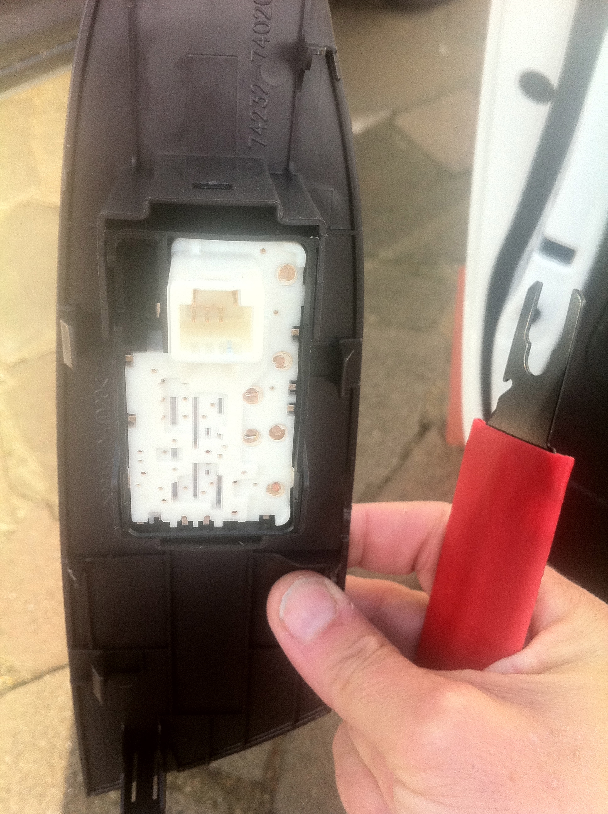

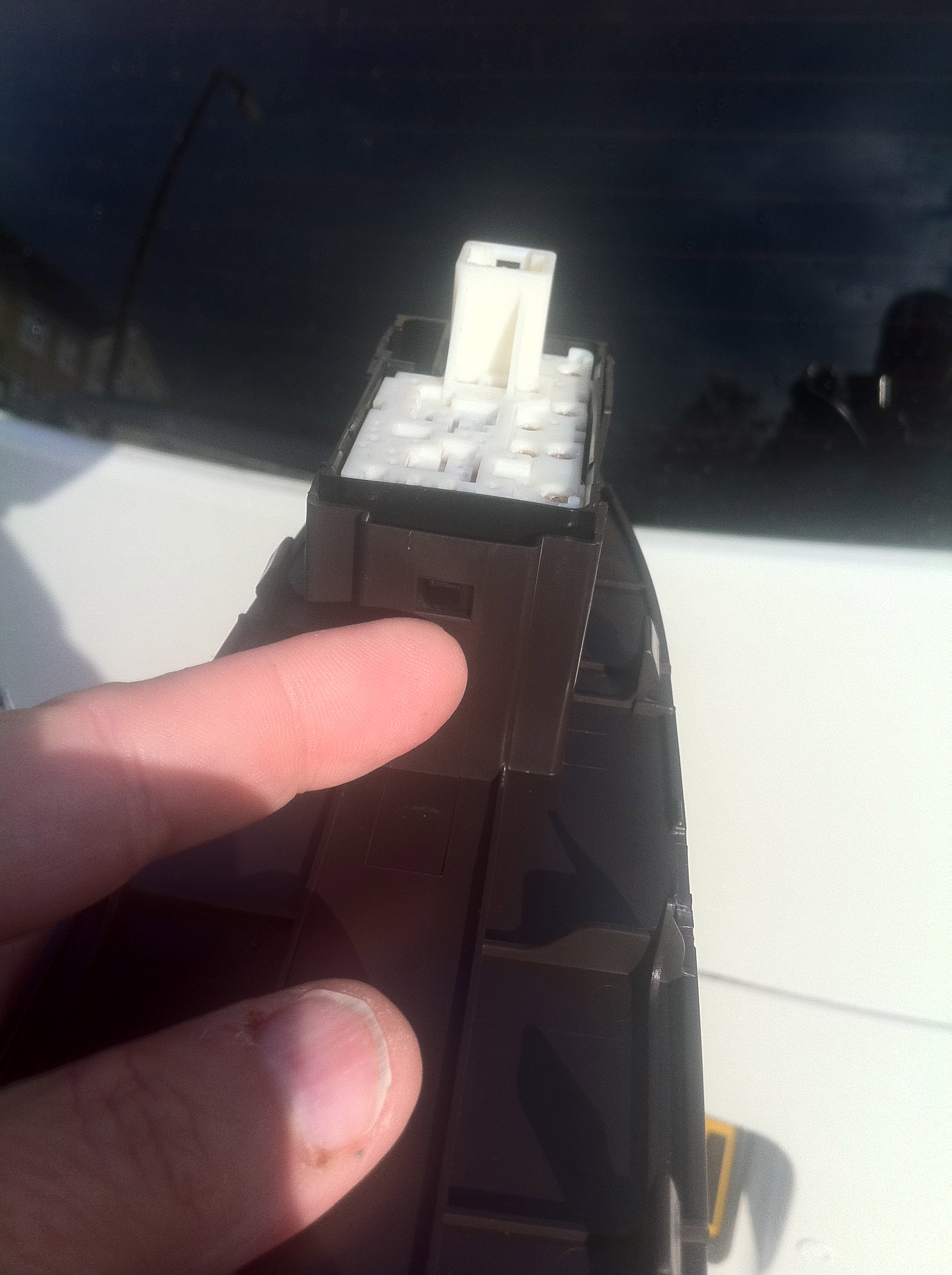

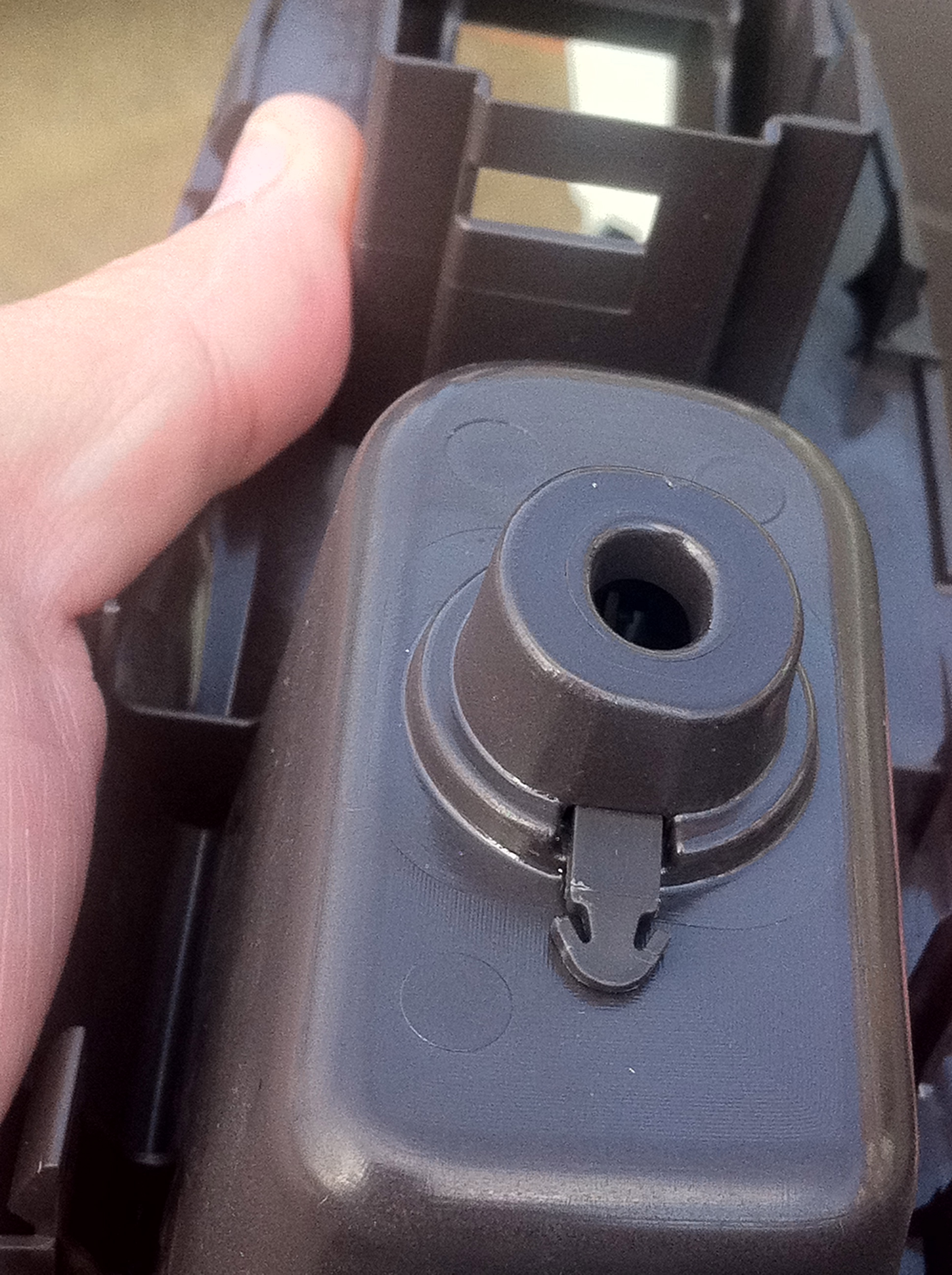

Ok Here we go
First you will need to get either a "trim" tool from Halfords for £11.99 or a thin fairly wide (about 2 inches) blade. Maybe a paint scraper. but be careful of the sharp corners so as to not dig the plastic. You could use a butter or cake knife. Don't use a flat screwdriver because it will leave dents either side of the gap and look awful. You need to prise it in the thin gap of the panel you want to change out and the chrome handle. If it seems too tight, Grab the edge of the chrome and pull it towards you,the gap will widen.
You then simply lever the panel out. You will hear 3-4 clicks as it gives way.If it looks stuck one end , just pull it.
One out you will see where all the clips are so can see where to push down on the new one.
Un-clip the white cable by pushing the tab in. Now using a small screwdriver or pointed thing, push the little tab in the switch at both ends, and pull the switch out at the same time. Y can do one end at a time..
Simply click the switch into the new panel. The screw cover plug is fitted as in the picture. It doesn't do anything other than cover the screw hole (the screw is not needed ) and there isn't provision for it on an older door.
Re-fit the cable and offer the panel back to the door and simply push into place. Done!!! The description sound "Wordy" but in practice is very easy and would have you 2min a side max
David

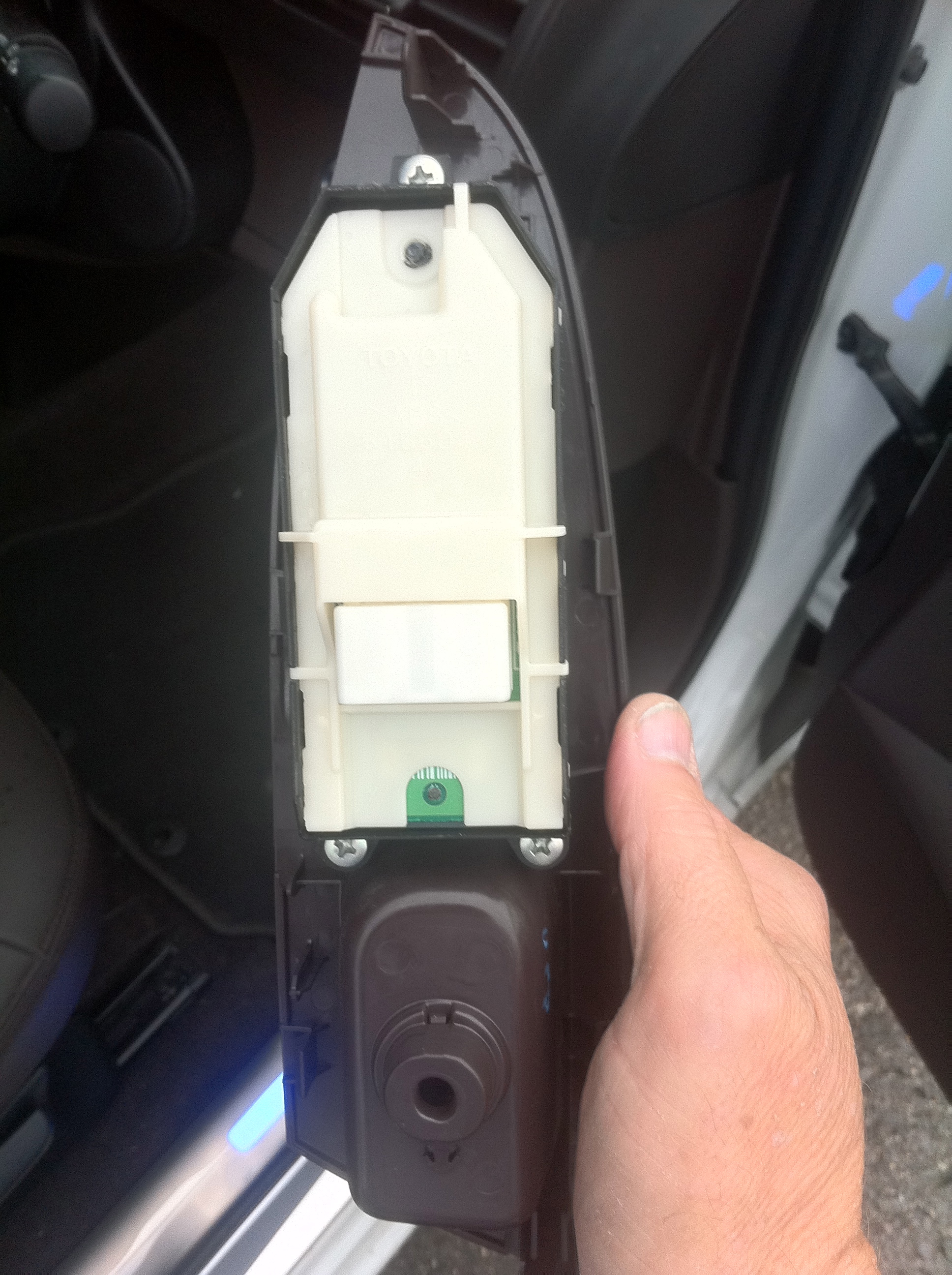

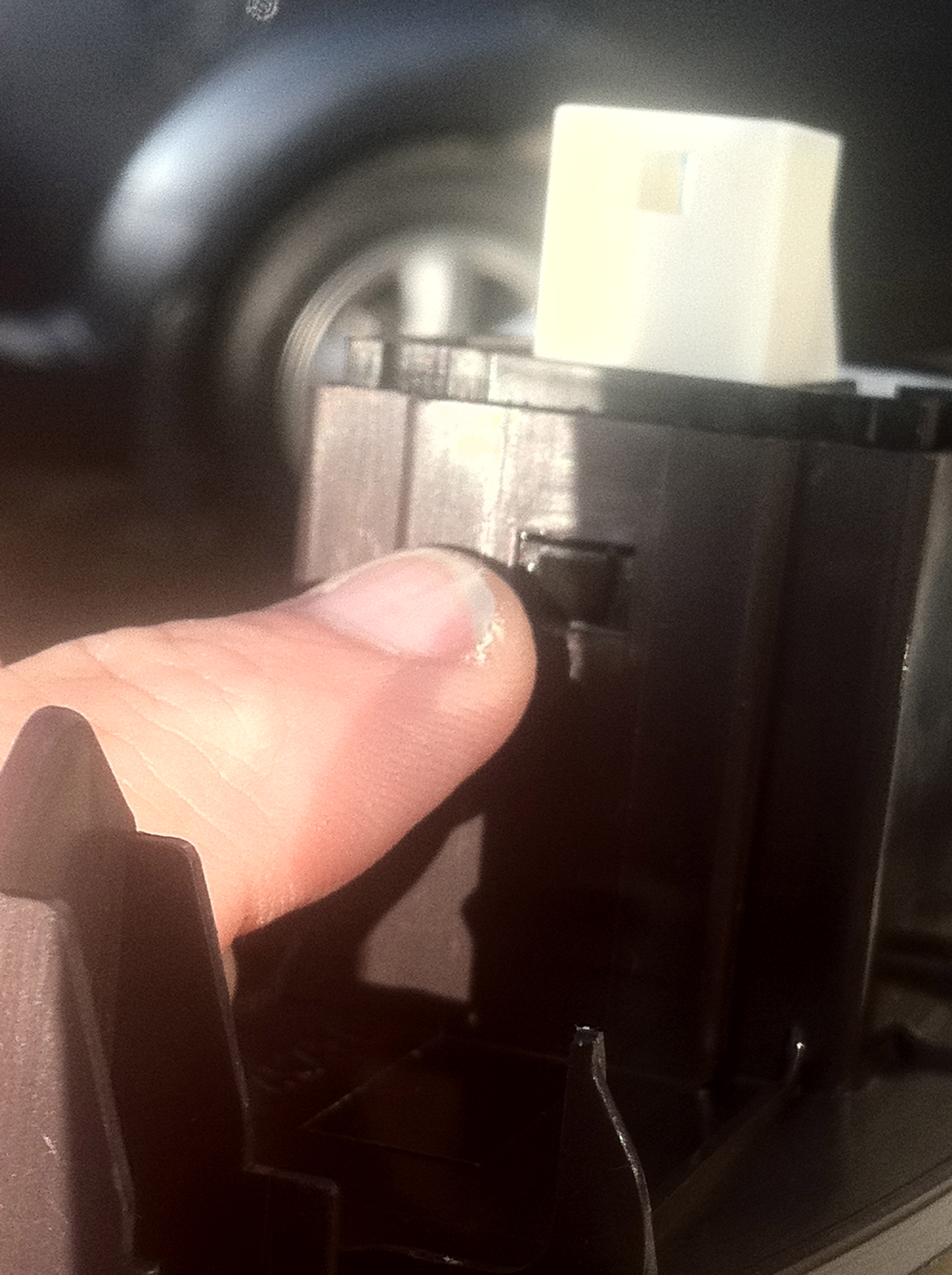

An up-date for Nick Ironpytite
I picked up the drivers side panel today and when i removed the old one I remembered that the drivers door is easier to do as the switch assembly is held in position by 3 screws as in the pic. Don't try to prise the white part of the switch out of its holder. It does come out if you cut the head off the plastic rivet and prise all the way round but you don't need to do that, take the whole thing off with the three screws. I took the white part out of mine because I changed the LED's to blue.
David
post-109788-0-17834800-1319703735_thumb.
David
