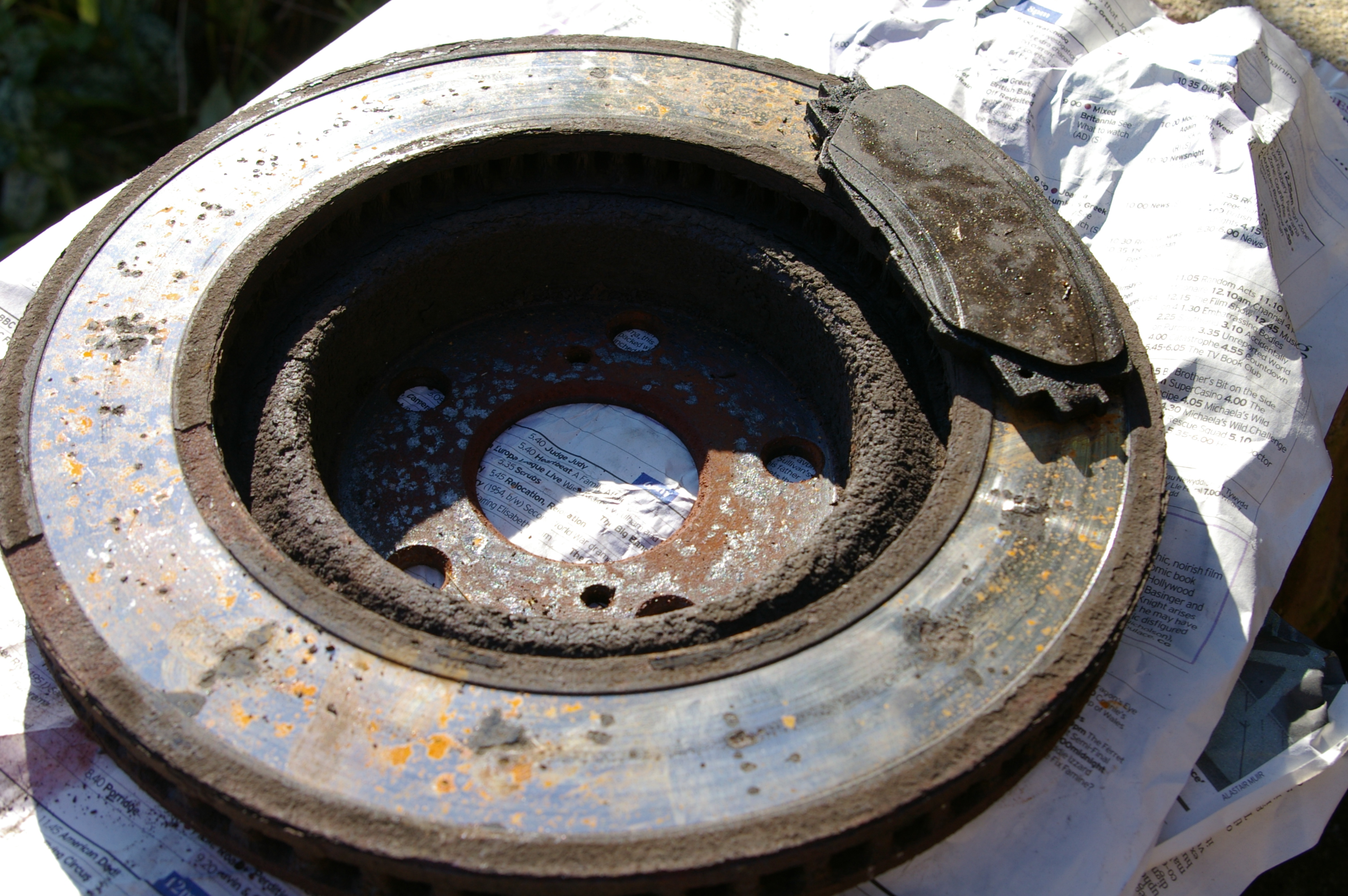

Not original pads by the look of them, about 56k on the clock, what is of concern is the uniformity of the wear on both sides. going to remove the disc this morning (rain permitting) will take some pics and post them
here are pics as promiced disc badly pitted, exactly the same both sides, MOT garage (reason for brake check) says one of the worst they have ever seen

I've seen dozens with a similar wear pattern but I don't recall seeing that pitting - trust me when I say I've seen hundreds it could well be thousands.
I wonder if that was a poor casting.
I too have seen that wear pattern on many cars inner discs, I just presume its normal? Maybe because more force is being asserted to the center of that pad as its the one that comes in contact with the piston. As opposed to the other side which spreads the breaking force nearer the outer side of the pad via the caliper....if that makes sence?
But that pitting is terrible, I would be replacing thoses discs ASAP....
As there vented do you think they could have rusted from the other side?

Dead easy, Dee.....hold them up to the light....? Unless you need car for work on Monday, Goldie, I would VOR until replaced....good wan from Jedi though....looks like they have perished from inside out....?

I take it the discs are the Toyota brand. If so it doesn't surprise me in the least as their quality has diminished to what is barely acceptable.
Pitting as shown in the photo is due to poor quality metal spalling when water droplets hit it when hot.
The rust on the edges is not uncommon on poor quality or poorly designed brake components or on high mileage discs.
Go get yourself a decent set of pads and discs - anything but MrT's rubbish.
The bean counters strike again - lets make more profits at the expense of the poor motorist.

In fact the discs that Mr T sell are excellent quality. When assessing disc quality there isn't much to it. Plain old grey cast iron with a brinell hardness of at least 200 and some control over titanium content and the rest is down to machining. In the latter respect that probably accounts for most of the cost as Mr T's discs are ground and not turned.
The problems come with the friction material and the way they deposit (transfer material from the pad to the disc) in some cases. On my last RAV the problem was solved and the discs were in perfect condition. I have also noticed on other Toyota models there is no such problem. Where pads have a high abrasive content they will keep the discs clean - the European manufacturers use lots of abrasive (have a look at the discs on a BMW, Audi or VW, they gleam). The !Removed! are very conscious of black dust and the abrasive content is down but they are coming round to our way of thinking. Good move on their part as our fomulations are about 1/8 of the cost of theirs.

The wear grooves are not untypical but the pitting is.

replaced with a set of unipart blue print (Jap produced) discs £60. Pads £30 the originals were Toyota (part numbers still visable) just over an hour to change both sides have dropped a disk in to local toyota dealer with a strong complaint, not holding my breath over them coming back with a guilty plea though :wacko:
