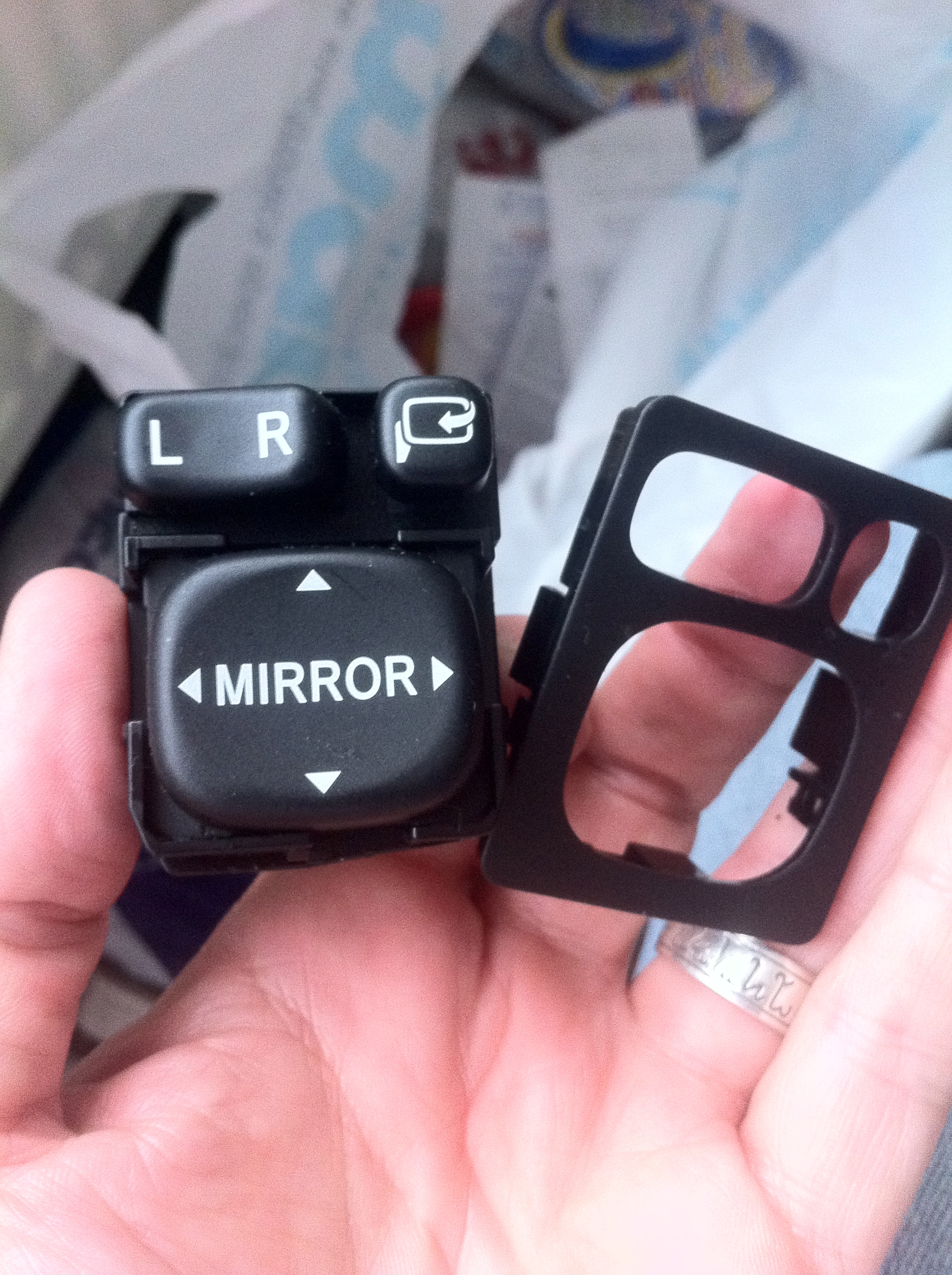

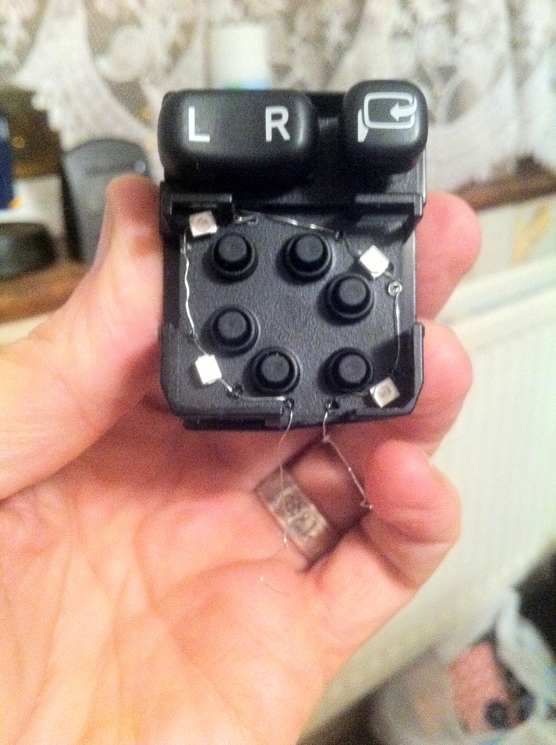

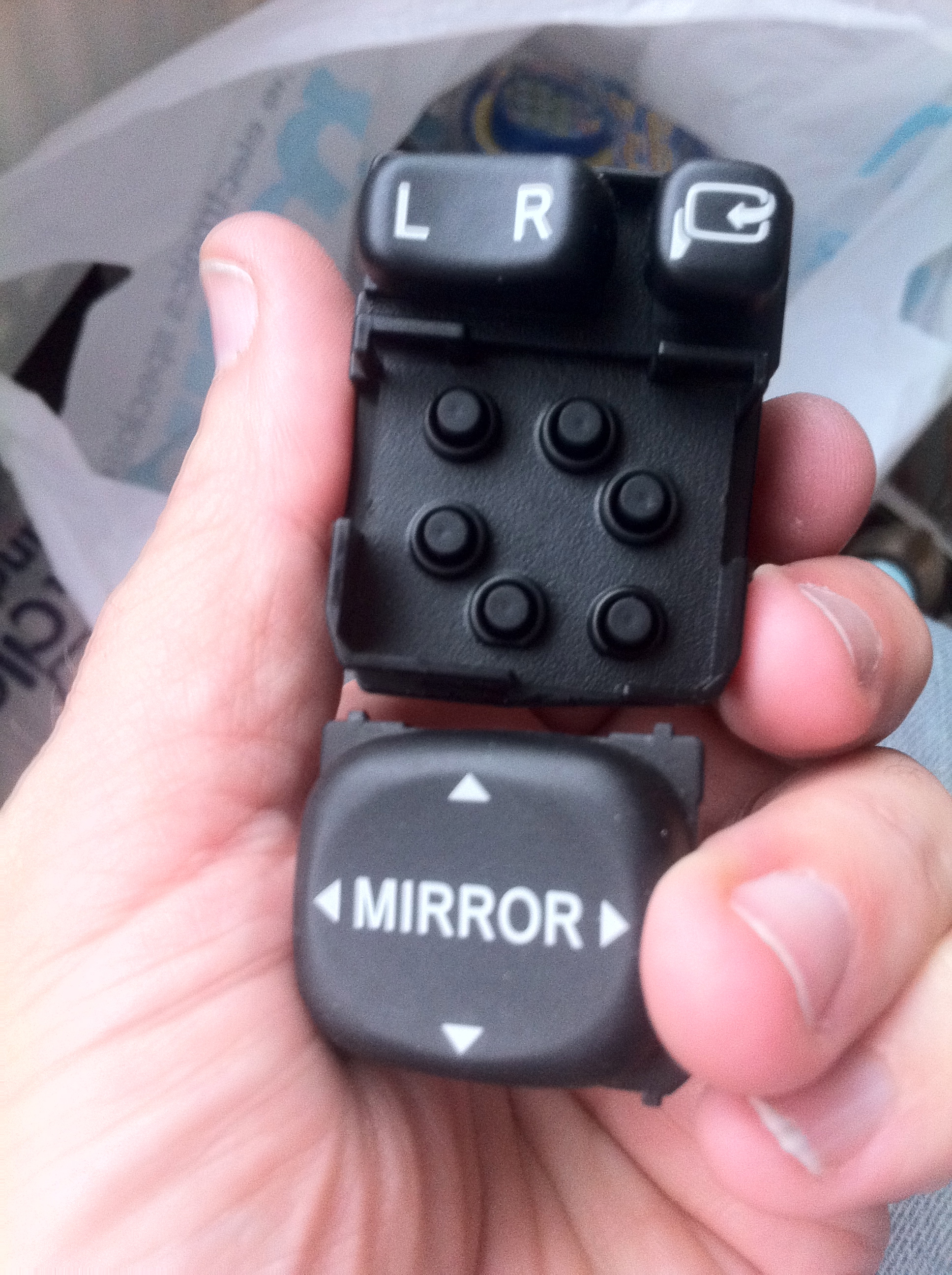

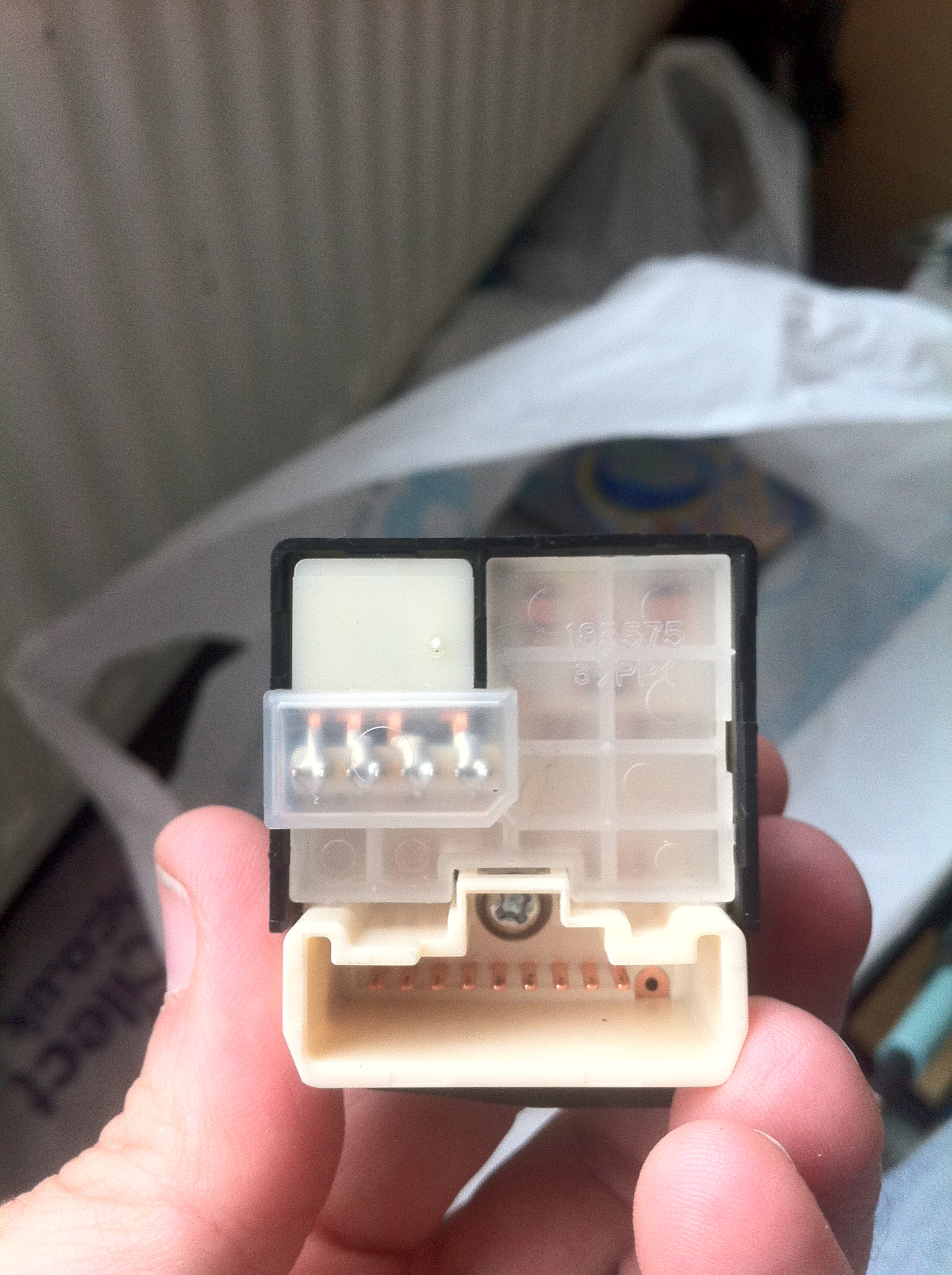

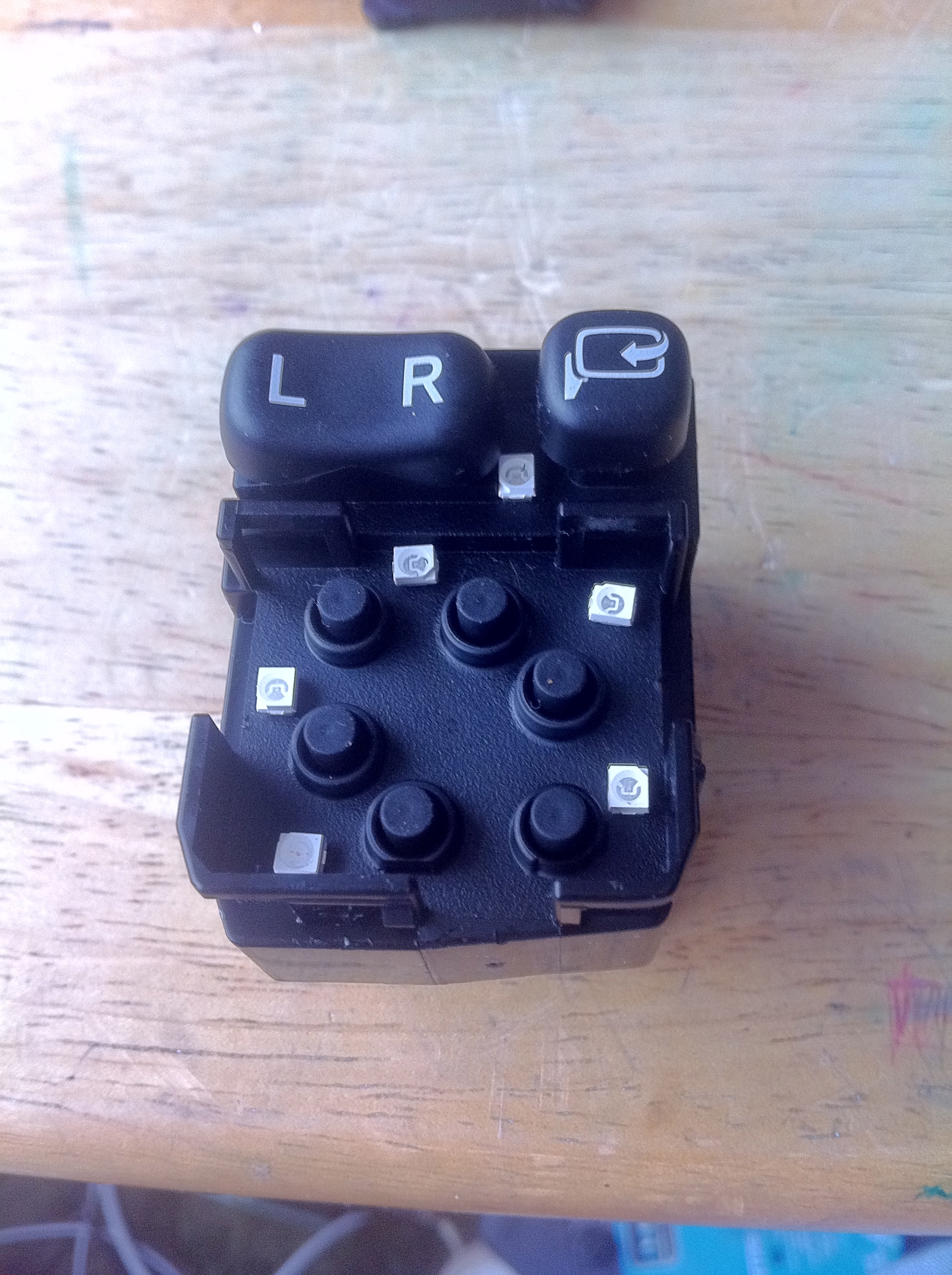

OK Have had look again at the switch panel . pictures below. It is possible to fit LED's under the mirror button and extend up into the L R switch and the IN OUT switch . need to get some micro wire to install them but I will . the last picture is of the LED's in position ish they are the white blocks. It won't display the logo's on the button but it should high-lite where they are.
Mark's LED's would be a lot easier but I like mine to be in keeping with the rest of the blue display. As usual will post results.

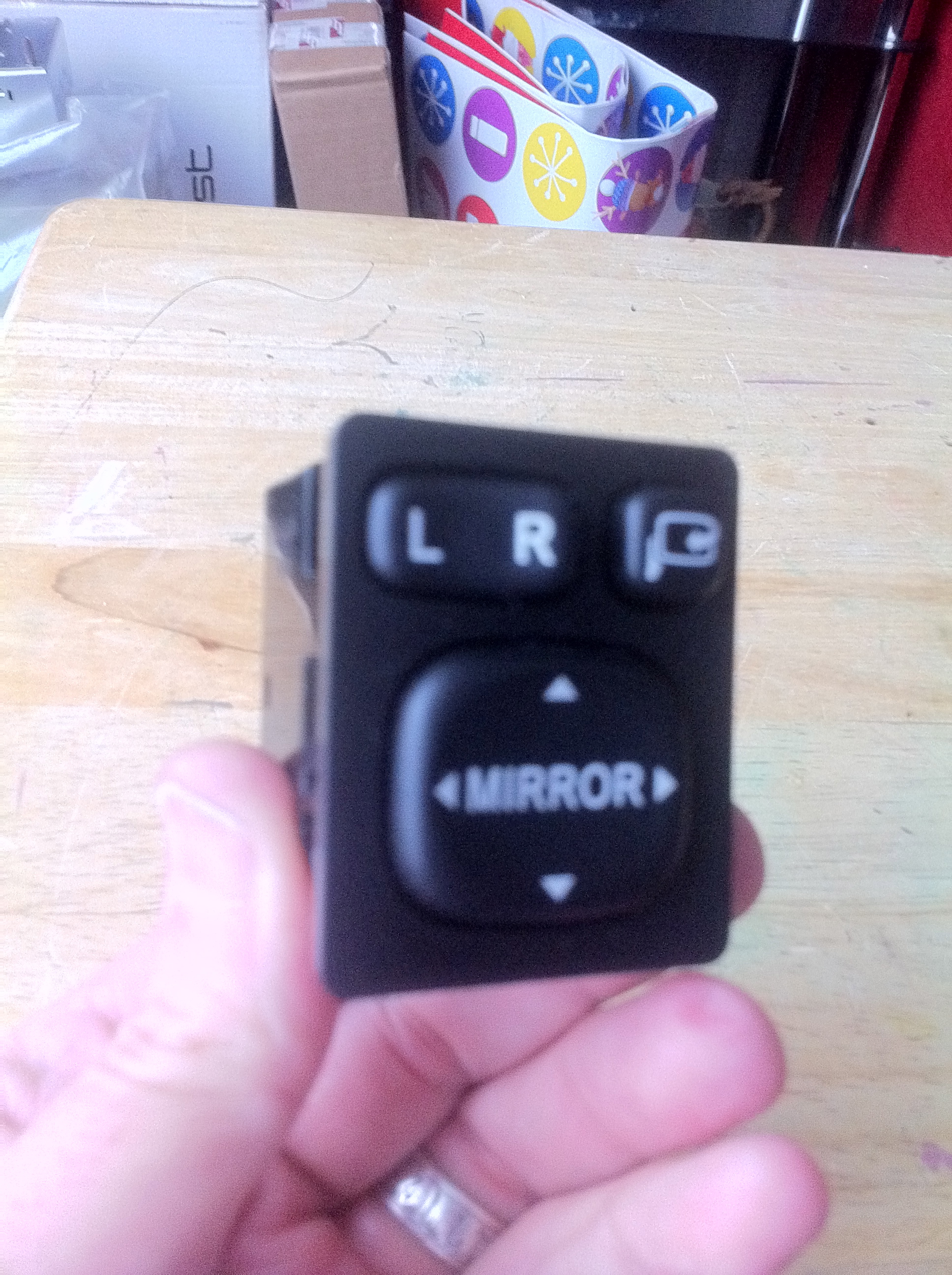

Ok I am having to admit defeat on this one. There just isn't enough room in or around the "mirror" button to illuminate the thin area around the button and still get functionality of the button. In its travels the button takes up all the room under it. this last picture is of 4 LED's soldered to one strand of wire and plastic "welded" into position. It does give a ring of blue around the "mirror" button but the button can only make small movements. There are smaller LED's but to be honest I don't think there is room for those either. So I guess Mark's find is the only way at present i can see to illuminate them
