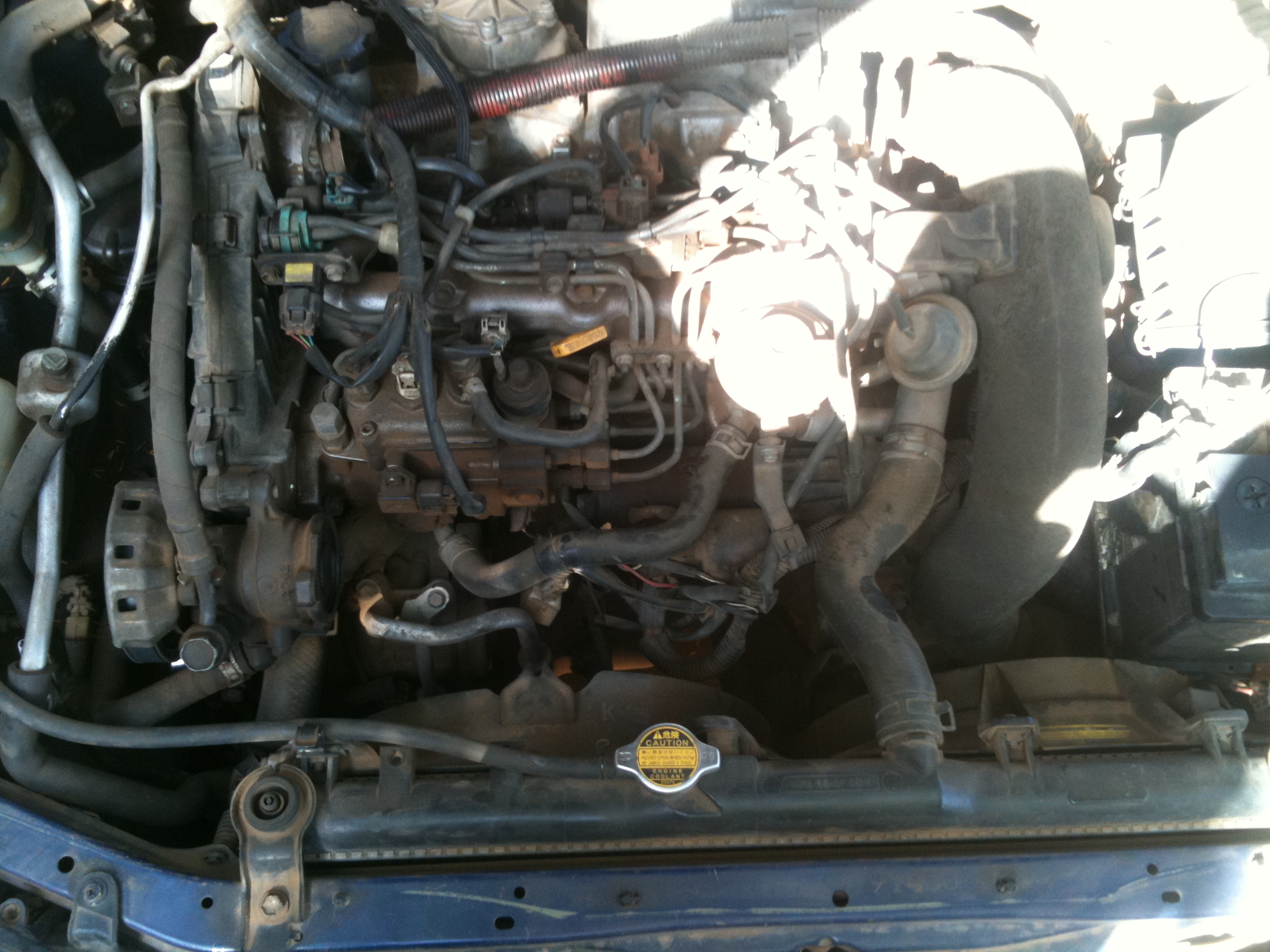

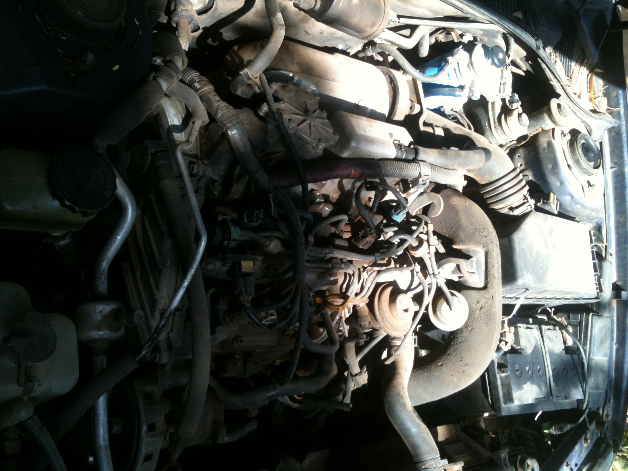

please send the good photo of engine compartment to point you on.
cheers
So here are some photos of my engine.

Here is another picture of engine

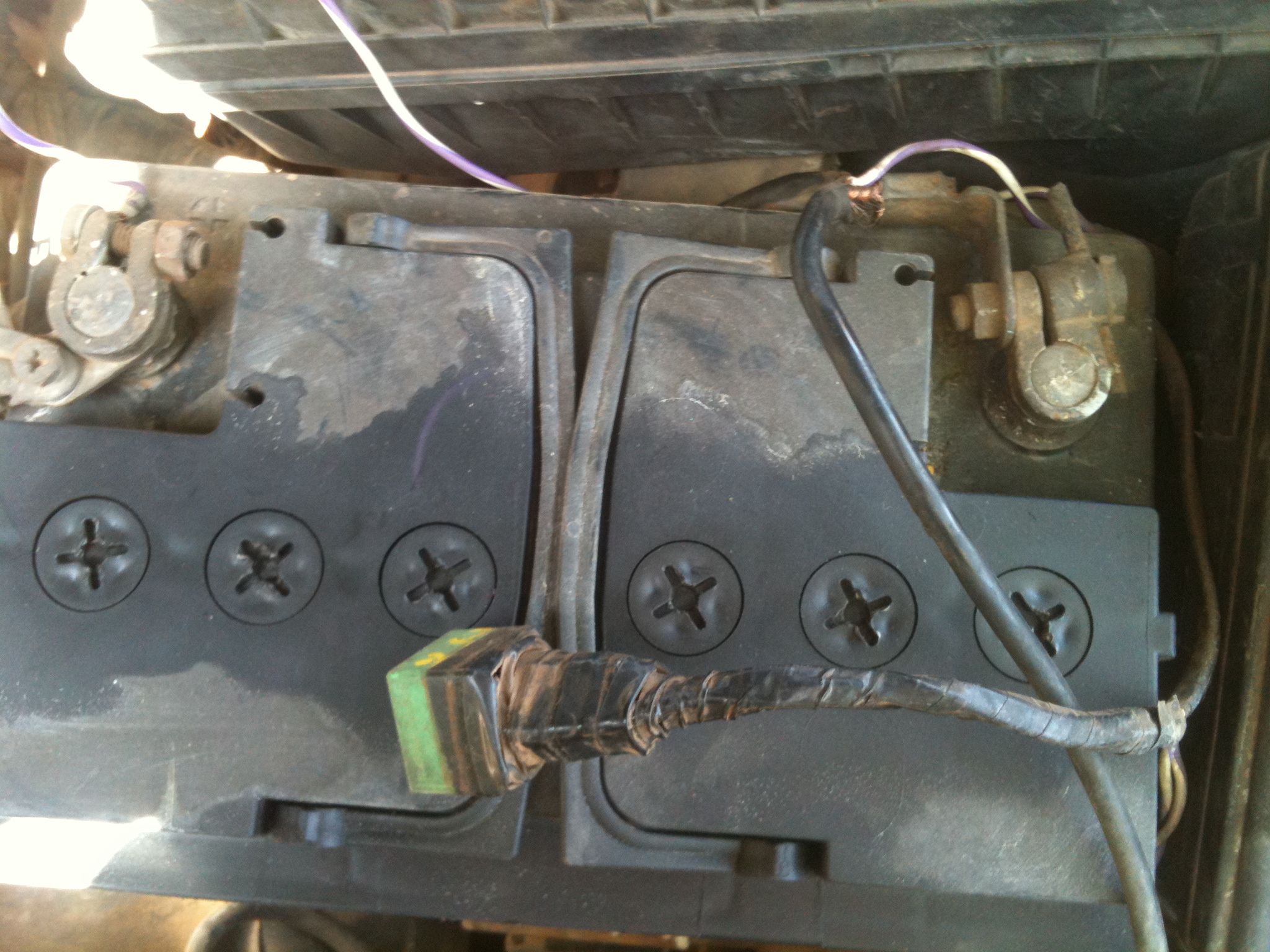

Here is a picture of the Battery --- which I am not sure about the wiring a mechanic did for some foglights
post-114956-0-56464000-1322046584_thumb.
If I remember correctly --- the intermitant starting problems started when I had these foglights wired to the Battery by some guy here. -- Precision work is not highly valued here --- can you see any potential problems with the Battery photo I just sent?
two questions, please
- whether VIN has been written in full and correctly ??? the program does not recognize this VIN;
- now look at the lid of the pump -- you will find several wire connections. one of the bases must be SCV that is in question. Check and clean all connections using fast solvent (wire/varnish friendly). look at this link --http://www.toyotaownersclub.com/forums/index.php?showtopic=87986 --- this is for SCV (our ravers section) -- the idea is very similar even the pump of yours is an old. Investigate the pump from alll sides and find this SCV. All connections must be as clean as possible to prevent an electricity leak.
the same is for Battery, as well
