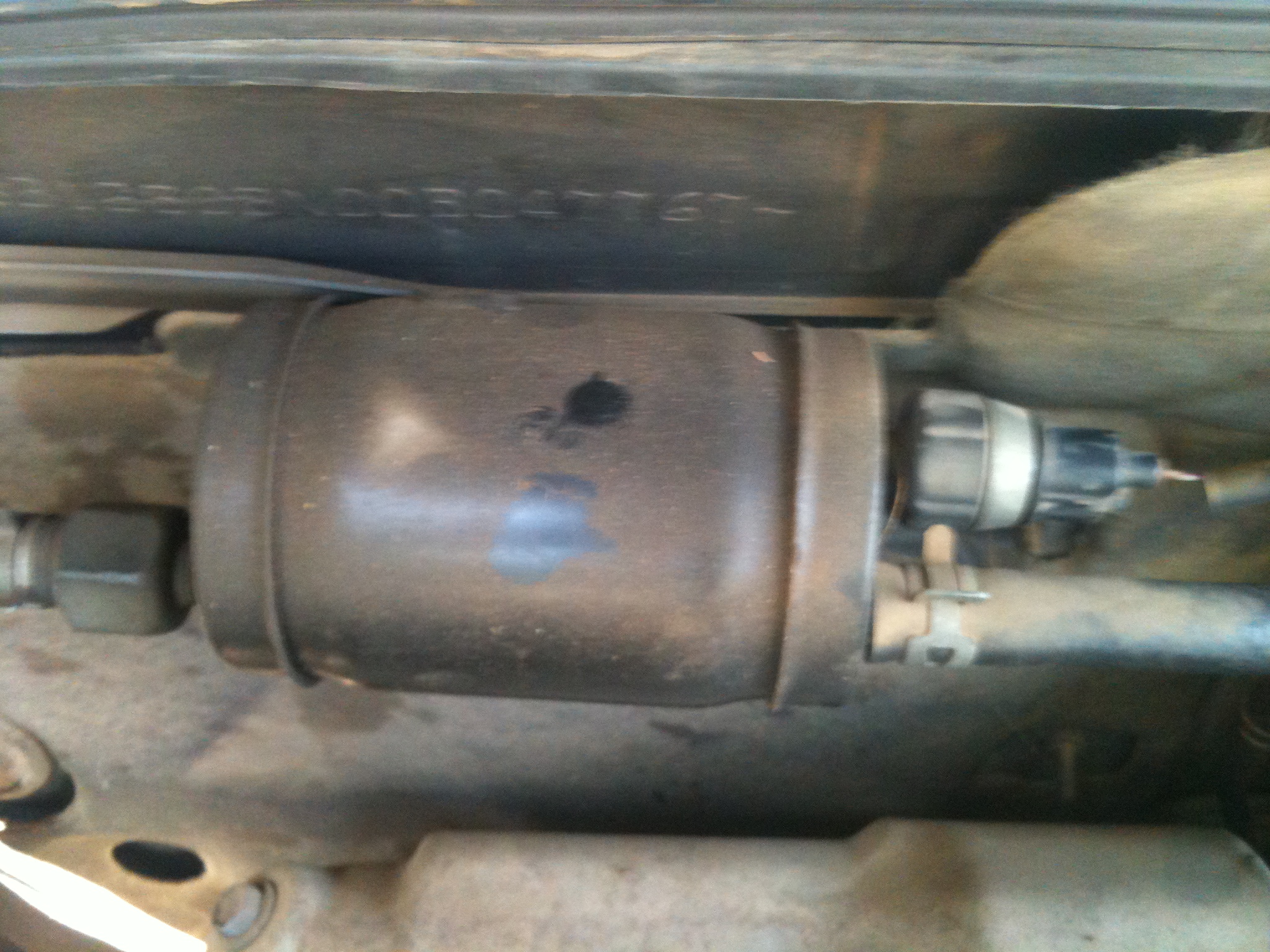

I'm still trying to locate the fuel pump :unsure:

Ok --- this is the fuel pump right? And the SCV is the plug on the left with the big nut?
To clean the SCV can I use WD-40?

it is not the injection pump but looks like an inline fuel filter or so.
i recomend you to find unit having for steel tubes connected in its lid on horyzontal and one found -- inspect all electrical connections on it. As a tip - the SCV looks similar to yours on this photo, but might be other design. Cheers/Igor
