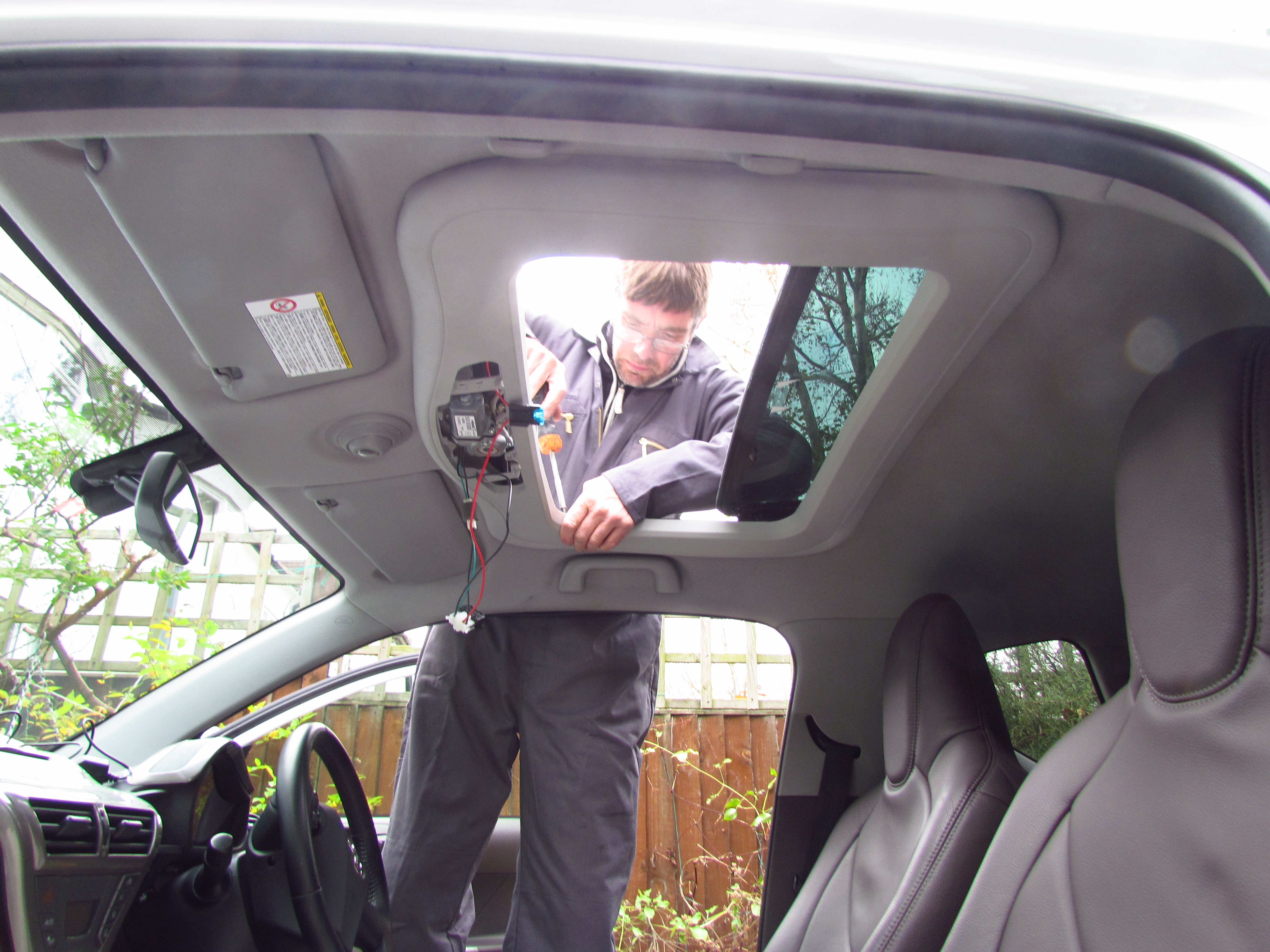

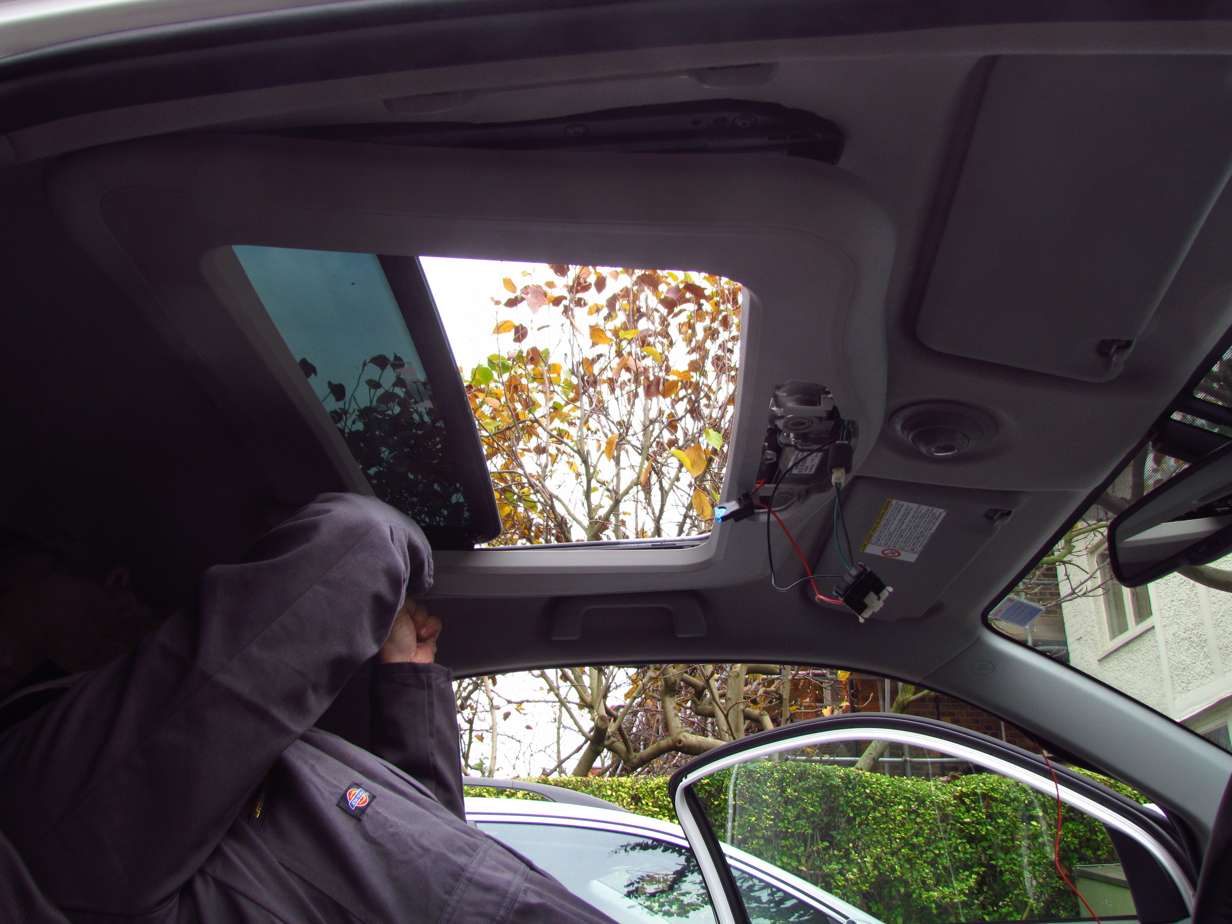

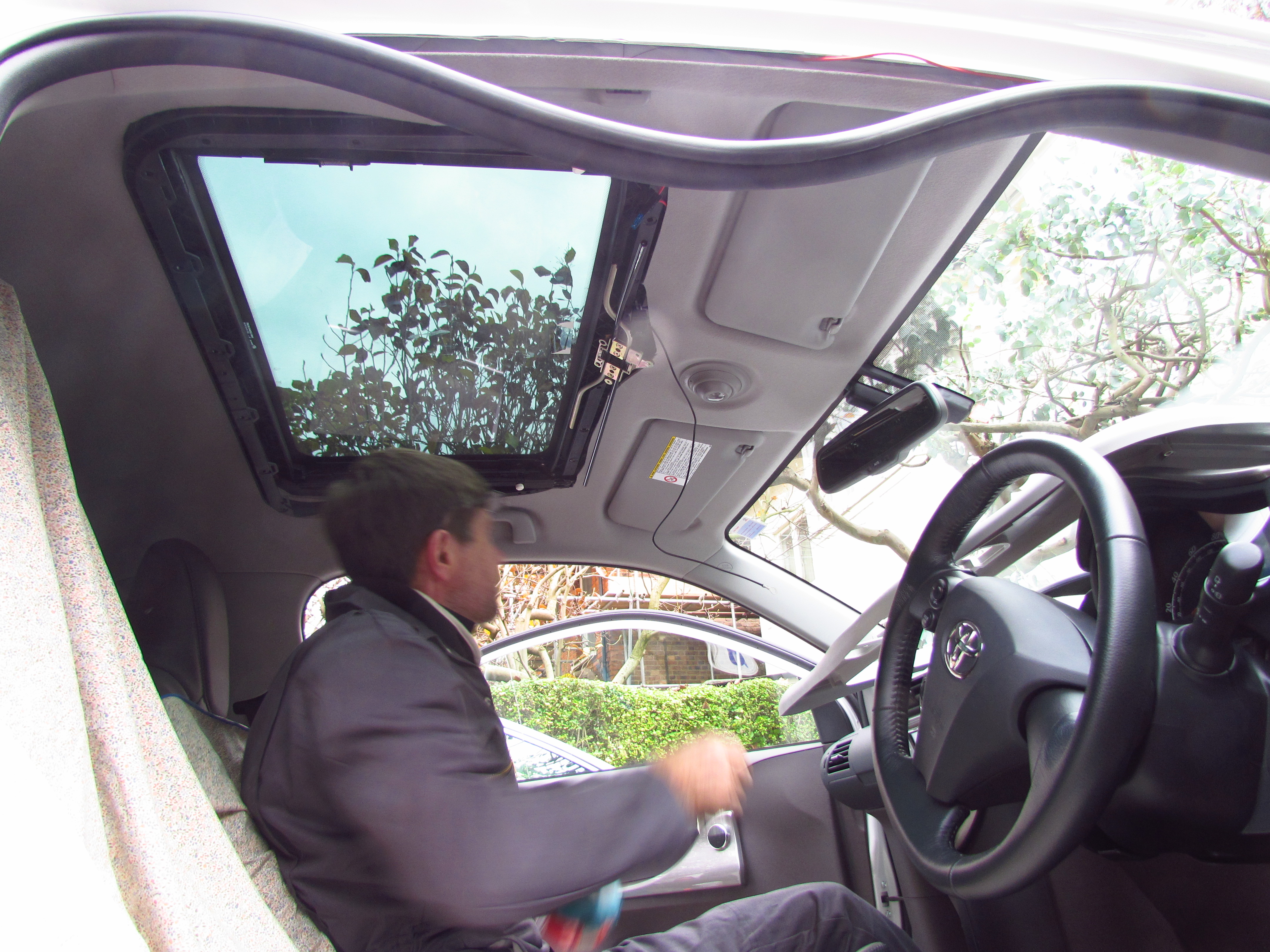

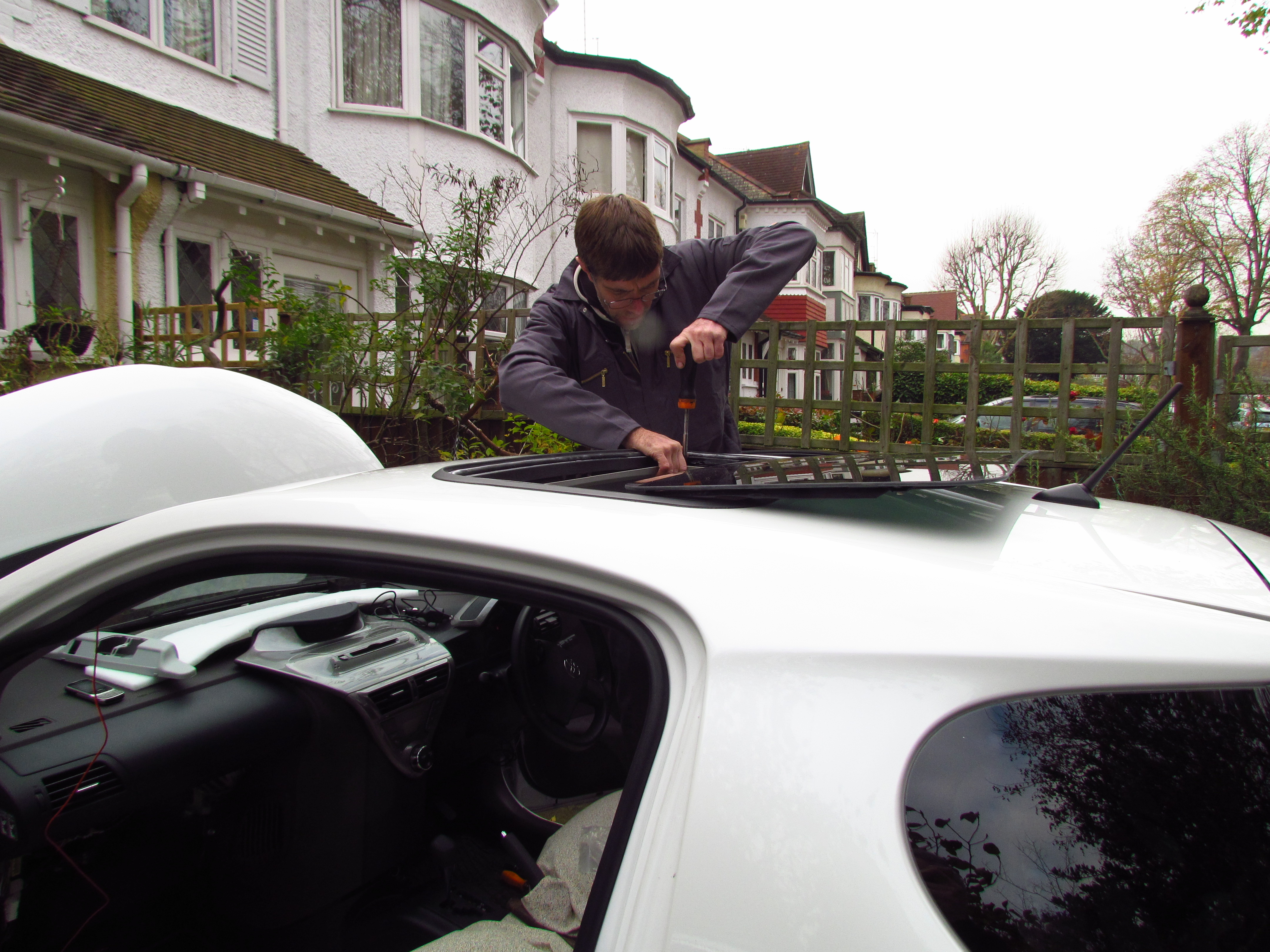

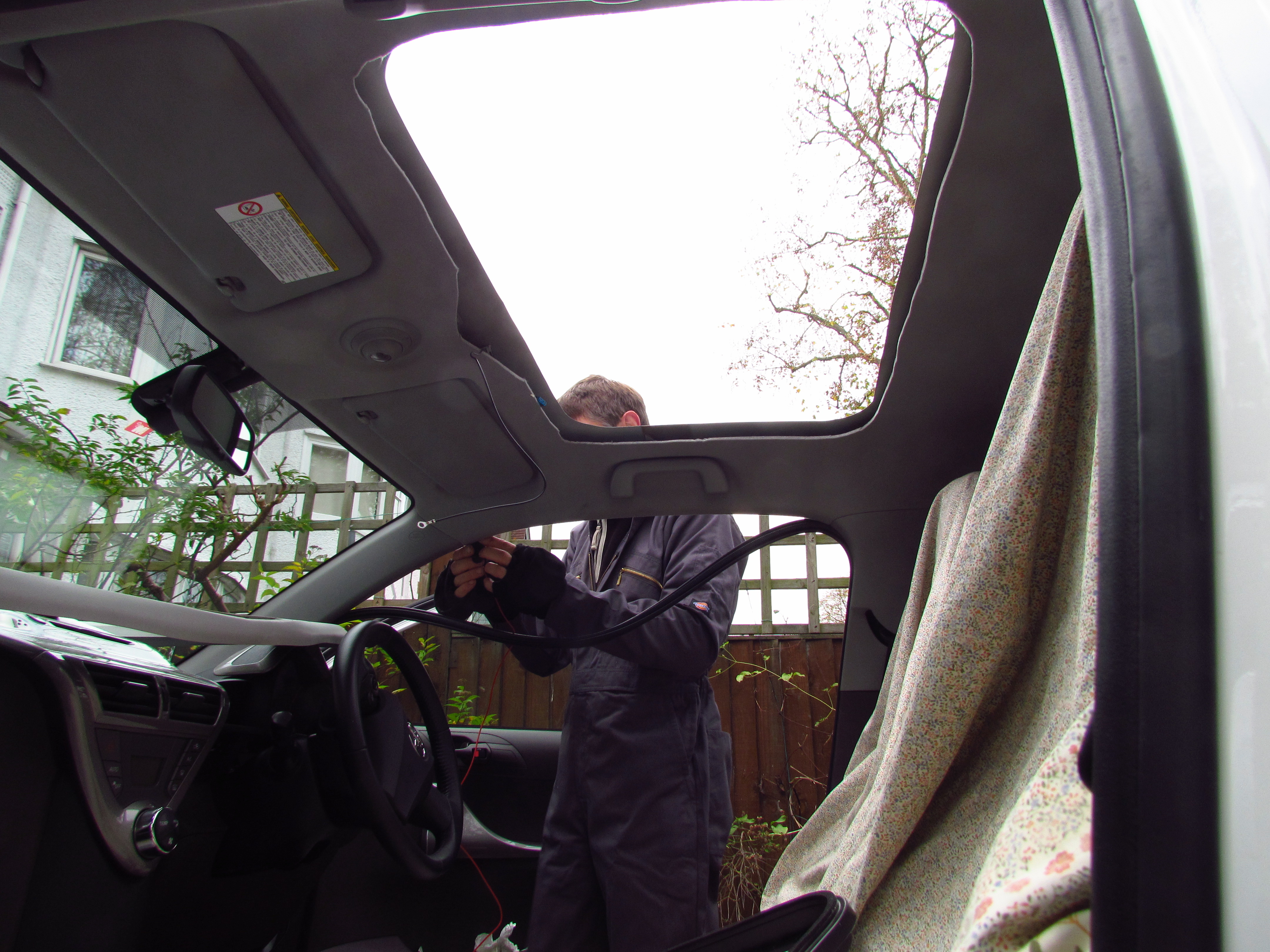

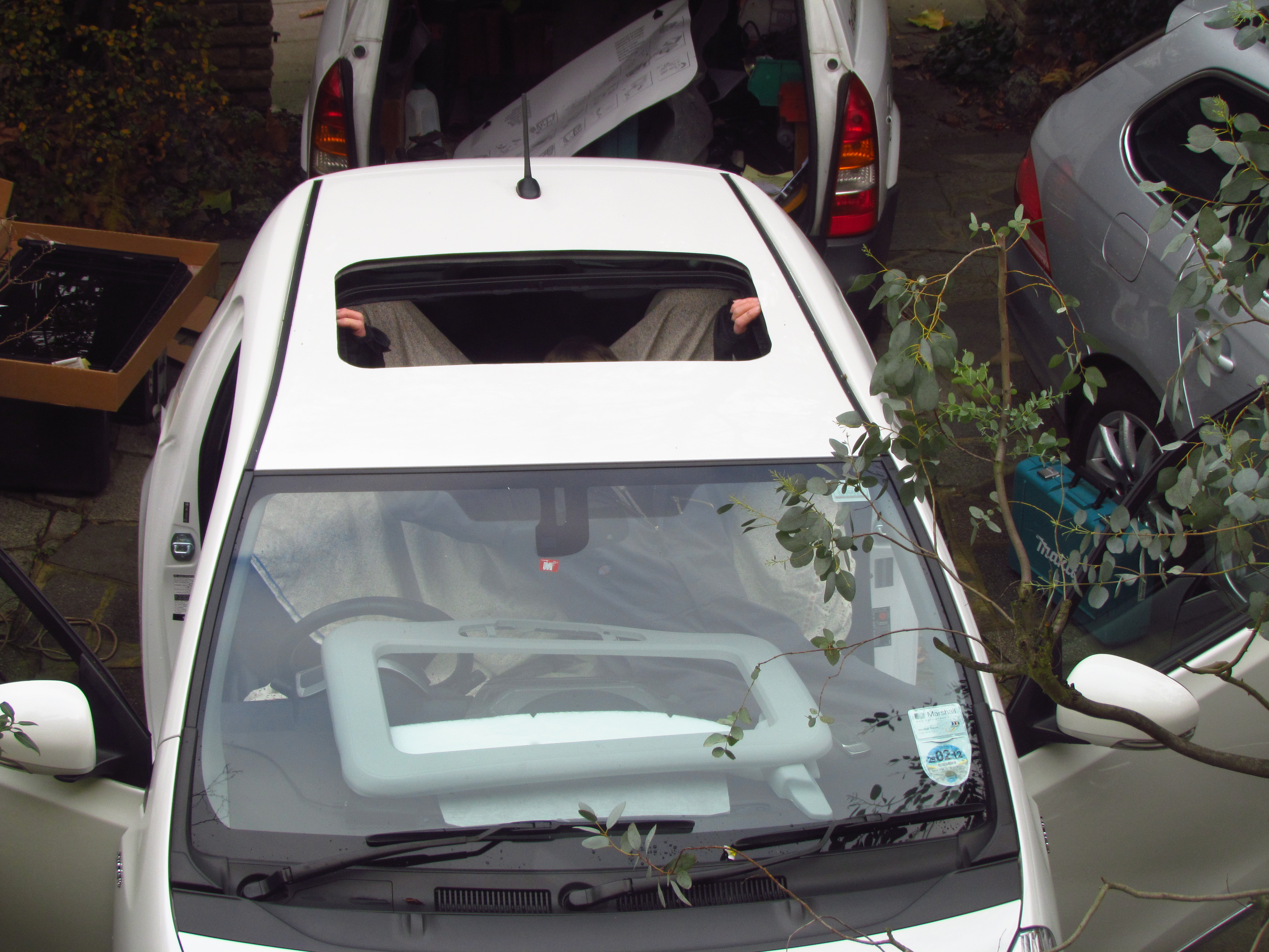

well finally, (after having started a sunroof thread some weeks ago) Dave from LondonSunroofs, came to the house, and fitted the new roof in about 3.5 hours
I was quite worried, in all honesty, as to whether I would just end up with a broken car in the drive, but ultimately I was very impressed with the degree of confidence and professional-ness of the company
After using the template to describe the cut lines, which was done extremely cautiously but certainly NOT nervously, I made myself scarce when the cut started, and when I next went outside, I couldn't believe just how neat the cutlines were....I had imagined a ragged edge, with chipped paintwork etc, but not a bit of it, as the cut was all done by 'hand' as it were, with scissor like sheet metal cutters...so no possibility of cutting through roof strengtheners, and none were obvious
the frame went in very neatly indeed, and then weatherseal, and setting sealant adhesive, when the whole thing was clamped up, inside to out, probably leaving an even less flexible roof than previously..

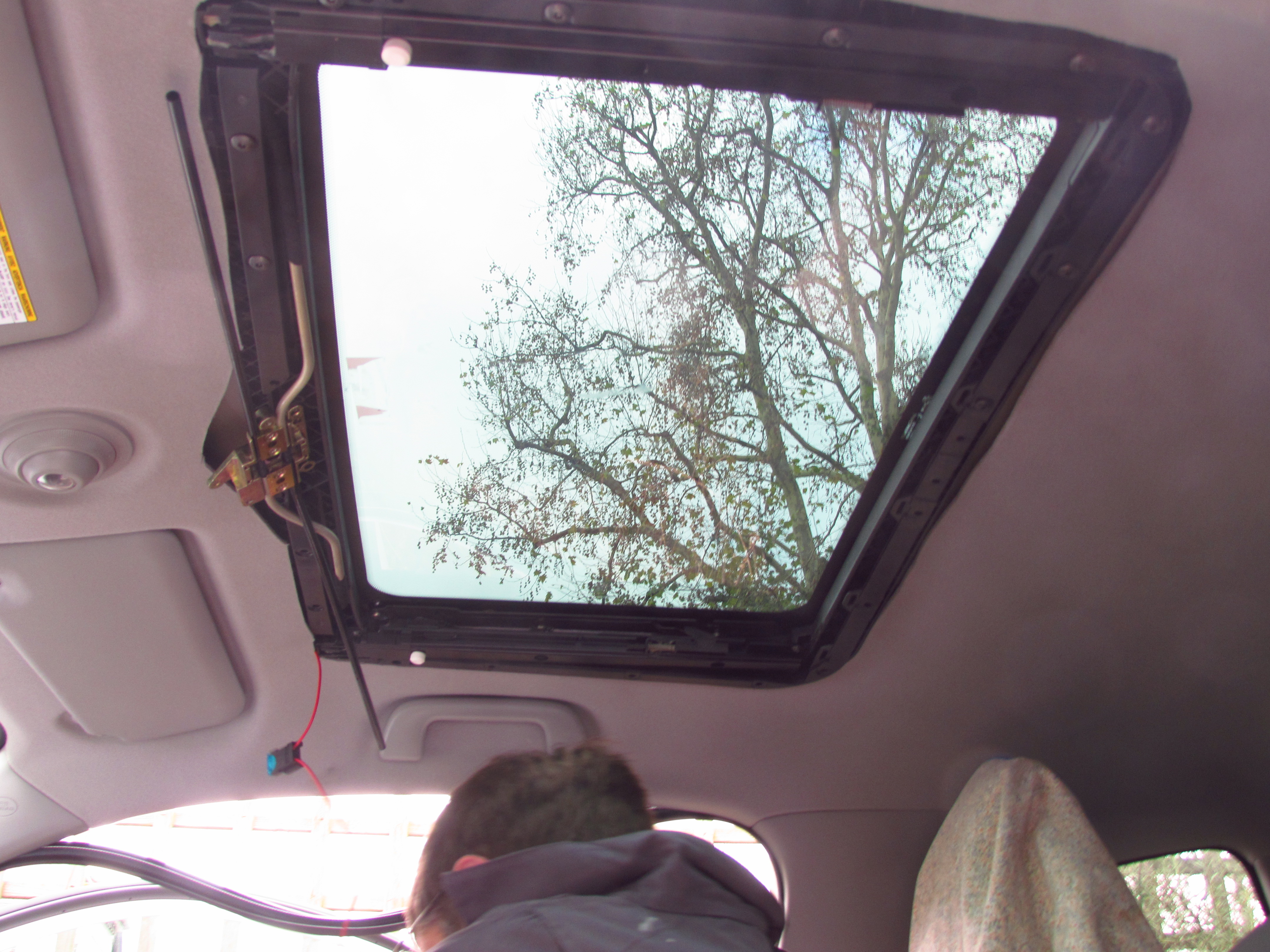

then it was a case of fitting up the electrics, which again looked very professional, with no maybe/perhaps/lets try this, sort of approach...Dave definitley knew what he was doing....
finally the little motor drive, and the glass roof itself, and the headlining trim, which fits "just so" around the pathetic interior light....
a few adjustments, and the whole this was working perfectly, and to tell you the truth, I was tickled pink
when fully open (and there IS a nice big opening) there was little drumming a a specific speed, but by closing it a tad, that disappears
.so there is now draft free ventilation, and other than if you were driving the car, on the equator, AND at mid day, zero chance of the feared skin cancer!!
recommended, but only if you want (another) unique IQ
cheers barryc

thanks for all your support folks, and I understand the universal appeal of pics.........and of course, I took quite a few during the 'operation', and I even tried to attach some to the last mail..

but, lets see now post-112763-0-38083400-1322818281_thumb.post-112763-0-68851700-1322818062_thumb.post-112763-0-87502500-1322818163_thumb.[attachmepost-112763-0-73780400-1322817820_thumb.nt=10766:IMG_1391.JPG]post-112763-0-39314300-1322817663_thumb.post-112763-0-42101000-1322817559_thumb.
well I have no idea what this looks like, other than a dogs dinner, at the moment..........it seems like all my files are over 3 mbs which take too long to load, but I dont know how to reduce them in size...
so thanks again David, but as for the electrics, well when the trim is stripped off, it looks like a BT junction box inside, and all I can say about Dave and his multimeter, is that sometimes it went "blooop", and sometimes it went "bleeep", and sometimes Dave grunted, but that is probably not much help!..........except that it all worked, and so does the rest of the equipment!!!
cheers folks barryc.
post-112763-0-86985300-1322817932_thumb.

Very funny... that first "hole" in your roof .... that must have felt strange... cutting in you car... :blink:
But after all it fits very nice...!!!
Barry, hats off to you. :toast: A brave man having someone cut a hole in your prized possession.
Good progress pictures and by the sound of it, a good well trained fitter. I bet you were so relieved when it was done and working but, obviously a job for a dry day. As you said at the beginning though, a professional job, and it does look good. Do they give you some kind of warranty with it? Like maybe a working parts warranty and/or 'sealed from the weather' warranty?
Did you test it yet with a hose or buckets of water? You know what? I think I'm paranoid about things like this, not working, failing... possibly because... well, no reason really. Yep, I'm paranoid. :eek:
It seems well worth it Barry! Yes, you are a brave man indeed but now you can reap the benefits of being so. looks very nice.
In deed Barry it looks very good and am very pleased for you. If you have time can you identify further for me the location of the "junction box"

David, (Dave) the fitter had the panelling off in both the footwells, so just where he took his feed from I couldn't say
But I think a short phone call to Dave (which he sort of expects, after all the uploaded [pics), would give you the info you would like...

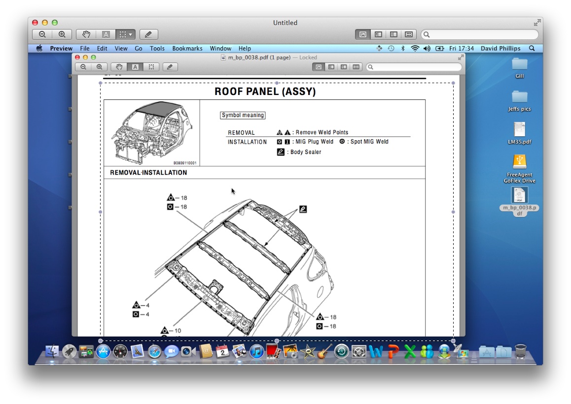

Ok Barry I thought you implied it was a junction box within the roof area. I am very familiar with the left and right junction boxes in the foot wells, cheers. I have uploaded a screen shot of the workshop manual showing how to replace the roof after a crash, It shows the middle cross member I think I spoke about previously which if you were having a new roof I guess they MIG weld to. Strange because you said there wasn't any.have a look.

It looks like you have a Apple Mac David, sensible lad.. Also looks like one of the cross members would be in the way of the new roof.
sorry for the confusion David...
your thumbnail of the roof section is interesting, as the fitter was using sheet metal scissors, and couldn't have have gone through any crossbracings pictured without (effing & blinding) and a power tool.....and there was no sign of any cut sections, when examining the original hole...
