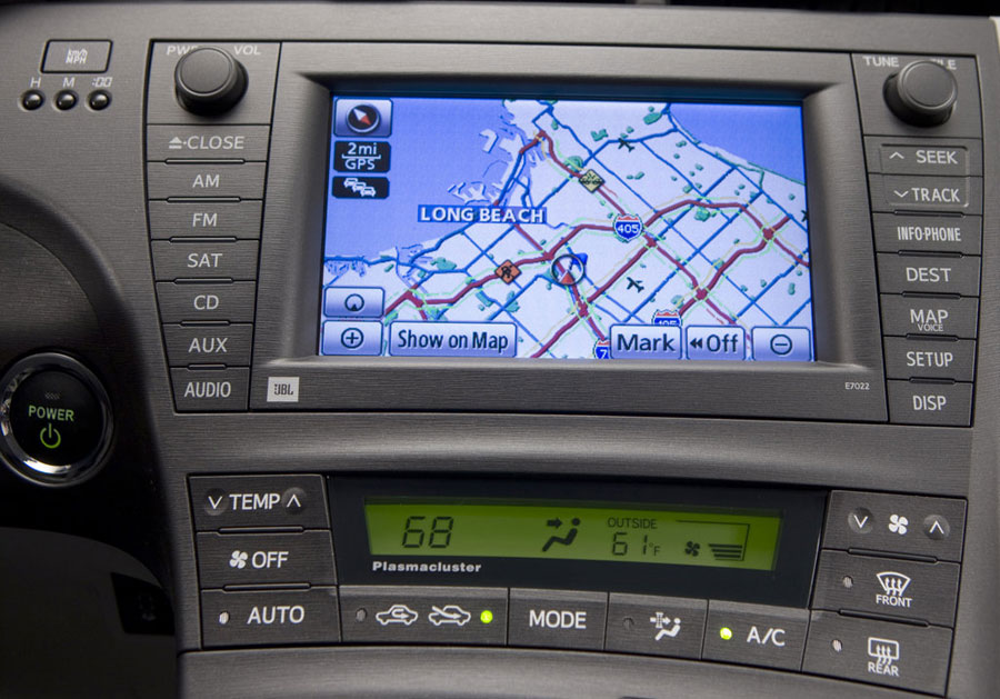

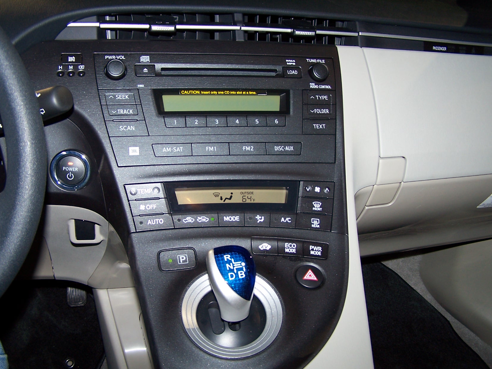

Any way I was wondering if it was possible to change the center console from the boring CD player to the nifty touch screen version on the Gen3, I have been trying to search on the prius chat and google, but it came up blank.. does any one know if it's possible, or is there many other add on electronics that needs to be installed?

It is possible to swap the boring gen3 CD player for a nifty aftermarket factory look touch screen unit (and add a backup camera).
You need to have a look at this thread.
http://www.toyotaownersclub.com/forums/index.php?showtopic=130848
And this one.
http://priuschat.com/forums/gen-iii-2010-prius-audio-electronics/94772-factory-look-gps-ebay.html
Unfortunately, the gen3 head units are not symmetrical so you need to get a RHD unit for a UK prius. Most of the factory look aftermarket units like Rosen, Ottonavi and Flyaudio are for LHD prii (USA, Europe) and don't fit a UK prius.
You can also fit a generic 2din unit.
Have a look at this thread...
http://priuschat.com/forums/gen-iii-2010-prius-audio-electronics/90622-in-dash-navigation-right-hand-drive-prius.html
