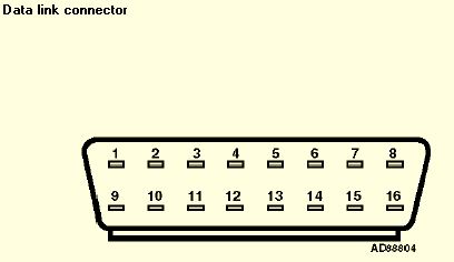

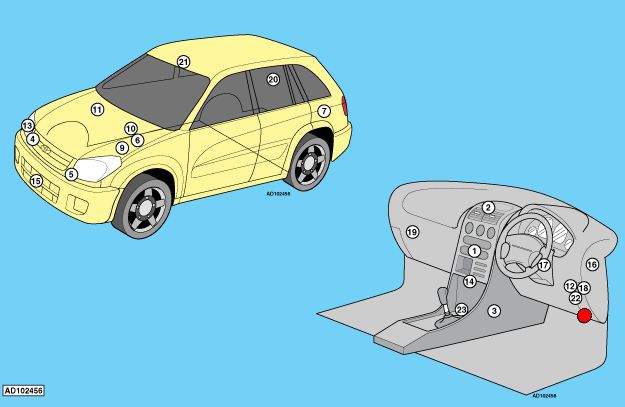

As for the port, it's under the fuse box next to the bonnet release switch (at your right knee when seated), but tucked up behind the plastic trim slightly - if you stick your head down there and look up you can't really miss it. On the diagram below it's located at the red dot.
post-99583-0-97788200-1323679373_thumb.j
It looks a bit like a TV SCART socket in size I guess (used to connect videos/DVD players etc).
