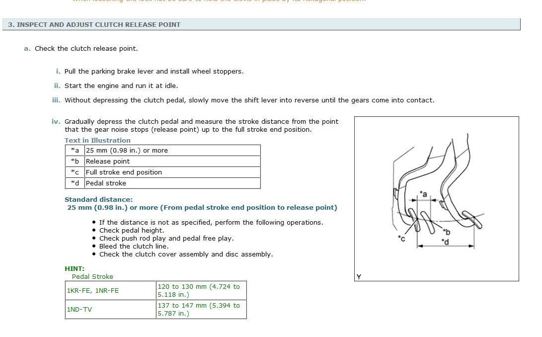

Okay, Just had a look in the manual and it specifies, if I read it correctly, 25mm up from the end stop position to the start of the bite point is the minimum measurement, not sure it says a maximum though?
I'll be meausuring mine tomorrow now....
Craig.
post-116364-0-45188400-1327959986_thumb.
Well, I feel a bit better this morning.
I did a quick check when I got to work and the clutch starts to drag the gears round about 40mm from the floor but the full grip to get you moving is obviously higher than that.

Some pretty good info there Craig. My iQ had quite a high clutch when I bought it used with around 4k miles on it. It wasn't faulty though, just higher than my previous car and took a bit of getting used to.
