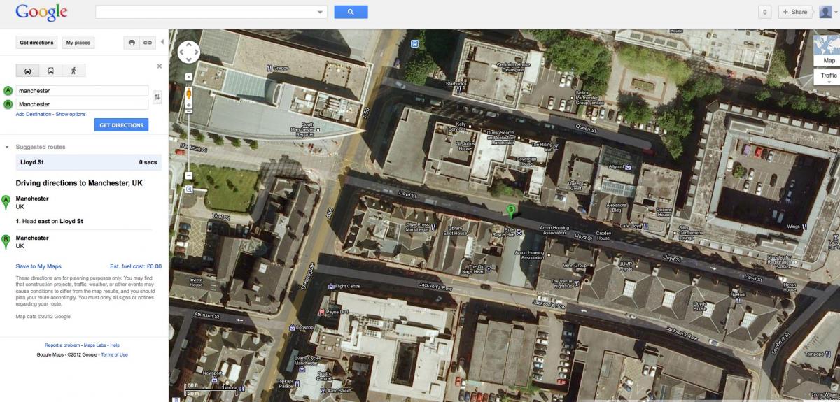

Am I missing something? I can't see a more or send or anything, see attached
Did you go into google via the on line touch & go account? I cannot work out how to attach the thumbnail so hearer is a direct link of the screen with the send page on it.
http://www.toyotaownersclub.com/gallery/media/399
