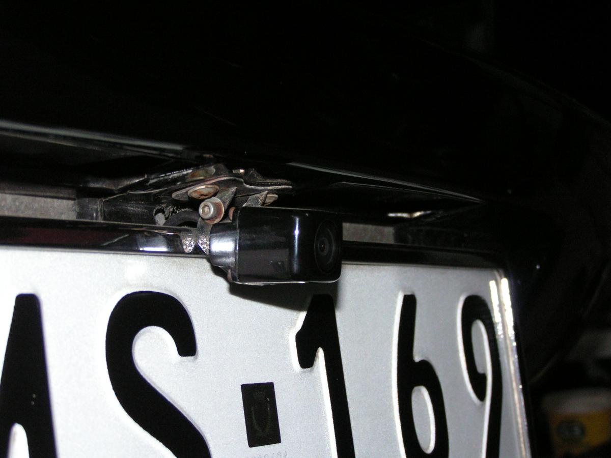

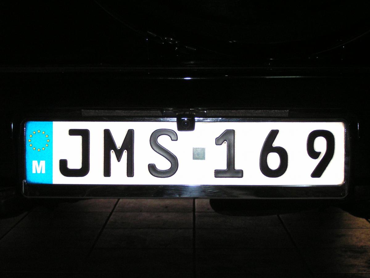

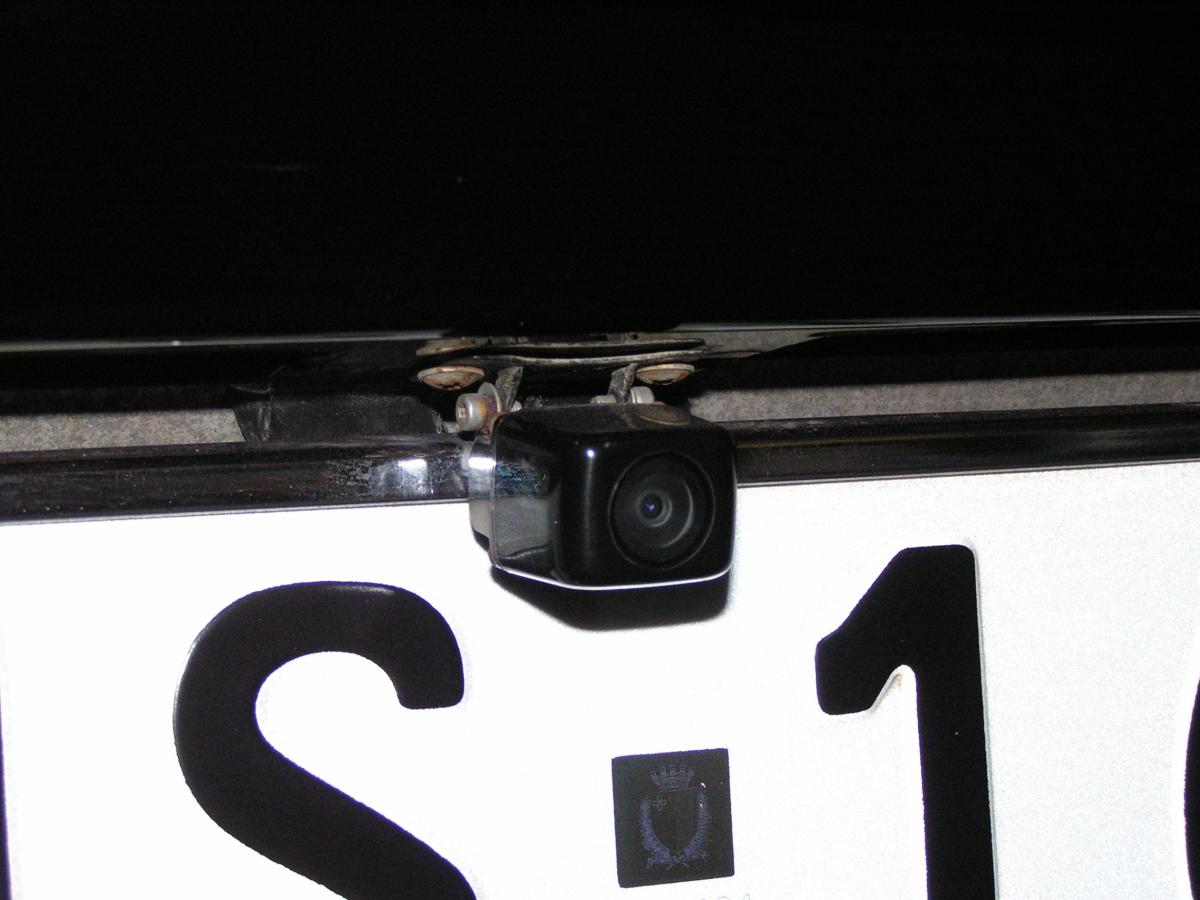

Hi, as I bought mine quite a long time ago, it's no longer listed on eBay but there are lots of cameras to choose from.
Mine is very similar to this one
http://www.ebay.co.u...=item19c696fc1a
As my Rav is with spare wheel, the number plate is in the bumper so I placed camera between plate lights as seen in below pictures.
post-93879-0-55423300-1335420080_thumb.j
post-93879-0-22982500-1335420149_thumb.j
post-93879-0-16331800-1335420204_thumb.j
hope this helps and don't hasitate to ask any questions if required.
