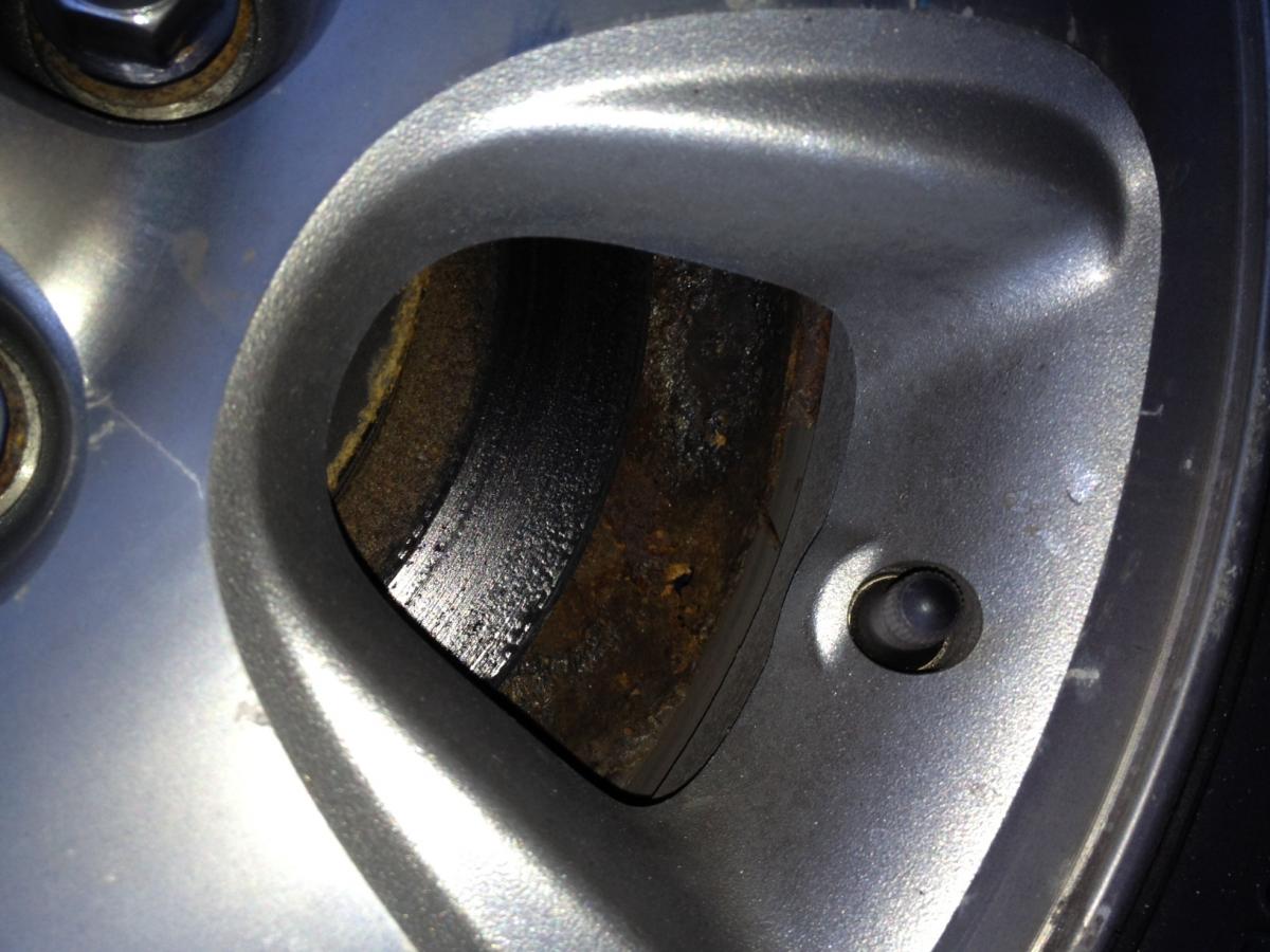

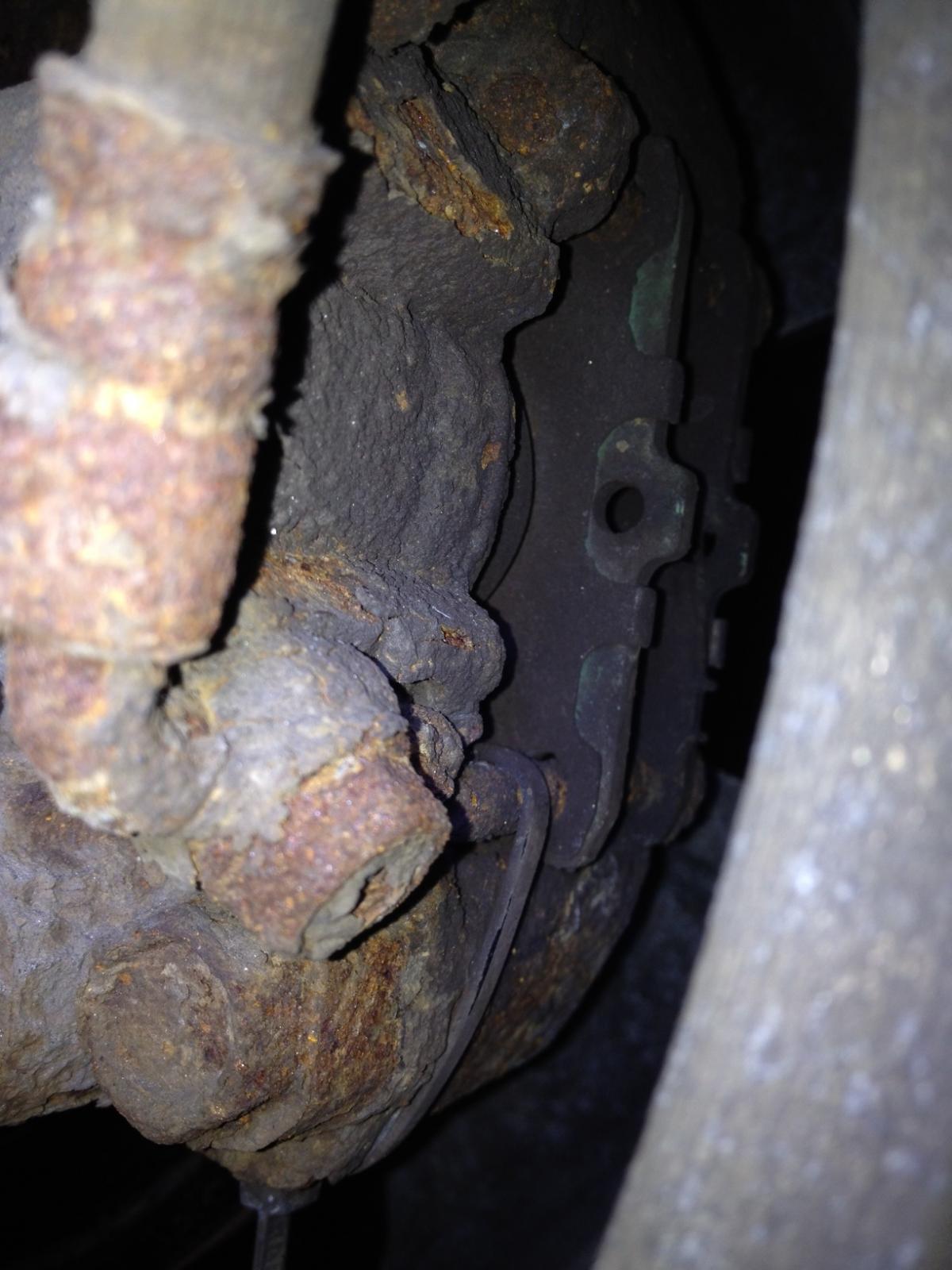

2 - a clunk from the back when I braked earlier and there was a grinding noise when driving after. When I got home I noticed between the spokes of the alloys that there is some rust/corroded metal behind the brake pad. I've attached a picture below, to see if anyone can help as to what they think it is? First is through the spokes and you can see the 'thing' below the brake pad, second is from the back of the wheel.

If that second picture is the rear disc then its completely knackered.. It would NOT be advisable to drive the car with defective brakes . In fact it would be completely the opposite !
Has that car been in the sea ?IE does it have a tow bar ? I have seen cars looking like that when Owners have backed Jetskis and boats into sea water when launching !
A fairly urgent and major brake overhaul is on the cards by the looks of it !!!
Rear pads and discs are dead common on 4.2s. If the calipers are worn they will need renewing too.

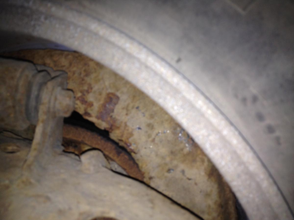

Just had the RAC out and they advised it was a corroded, loose heat shield that caused the noise and the grinding. The RAC man said the heat shield although necessary, with being the back one it isn't as important as the front heat shields, but needs replacing.
The thing he was most concerned about was the fact that the brake caliper on the back was damaged and the retaining pin that should have been holding it in was replaced by a plastic cable tie. He was concerned that the garage sold it this way and mainly that I had driven back nearly 200 miles from the garage.

Here's the pic of the brake caliper with the plastic cable tie holding it in place.....

Blimey do the fronts look the same?......those rears look very rusty indeed .
Nope. Service was carried out 1500 miles ago and the front brakes were replaced then

I've spoken with the garage I use and they've explained:
The brake dust shield (bit that rusted and fell off) he can only get from Toyota and is £367+VAT
The Caliper and pad x 2 + labour is £230 + VAT
Does that sound right? The man at the garage I use said Brake shield sounds very expensive for the part - the most expensive one he's had to buy before is £75 + VAT but can't source one elsewhere.
That dust shield has to be the wrong price, surely Toyota cant charge that for it................. Otherwise I will start making them from old quality street tins and selling on eBay..
PM Kingo for some prices...
Is it just the one side that needs fixing?
Plus how necessary are the dust shields?
Jedi - no - one has rusted and fallen off and the other is on its way.....
What is the full name of Kingo so I can send them a PM please?
I would tend not to bother with them, but they must be there for a reason, If the garage is paying id get one fitted
