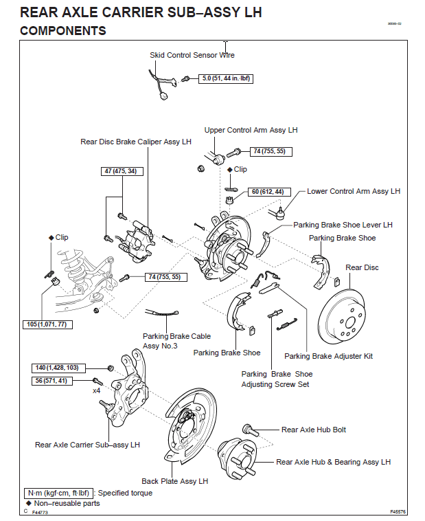

Hello Phil, I think all the T25's have ABS but not all the T22's, the car in question is a 2002 vermont so it should be a T22. anyway i have attached a drawing of the T25 rear hub etc.
Regards Pete. :thumbsup:
post-74463-0-94267500-1342604094_thumb.g
Yes the T22 models had a with/without ABS option, some also had rear drums instead of discs.
