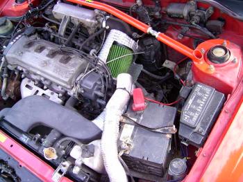

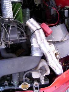

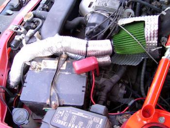

You could try what I've done which is to run it behind the headlight - mine comes out behind the lower grill.
I've modded the standard feed as well so I have two small feeds rather than one huge one. Can take a quick pic if you like.
pic would be great if ok with you. already got my standard feed but just wanna feed a bit more to it as to standard one ends behind the headlight
ed
Right here's the bay- you can see the dual feed & how I've adapted/bodged the standard one :D Seems to work anyway!
