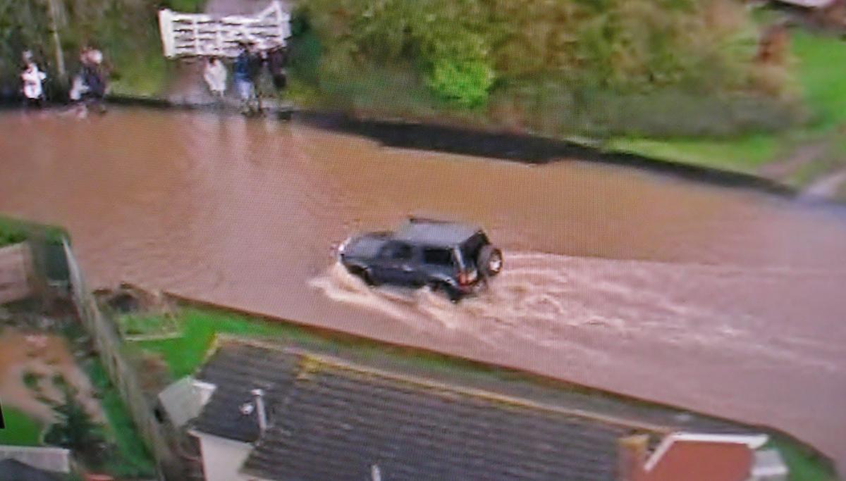

Grabbed this from TV on the BBC news earlier.
Is it a 3 door RAV??
post-111709-0-10000000-1353921517_thumb.
Looks like a Mitsubishi 3 Door "4 Work" I think, Paul, with some show off airse at the wheel more than likely......and if one spoonerises said name, one gets Kingo's recent appearance.........Bitsimushi....naw....?

Disagree with you there Kev, that silly idiot is driving a Fourtrac!!!!! Remrember them?
Regards Clare
It's a SWB Shogun me thinks, I had one once, swb diesel with every extra available at the time (Sept 1995), it was stunning, I woke up one morning 12 days in to owning it and it was gone, as was a lwb shogun from the farm down the hill from me ! Tea leaves.....
Well, I suppose the water is only up to his knees.................
Oi, I heard that!!!
Regards Clare
Heard of it I have never, Clare....who made it....?
