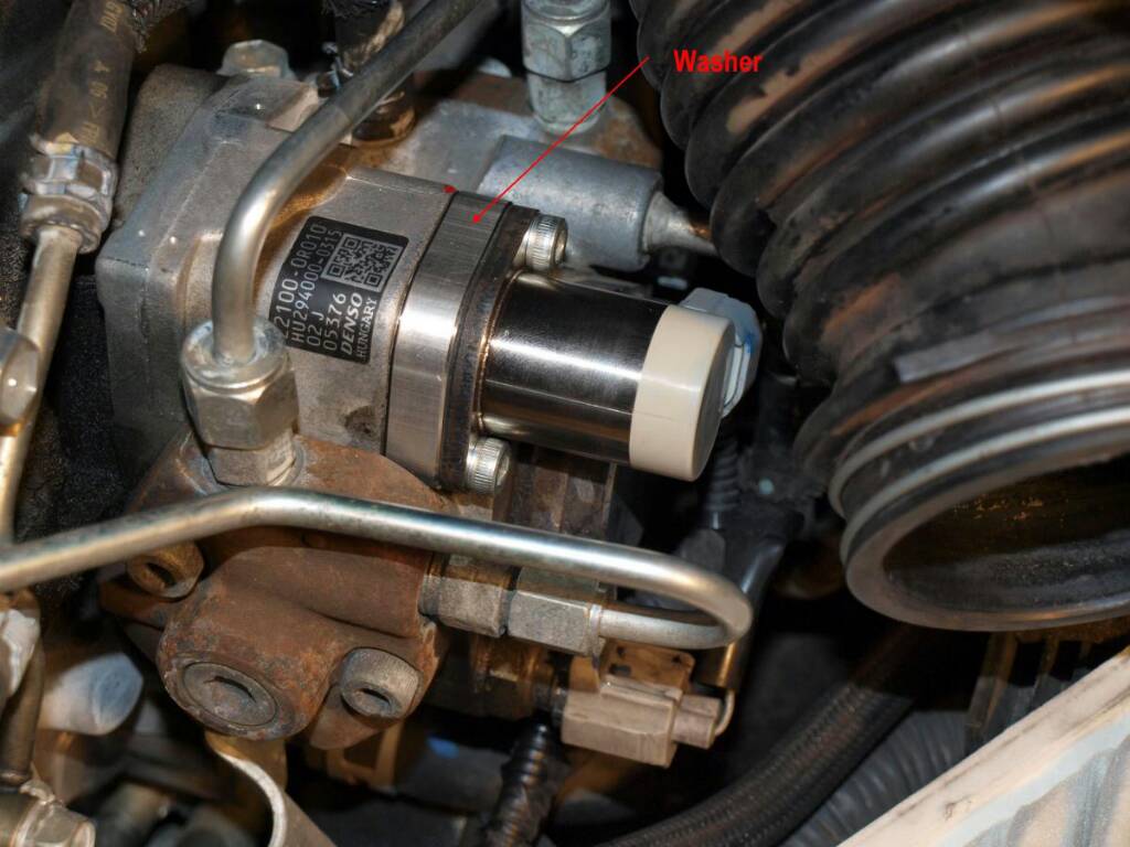

My SCV color is like old one but I am not sure for the shape and connector direction...I will check.
Best get your car booked into Toyota as there is updated ECU software to be installed along with the modified valve, otherwise the valve may not operate well for long, you will need minimum software version 302v0000
I don't know if my SCV is modified or not. How to recognize it?
In Techstream/ Health Check Results I see Engine and ECT- Calibration 30554100. Is this software version?
Yes 30554100 is your software version with the latest version being 305B7000 if your profile info is correct as a 2006 2.0 UK 1AD-FTV
heck the length of the chrome bit. The new one is longer. And also the new one has a 1/4" washer on it......

Few months ago I cleaned the SCV and as long as I remember no washer, so probably is old version...

From my previous experiences cold start issues on the AD series engines are usually caused by faulty/failing suction control valves. There is a TSB regarding poor startability which describes how to test the valves and modified scv's are available along with a software update to cure these issues. Your local Toyota dealer should be able to assist.
Devon
Hi,
I had the same problem. Poor start with cold day, engine sometimes only puff-puff and stall (blue-white smoke). In last three years I changed glow plugs, battery, overhaul fuel pump, bought new injectors, bought fuel warmer etc. But everything without effect. Now I found where is problem. If you have a small SCV valve on fuel pump (called Compact SCV) try this home made diagnostic: warm up SCV valve before starting in cold day using hot water or hot airgun (about 80°C). When engine start for first time, piston in SCV valve is seized (rather chill diminishes tolerance and piston seized). Denso prepare new version of SCV valve, please wait few days, I prepare complete guide with pictures, order numbers and Denso service manual.
P.S. I´m sorry for my english, because I´m from Czech Republic :-)
Edit: 6.2.2013 - Here is part number: new one - 0422626020 (replace old 042260L030)
After replace SCV, you must make Supply Pump Initialization Procedure - see enclosed Denso Repair Manual, Repair Section/2.Diagnostic Overview/2-113 to 2-115.
I make this process with Toyota IT II (Intelligent Tester), I think that this way is better than connecting terminals TC and CG..
After replacing SCV during calibration were two random errors. Both of these errors concerned Air Mass sensor and Intake Air Temperature. I erased all this errors three times during calibration. Now is everything OK.
Torque for SCV bolts is 6,9Nm first, 10,8Nm second.
