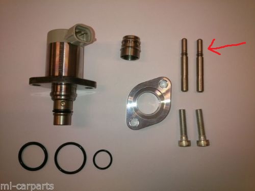

Hi new to this forum but been reading this post closely and hoping my newly purchased SCV will sort out my cold start problem on 2.0d4d auris 2007. Ive got a new SCV and kit from a company called PF Jones Diesel specialists. Everything in the kit looks OK but I am wondering what the screws/bolts are for which are highlighted with the red arrow?
Also, to anyone who has fitted one of these, does the supplied nipple/adaptor/collar just push over the new modified SCV before fitting?
Cheers

post-147777-0-54429700-1429780842_thumb.
The pins are guide pins used to align the SCV as it is inserted into the Pump.
Make sure everything is spotlessly clean before removing the old valve and during replacement of the new valve any dirt entering can cause serious issues. Also the large O-ring groove on the spacer faces the SCV not the pump. Once the valve is in remove the guide pins and insert the bolts 1 by 1 and tighten the bolts down evenly to avoid shifting the valve, torque the bolts to 10.8nm.
Once the new valve is fitted ensure to book into your local Toyota dealer as the new valve will end up like the old one without updated engine ECU software, your car needs a minimum software version of 302V0000 which improves the control logic of the valve and increases the cold cranking fuel pressure to improve the cold start.

Have a look on the side of the ecu. Mine had an "official modification" sticker and the new revision number. Unfortunately the cheap dealer hadn't changed the valve, or invested in a marker pen. The biro was barely legible.

From my experience, the car will still have the same problem when starting up. Its not until you get the software update, that the fuel pressure on startup in increased. Do not wait too long to get the software update. I had to force the dealer to give me the update.
