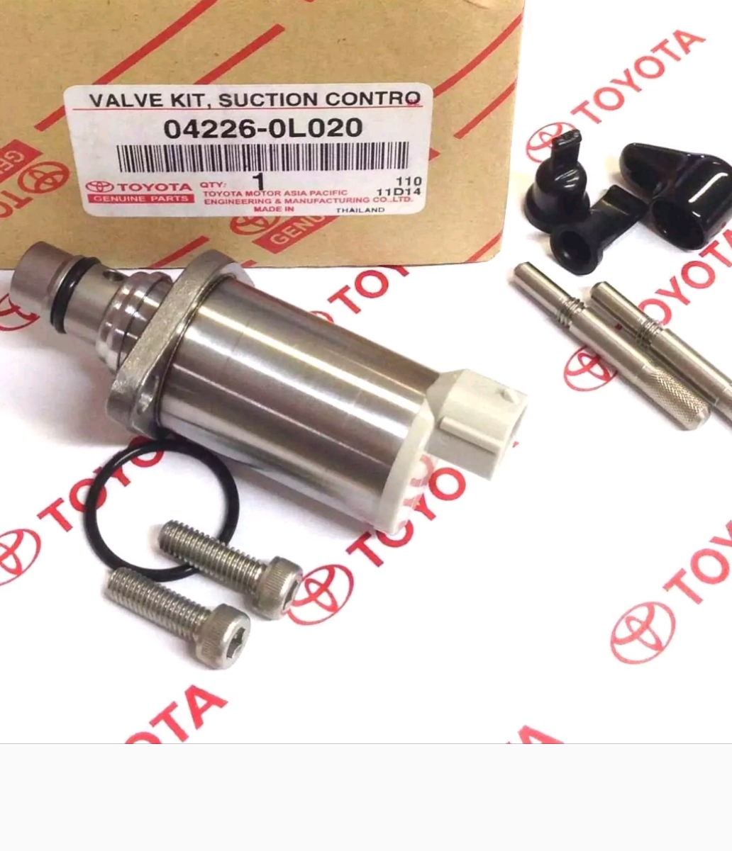

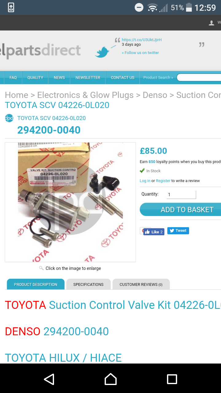

Hi. Can someone confirm if the photo is the correct valve for my Auris 2007 2.0? Thank youScreenshot_20180202-184406.thumb.jpg.86bb74231253ae02b7ee2883124721ed.jpg
