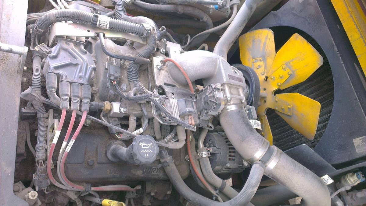

Ill take a pic of a fly by wite throttle body on one of our forklifts later today

below hopefully the pic i promised
post-129607-0-74085300-1363360160_thumb.
Thanks for the replies. Robster in not sure what I'm looking at in that photo? I'm not experienced with engines and can just about work my way around the easier to remove parts. So am I right in thinking all I have to do is remove the fuse to the fuel pump, all the sparks and screw in the pressure gauge? I can get a mate to key the ignition while I read the gauge.
