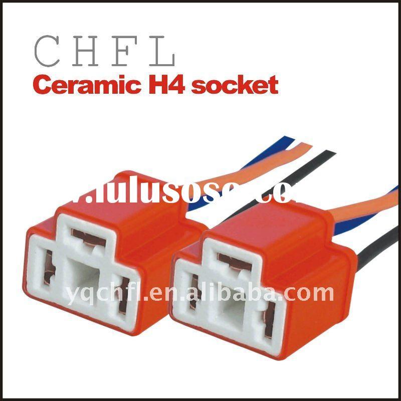

Why can't you just align/orientate the two plugs (new and old) in the same way, side by side and just cut off the old plug wires and reconnect those wires from the old plug to the corresponding wires in the new plug. Just ignore the colours.There are just three wires and it can not be that difficult. Here is a picture of two H4 connectors that are aligned the same way side by side. Just ignore the colour of the wires. You will have to find a suitable way of connecting the two wire ends together. It is called splicing of car wires (search for that in google). Here are two pictures to help you. Halfords has lots of wire splicing bits and pieces. There are different kinds. Water proof ones are the best.
