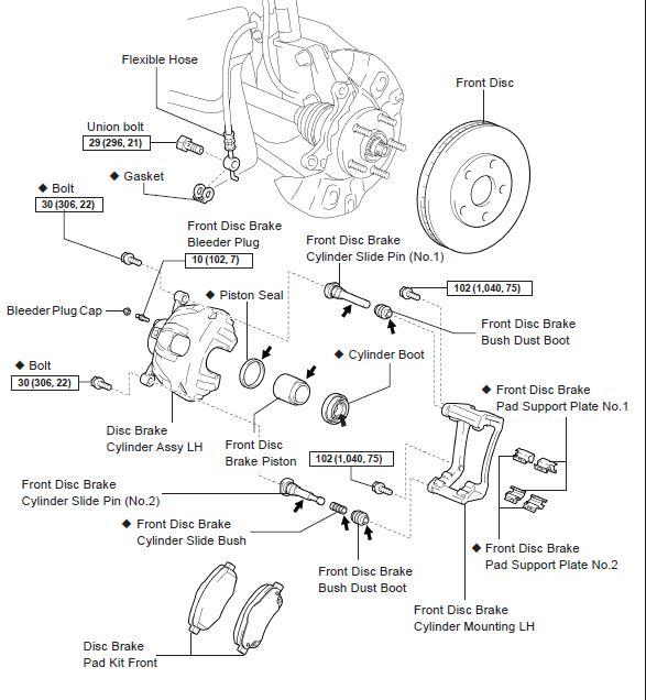

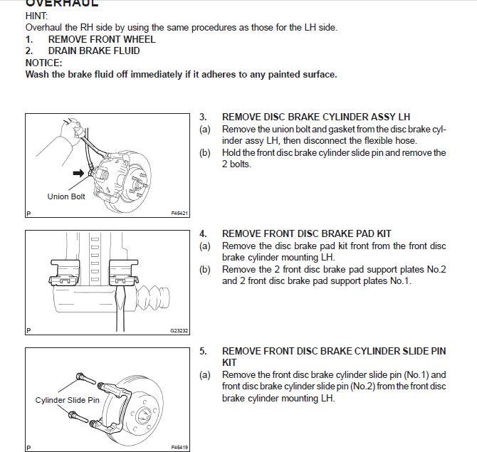

I removed my from brake calipers etc. to service them and got distracted by a fall of snow!
I cannot remember how the pad support clips go back into the pad support frame!
Anyone have a photo or help me out?
Cheers,
Gary
Hello Gary,
here are a couple of pictures from the later model but should be similar just click on each picture to enlarge them.
Regards Pete.
