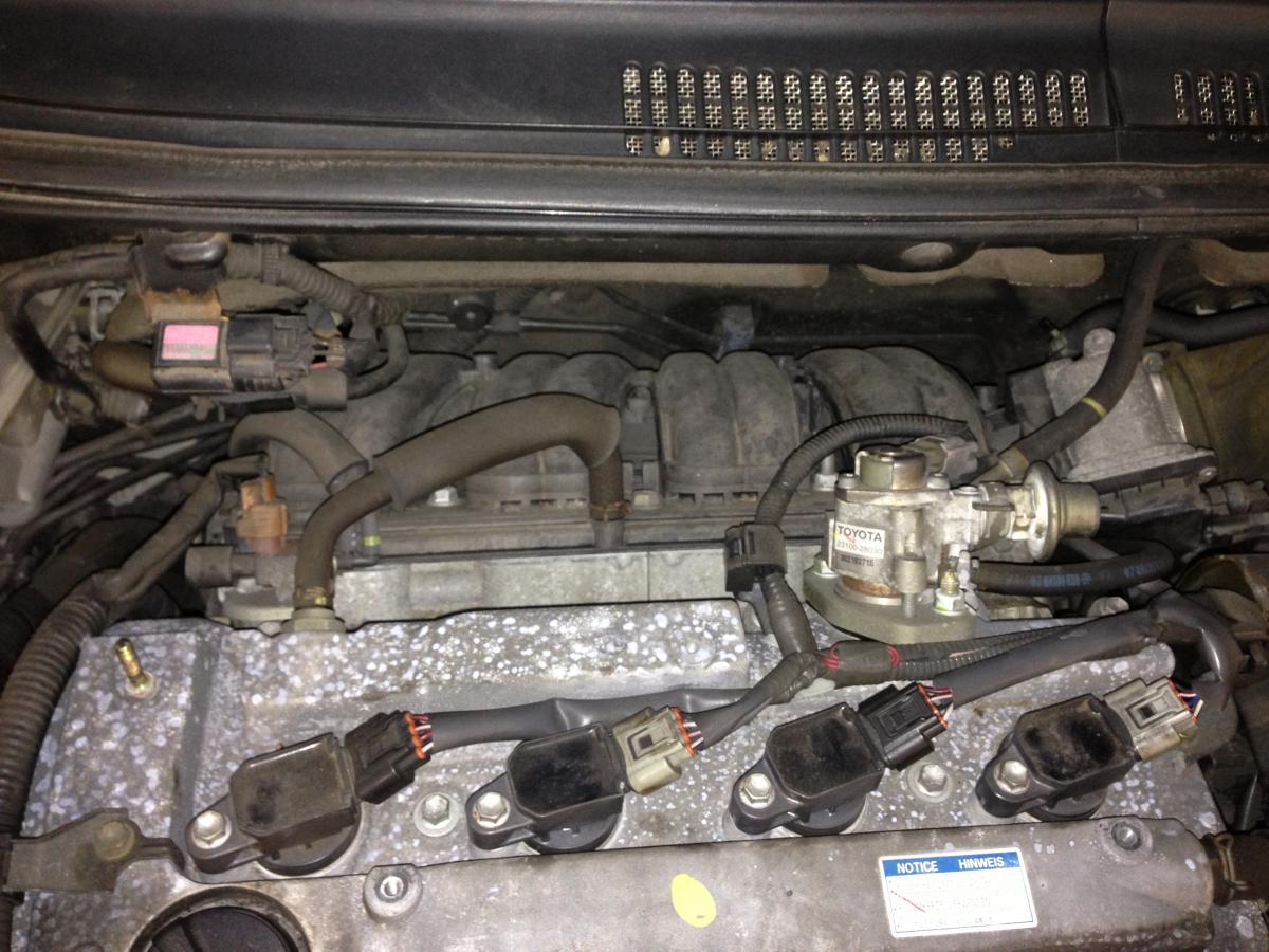

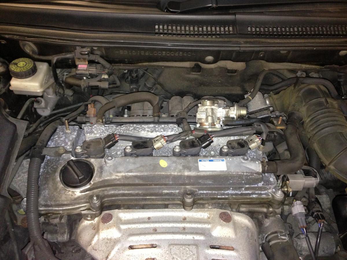

Frankie my engine is quite different to that. I have posted a few photos of mine with the engine cover off. Any ideas which pipe leads to the pcv and also the idle control valve?
Really appreciate your help with all this mate.
post-129758-0-93064800-1366543612_thumb.
post-129758-0-92575200-1366543745_thumb.
Ok update, found the pcv valve. Checked the hose and it was clean, took the valve out and gave it a shake and I could hear a clear rattle. I still used some carb cleaner and have reinstalled it. Will have to wait until tomorrow morning to see if it has made any difference.
Mo
ya found the pcv ok then mo?.the idle control is on the throttle body along with the throttle position sensor.clean throttle body too mo..sorry for late reply.
Frankie no need to apologise mate I am thankful for your help and advice. I will try the throttle body tomorrow. Is it difficult to remove? Or is it best to clean it while still fitted?
Mo
not too sure if its easy to get at on your 2.0 vvti. mines was easy four bolts and two clips for electrics for sensors undid them cleaned the TB front and back and the port for the idle control.shouldnt be too hard mate.it might idle high for a bit (other posts on this) mine did the same but i cleared the throttle position sensor on it too and think this reset done it back to 700RPM..key in engine off turn key but dont start count till 10sec turn off do this 3 times should work.
