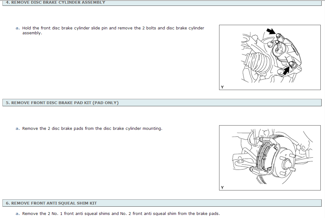

The brake pads look dead easy, two bolts on the rear of the calliper and the calliper comes apart revealing the pads. You may only need to remove one bolt and simply pivot the calliper around the other one like a hinge to get the pads out.
The rear brakes look much the same but watch out for the handbrake cable, don't want to bend that too much.

post-116364-0-95793800-1366744383_thumb.
