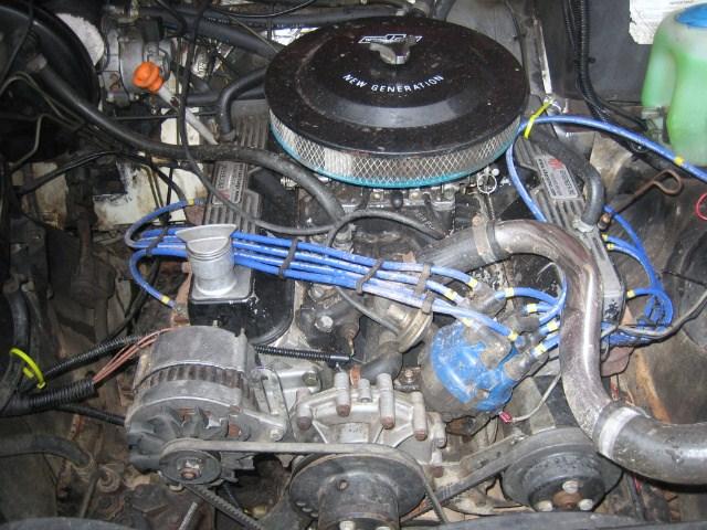

I used to run a Land Rover for towing & with just LPG and no other fuel i did not need a Tachograph.
(So no petrol carried for starting, just set up for on LPG)
The LPG tanks in that gave a 700 mile range and i could often fill up cheap in Scotland get south and maybe only need to do an expensive top up if really needed, then back north. (Morrisons was often good for cheaper LPG in the South.)

post-104736-0-13933500-1368553566_thumb.
Did you have any petrol on board or just gas?
Only ask as I had a fuel pump relay fail on my first Range Rover so the fuel pump wasn't priming the system to start the engine on petrol. My system always started on petrol then changed to gas after.
No problem I thought, I'll start it on gas so I pressed the override button and started cranking away. A few seconds later the bonnet seemed to rise slightly followed by a huge bang but the engine did start. Looked under the bonnet and the plastic air filter housing was laying in bits all over the engine bay. :ermm:
Can only assume the gas found it's way back down the intake pipe and ignited in the air filter! It did start though and drove happily back home where I replaced the £4 relay and the £50 air filter housing!
Craig.
