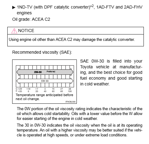

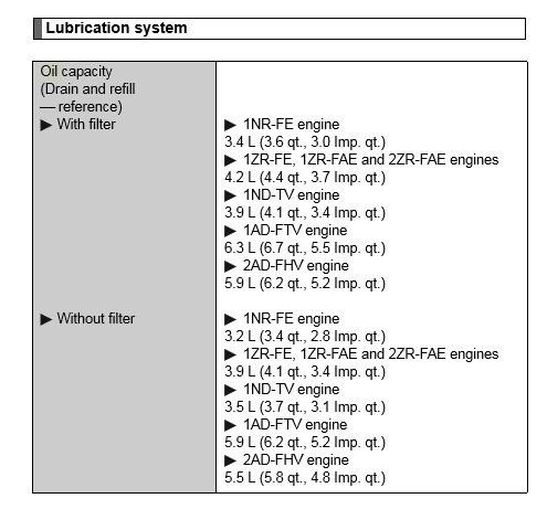

Your engine should be 1AD-FTV. According to owners manual, it takes 6.3L when you replace the filter, or 5.9 if you do oil service without replacing the filter.
You can buy any oil with  grade ACEA C2, preferably 0W30, or 5W30, check the compatibility chart below.
