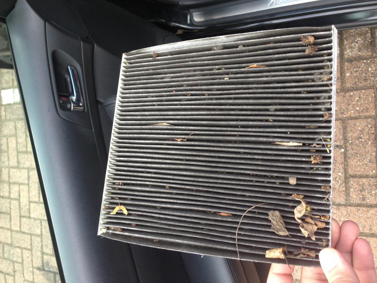

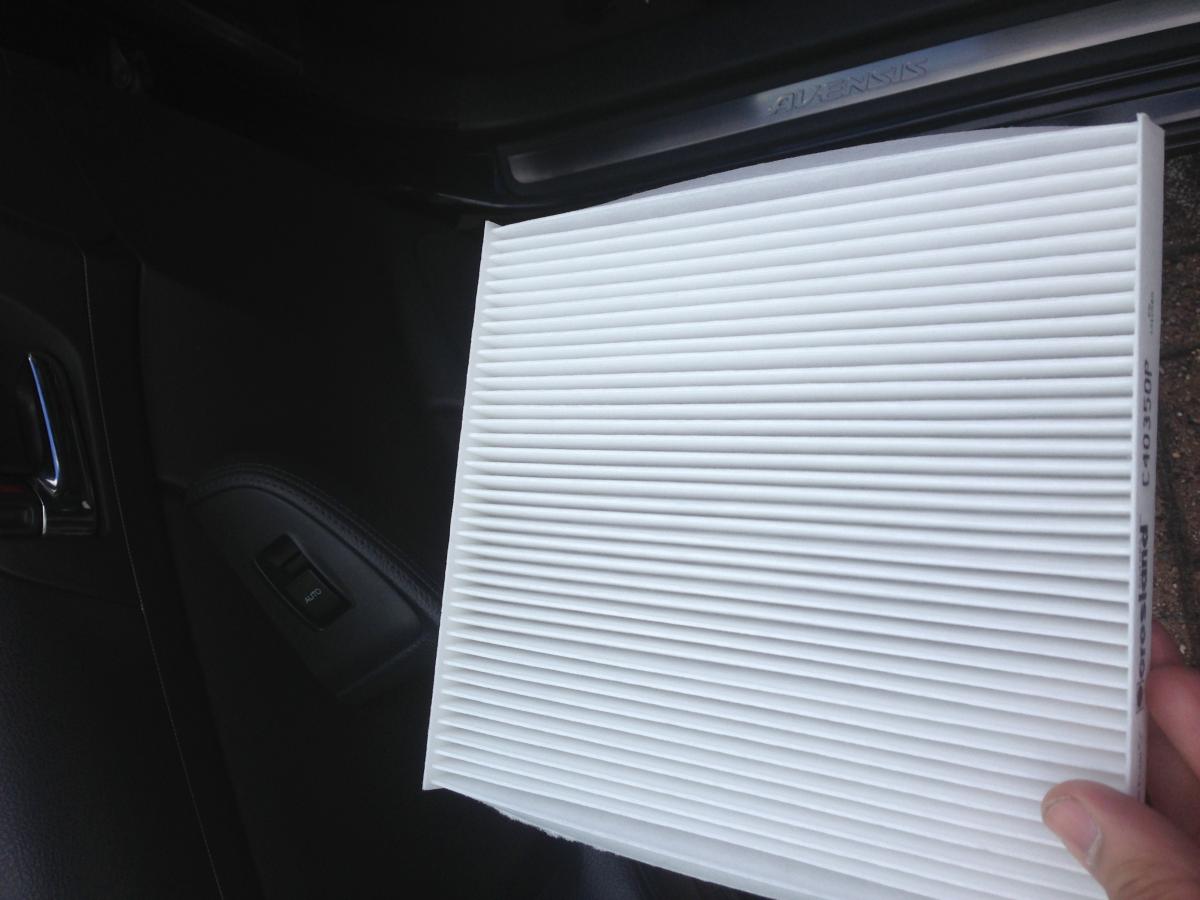

I would get a nasty smell in the car every now and again so I decided to change the pollen filter. I couldn't believe how dirty the one I removed was. How often should these usually be replaced? I have posted photos of the old and new filter.

Inspect at the Intermediate service (12 months/10,000 miles). Replace at the Full service (24 months/20,000 miles). Supposed to be cleanable using compressed air blowing through the filter from the downward side - not sure I'd want to do that.
Wow that really is bad, how on earth did peanuts end up there? Lol
