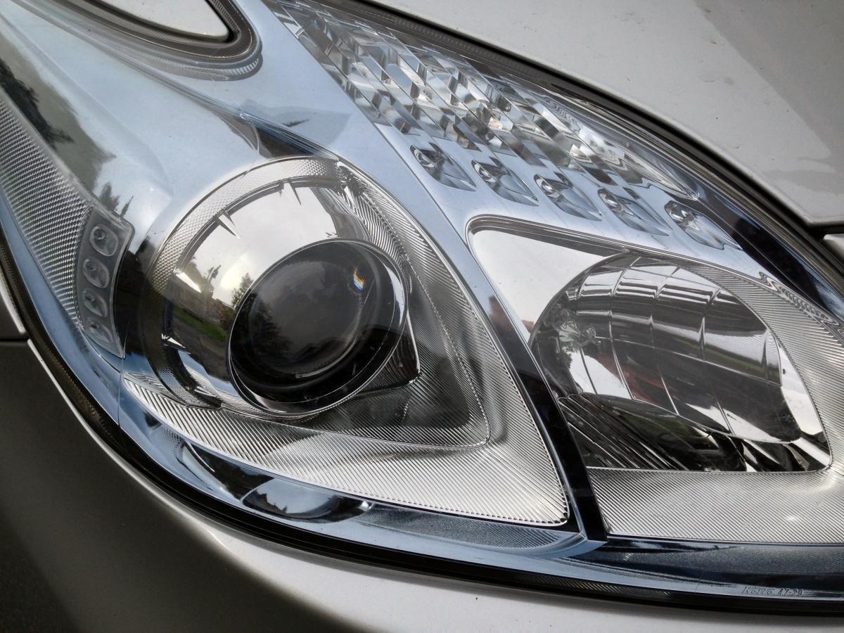

Hi,
1st of all please look at pic attached
I can turn on the side lights, dipped & main beam lights but,
the 5 led's horizontally & the 4 led's vertically at the side I cannot work out a) what they do b) how to turn them on or off
Anybody any ideas as they never seem to illuminate?
They don't appear to be daytime running lights or side lights
Thanx

On that model I am sure that they are fake. It would be speculation as to why they are fake, but I think it is relevant to point out that Toyota did not appear to be pro-active in updating their flag ship Hybrid model (i.e. Prius) with Day-time Running Lights.

The Gen 3 has been through a mid-life update now, it did not have DRL (Daytime Running Lights) when it was introduced in 2009, because Toyota managed to get the car approved for sale within the EU before the deadline that mandated that new cars must be equipped with DRL. They continued to sell new Prius cars after the deadline without DRL, quite legally, but I recall complaints as it did catch out some new owners who didn't understand the technicalities of how the rules would apply.

Because it is a legal requirement that they go OFF when the headlamps are ON. They are too bright for use at night, therefore they go OFF when the headlamps are turned on

Yes thats correct, they can reduce to a sidelight power, but they cannot stay the same brightness when the headlights go on, it would make them too bright at night
Some also dim when the flashers go on, particularly if the DRL is near to the flasher lamp, both scenarios are catered for in the regulations

The brighter ones you've seen with headlamps on may be aftermarket ones simply wired to the parking light circuit.
