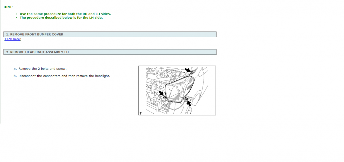

Need to remove the headlights on my IQ. The only info I can find mentions removal of the front panel. I have managed to remove two bolts and a plastic plug butstill cannot remove- seems to be another attachment somewhere.
There is indeed a lower bolt on the headlight unit only accessible once the front bumper is removed.
To get the bumper off is quite easy really and can be done in ten minutes.
You remove the two little black flaps in front of the wheels, 2 bolts each side. You then remove the row of bolts along the underside of the bumper, 4 in total then remove the 5 plastic plugs along the top of the bumper. Give it a pull carefully at the wing joint and it will pop off as a single huge bit of plastic. Unplug the fog lights as you remove if you have them.

post-116364-0-58227600-1383213250_thumb.
