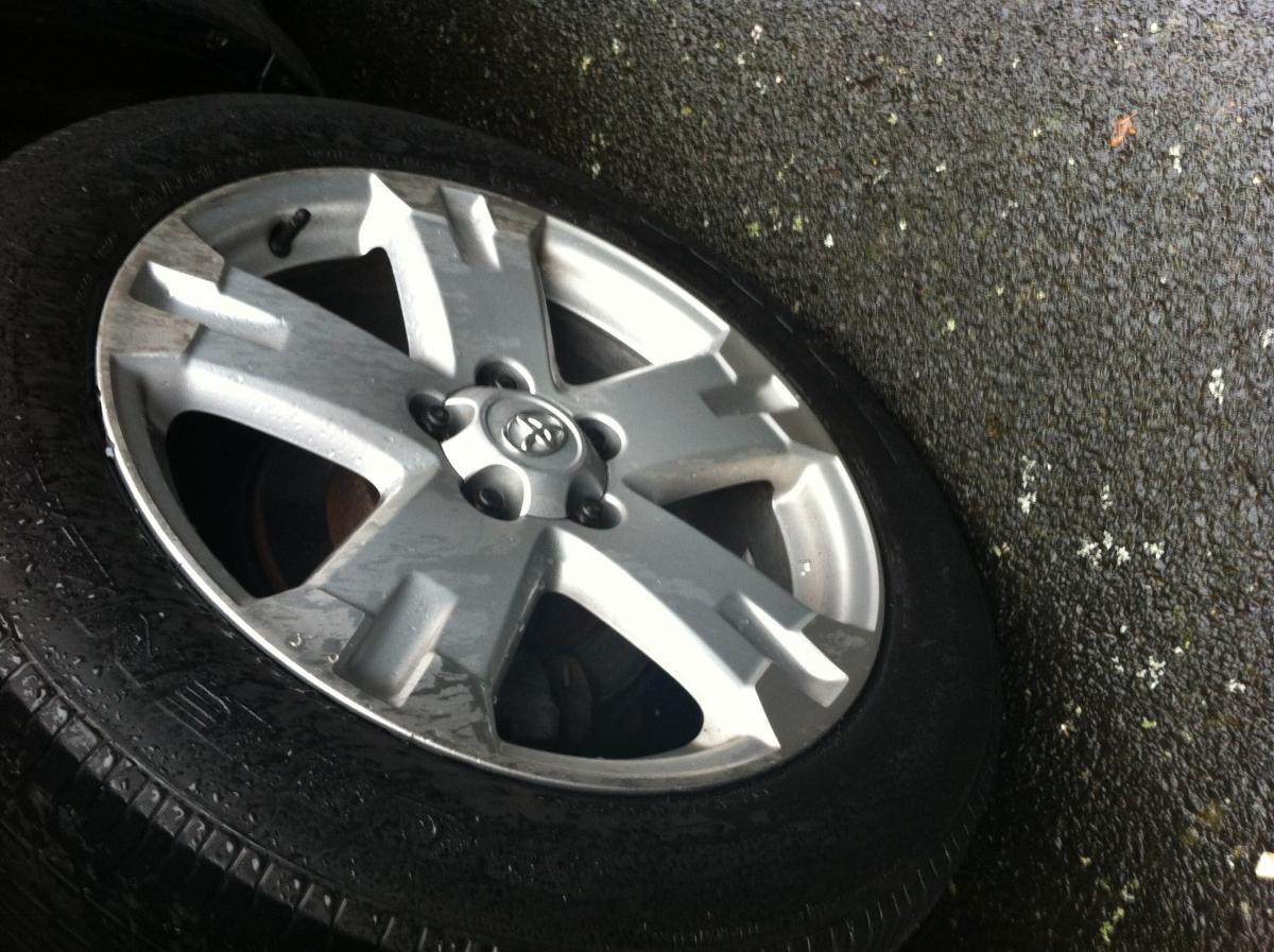

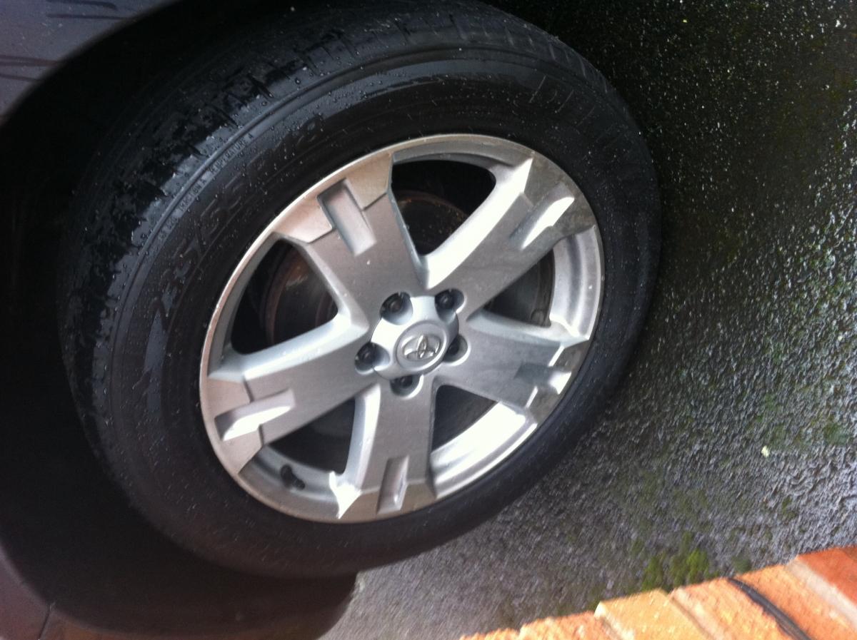

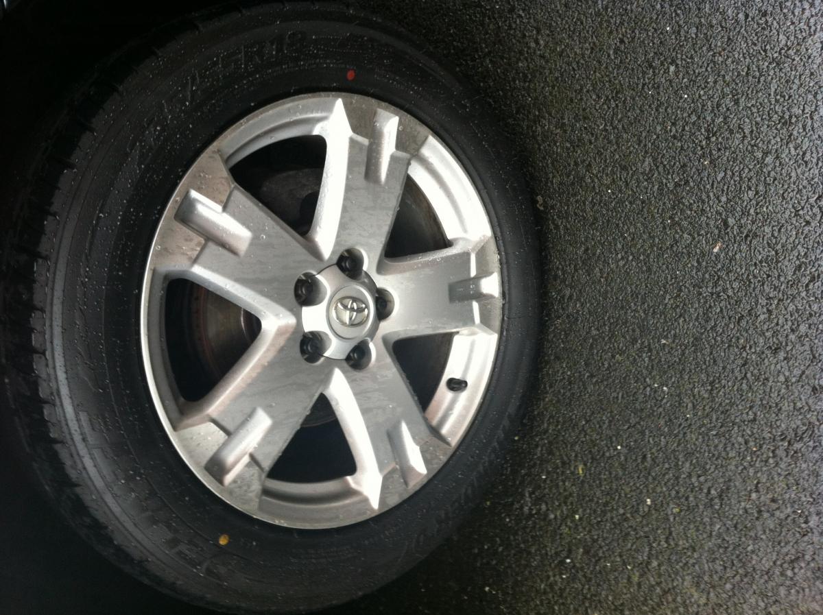

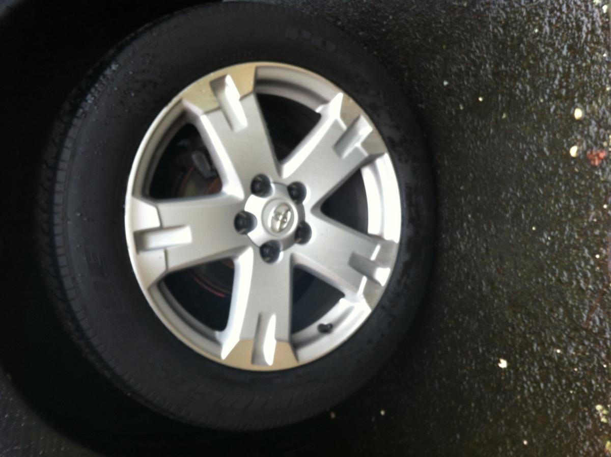

Here are photos if wheels & tyres.
1st = passenger rear
2nd = driver rear
3rd = passenger front
4th = driver front

Those are the correct wheel pattern for the car Mat :thumbsup:

From the picture above, all four wheels appear to have normal valves - the Toyota TPMS ones have a metallic stem rather than rubber as shown. That would explain why the TPMS warning light is 'on' - it believes that there is no pressure in any of the tyres!
The rims themselves look to be the standard 18" rims for a T180 / SR180 so they should fit the hub correctly (bar previous damage etc.). I'd have expected to see silver coloured studs (rather than black) and one locking wheel stud on each wheel (as I had on my SR180) though what you have could have been standard at that time.
So:
  • There's nothing obviously wrong with your rims or tyres - though you probably want 'better' rubber when it's time for a change.
  • There's nothing much a standard tyre depot can do about the TPMS situation. Your choices are to go to Mr T to get the TPMS valves reinstated (new valves plus coding into the ECU), 'cut' the 'pink wire' or put up with the warning light.
Neither of which has any obvious bearing on the problem you originally reported ...
