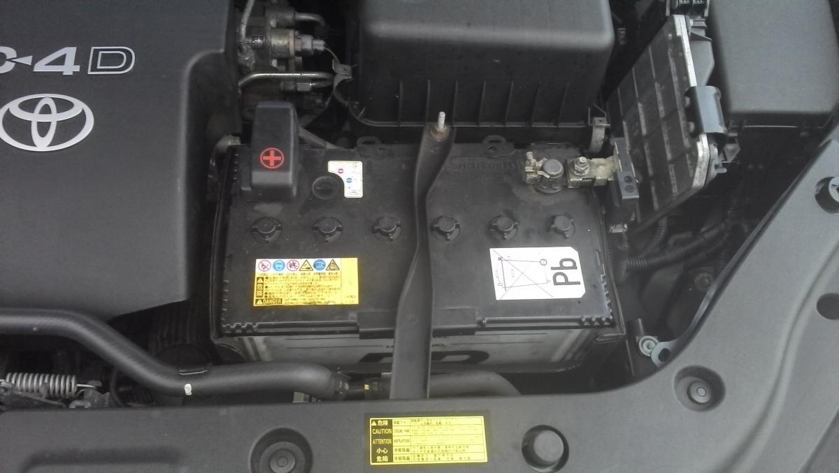

Thanks for clearing that up, I thought I was going mad. The Battery on the Rav seems to have the termianls offset quite significantly to the back; if you 'flipped' the Battery, the terminals would be too far forward for the harness to reach (certainly the postive looking at it). It certainly caused problems for the chap in the past, and there does appear to be two types of Battery, so I don't know if it changed at some point.
I've posted a pic, curious if anyone elses is the same or differs.

I know in the past the Halfords website was suggesting the wrong Battery for the petrol model as it had the terminals reversed with respect to the diesel model.
I know in the past the Halfords website was suggesting the wrong battery for the petrol model as it had the terminals reversed with respect to the diesel model.
That'd be it then, although one would assume by supplying the reg of the vehicle, that they'd be a little more certain it was the correct orientation!
Some batteries can be flipped around to fit. The original post was in respect of an early 4.2 petrol where the Battery is at the back of the engine bay - unlike the 4.3. The 4.3 diesel Battery, in particular, is quite a tight fit and I wouldn't suggest trying to fit a Battery with the terminals to the front. As standard on the early 4.2 - the terminals are at the front of the battery - but it's just as easy to fit a battery with terminals to the rear. Similarily the 4.1 has a battery mounted adjacent to the bulkhead and a battery with front or rear terminals can be fitted.
Thanks for clearing that up, I know on other motors in the past the terminals were central along the length, making it easy to flip; the 4.3 was, is, the first car I'v ehad where that's been an issue. Youi're corect in assuming it wouldn't stretch on the 4.3 (diesel at least) it is a snug fit and I guess that's why the chap had returns in the past
Make sure they're supplying you the correct Battery. I recently had mine changed and found out that the book that a lot of people use has an incorrect Battery listed. The garage supplied me a Battery that was 70AH and 570 CCA, whereas the 2.2 Diesel Rav4 needs 80AH and 800CCA (info thanks to kingo in a previous thread).
I ended up buying this one off eBay from eurocarparts (a lot cheaper here than in their store and with free delivery) for my 2007 XTR 2.2 D4D: http://www.ebay.co.uk/itm/Bosch-S4-Car-Battery-Type-335-336-With-4-Year-Manufacturers-Warranty-/330855767034?_trksid=p2054897.l4275
The above is an example of a Battery (Bosch 335) with the positive pole normally front right but can be rotated through 180 degrees in order to fit the 4.3 diesel which requires the positive rear left.
