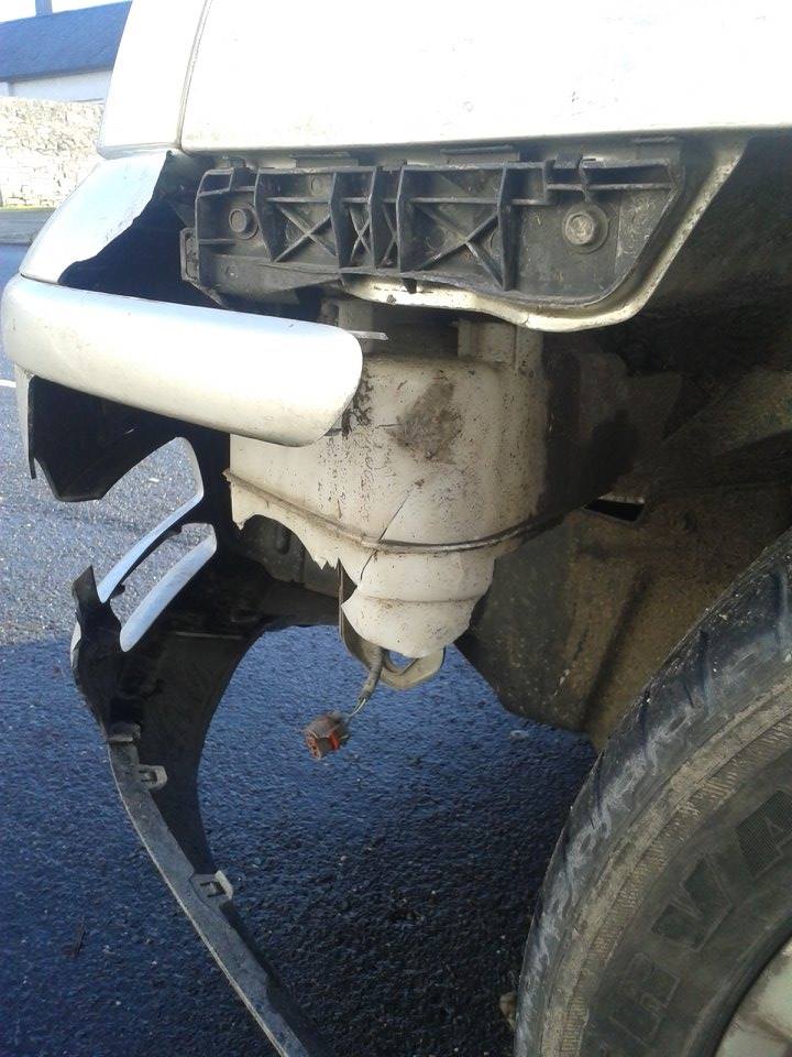

hi all,newbie here,had an accident with a dog and the dog won.....anybody know what the broken part behind the bumper.....went to 2 dismantlers and their not on those cars..... washer bottle is on drivers side, was/is attached to the air pipe going to air filter...........post-137413-0-36506400-1390399484_thumb.

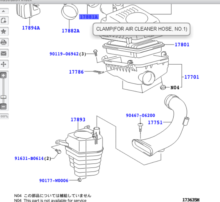

Looking at the picture it appears to be the "Air intake resonator" it is used to quieten the intake noise on the engine. I have attached a picture from the Toyota parts catalogue, part 17893
post-45863-0-96577300-1390423941_thumb.p
